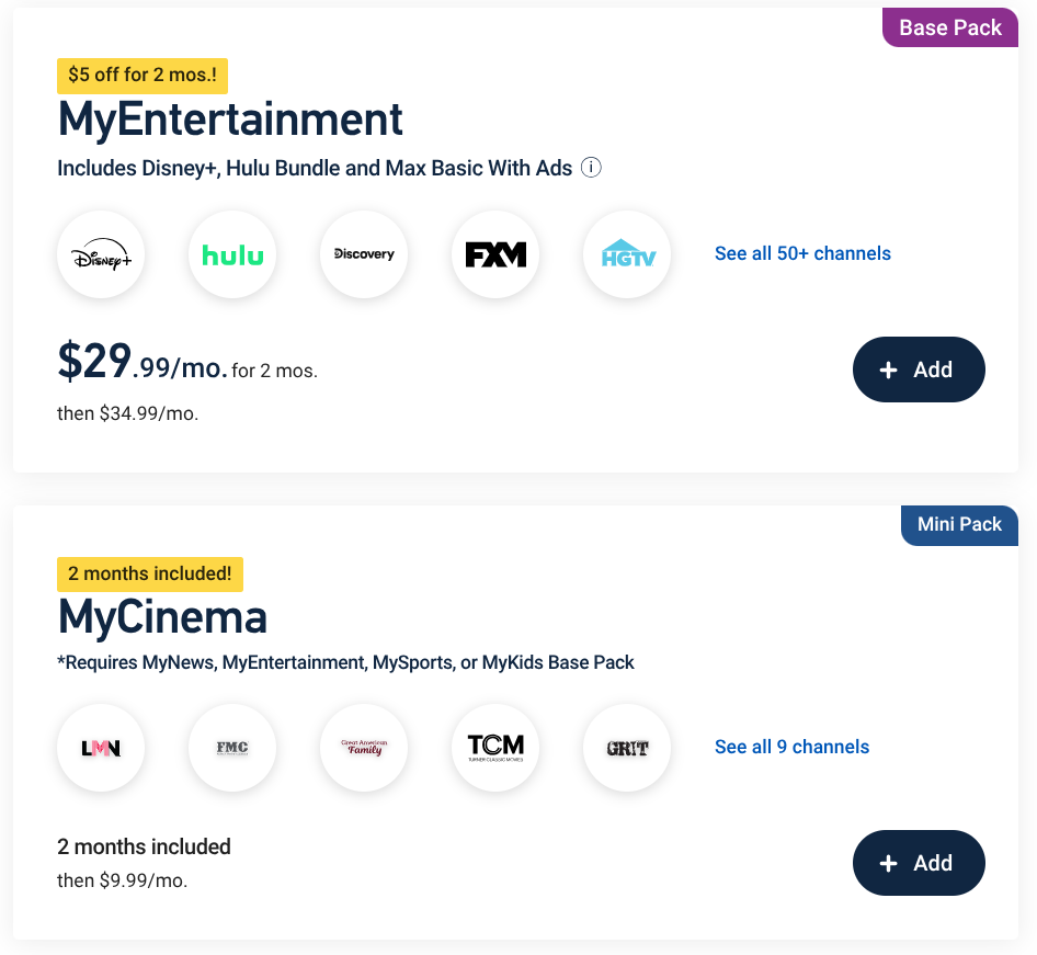

The channels I want/need are all within the "MyEntertainment" package, and the "MyCinema" addon. $45/mo as opposed to $83/mo with YTTV.

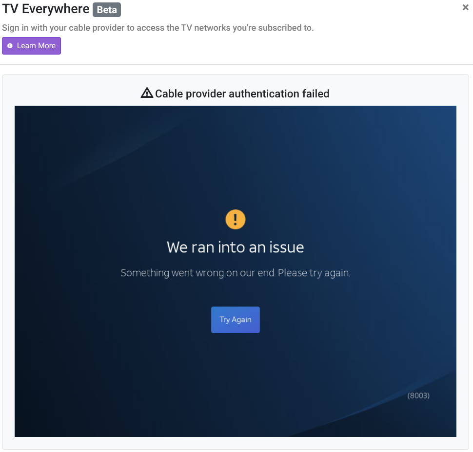

Aww, crud. That didn't work quite right. Do I need to do some special magic to add the DirecTV as a TVE source?
To that issue, I had problems logging into DTV last night. I think it's just their system being wonky as they prep the new Genre / ESPN Unlimited / Gemini specific bundles.
Gotcha. As the graphic says, "Please try again" I give it a shot later.
