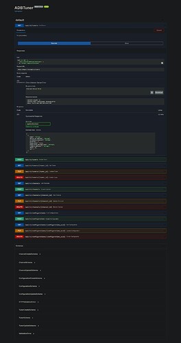

@bnhf A basic rest api was added for administrative functions. Swagger docs are available at /api/docs .
Be careful with this, there isn't a ton of validation in place outside of enforcing schema.
If anyone runs into any issues, please let me know. Thanks!

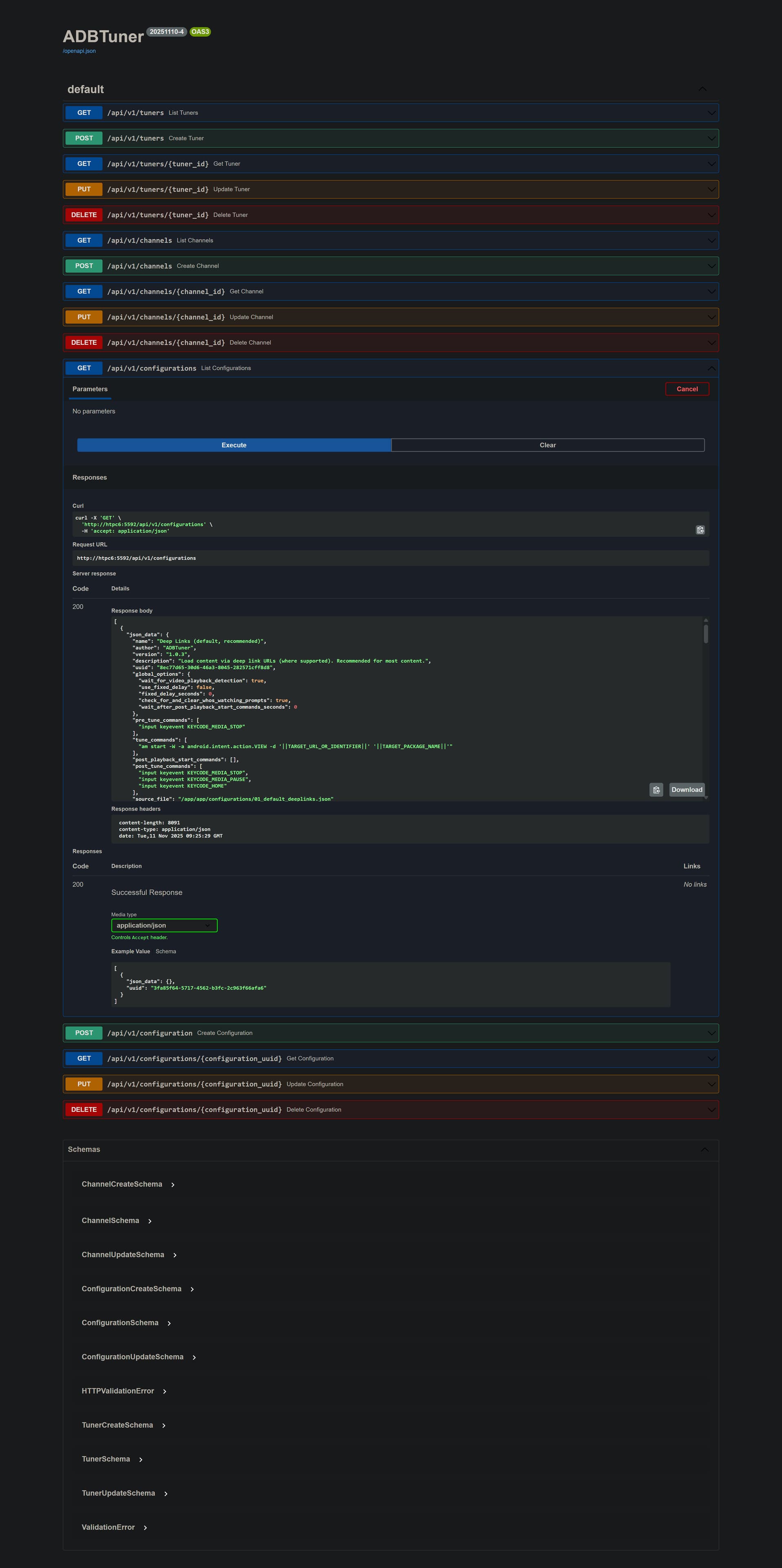

Looks like this is going to be great!

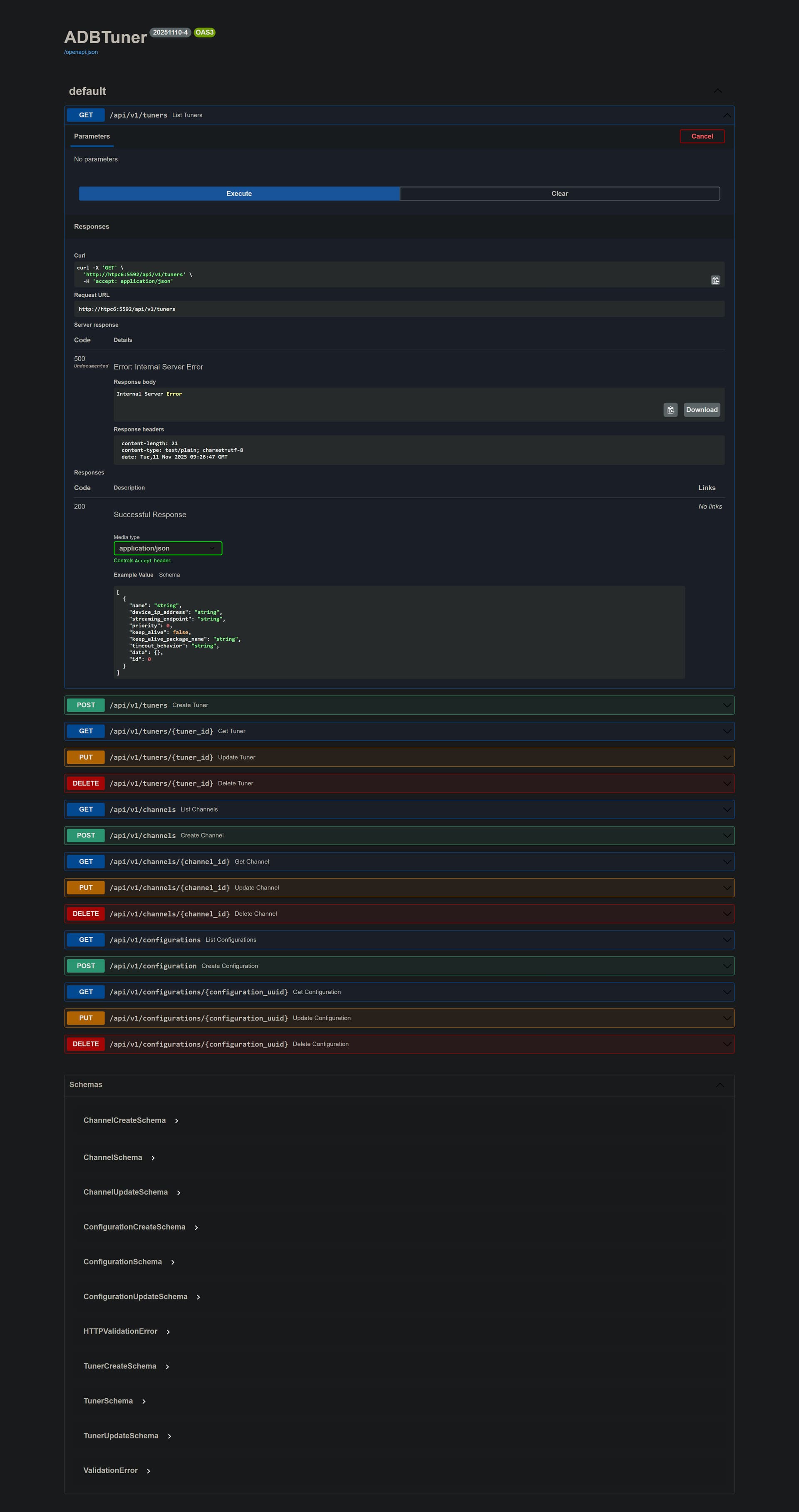

Listing configurations worked:
But, listing tuners and channels both failed with 500 errors:
