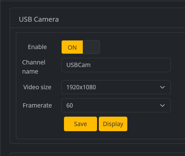

@bnhf thanks for suggesting the LinkPi, ENC1-V3. I ended up having so many issues with the URayCoder and Wilxisum encoders. Mainly audio sync problems. Also, the picture quality was honestly terrible.
I ended up getting two of the LinkPi's and the Elgato Cam Link 4K which looks fantastic (expensive but a really high quality USB capture card). I have another one of those coming for 4 total tuners. I know I overspent on those capture cards, but after dealing with the other encoders, I just wanted something that's going to work 100% of the time. I'm trying to remove any weak links in the chain and Elgato is high quality!
I really appreciate the suggestion and switching eliminated so many issues that were just days and days of troubleshooting! ADBTuner beta is working amazingly well also!
Congrats! I have many LinkPi devices, and they have all been great. Feel free to jump over to the LinkPi Thread with any questions.

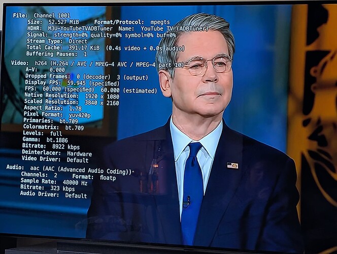

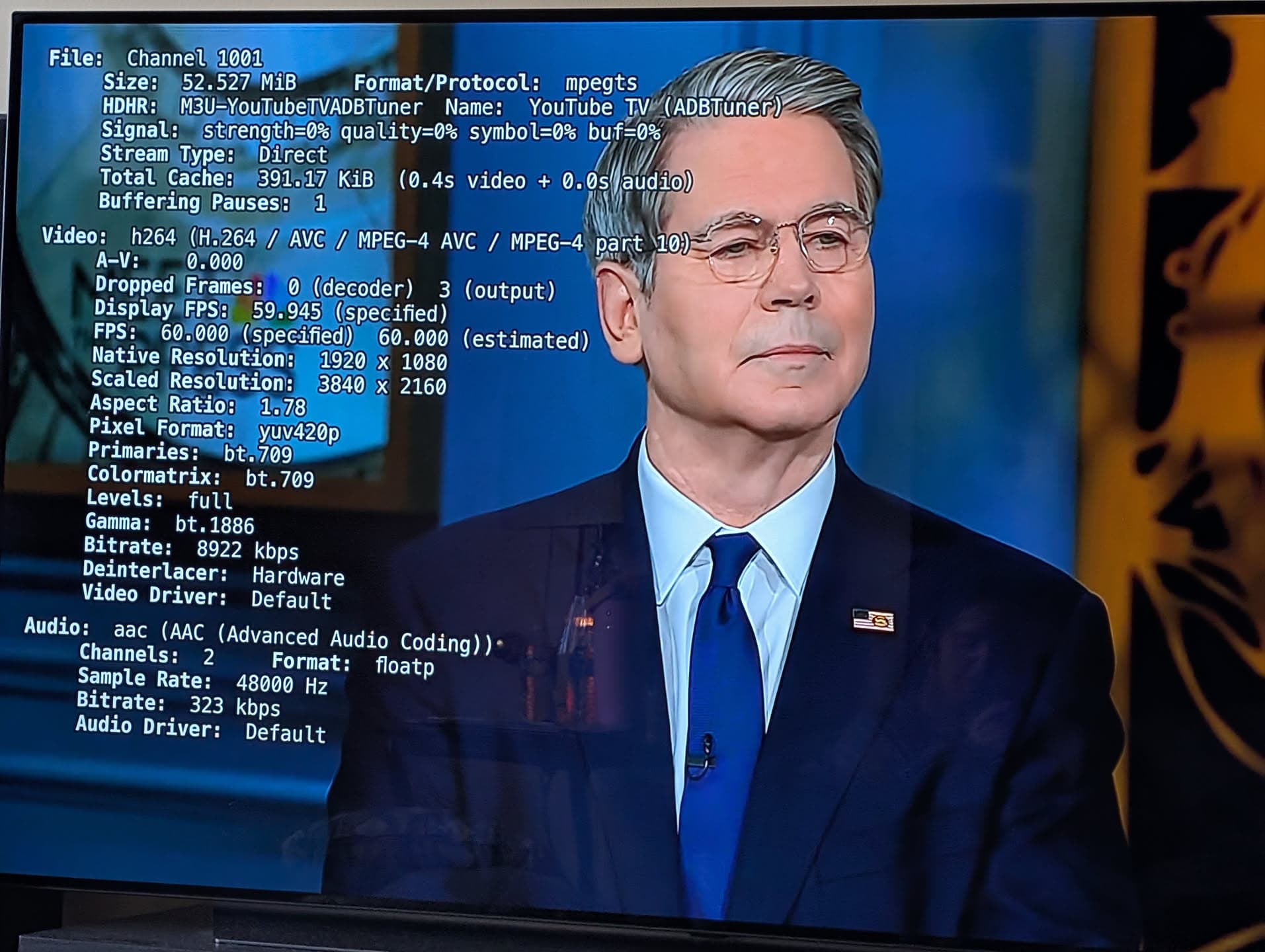

Follow up question. Are you getting full 1080P on the Elgato device? My testing with USB to HDMI on the ENC1v3 never allowed me to get 1080p60 due to the device being USB 2.0. Maybe there has a been a hardware revision? Thanks.
Yes! 1080p, 60fps! Also confirmed on my TV.
I'm puzzled how this works as the LinkPi documents the USB ports as USB 2.0 and the ElGato clearly states it requires USB 3.0 but great that it seems to be working for you.
This is coming off the Elgato.

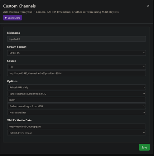

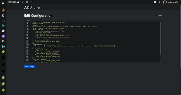

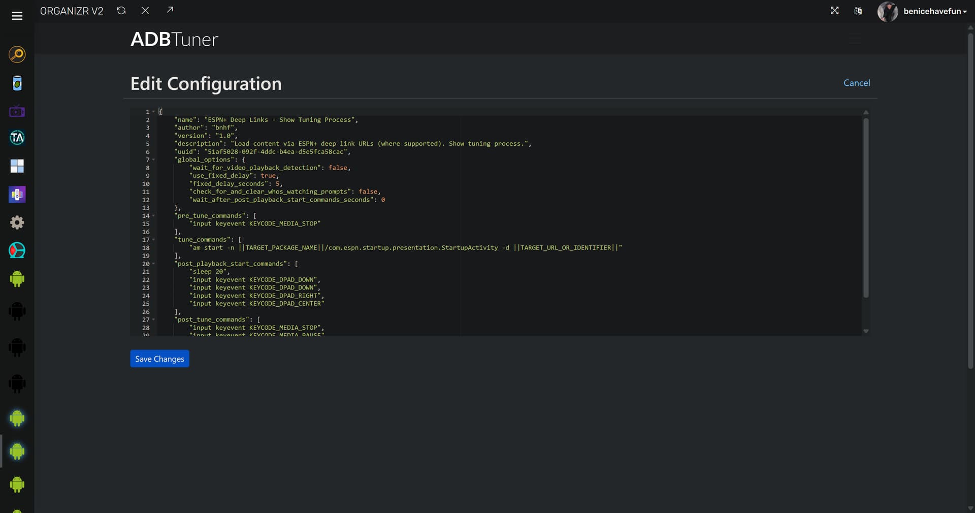

Automation comes to configuring ADBTuner for ESPN!
New bnhf/olivetin:latest (aka bnhf/olivetin:2025.11.23) pushed with support for both the ESPN4cc4c project (ESPN guide data including ESPN+) and a Project One-Click Action to automatically create however many unique virtual channels you'd like for those events (40, 100, 250 or whatever).
The One-Click will also add the ADBTuner Custom Configuration that goes with this (if its UUID is not already present), and will add the CDVR Custom Channels Source. If you don't already have ESPN4cc4c running, spin that up first, and then execute the ESPN4cc4c ADBTuner Action (no new container is created, but ESPN4cc4c and ADBTuner must be running):
ADBTuner Custom Configuration added automatically, if not already present:
ADBTuner virtual channels created (including deleting any previously created Provider=ESPN channels if desired). Each channels has a unique name and URL. Package names for both FireSticks and generic Android specified, along with the custom config:

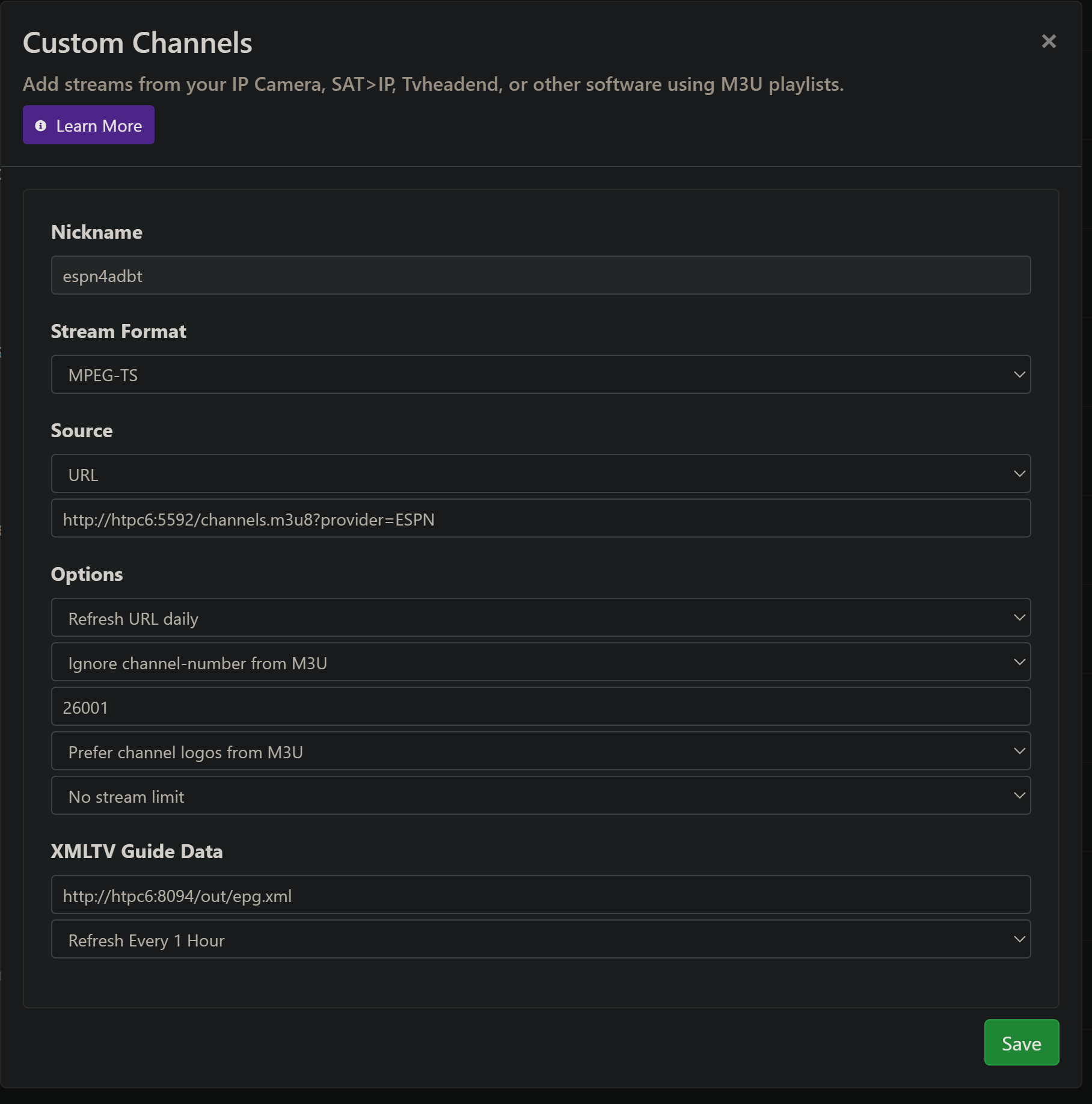

CDVR Custom Channels Source automatically created using ADBTuner M3U and ESPN4cc4c XML (guide data). Whatever channel start number you specify will be used -- and it's recommended to use one:
The result of your not-so-hard-work :slight_smile: :
