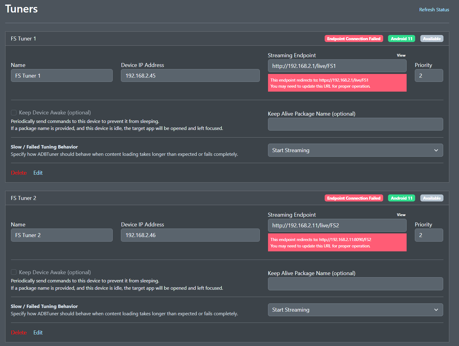

I recently upgraded to the latest stable release, and it seems like my endpoints are broken. I have encountered this issue with previous updates, but it's been a while, and rolling back usually resolved the problem. Unfortunately, this time rolling back doesn’t seem to help. Is anyone else experiencing this issue?
The URLs you have configured in the Streaming Endpoint field actually redirect to another URL. You should be able to just update the Streaming Endpoint field with the URL suggested in the error message. In your case it seems it's redirecting the https?

I attempted the suggested fix, and the URL changed to HTTPS as a result. The second tuner reflects the original message I received before trying the fix. I also double-checked my endpoint URLs on the encoder, and there have been no changes.

More information on this, I tried all iterations that error tells me to try and once I switch the URL I get a complete connection failure which would make sense. The endpoints the program is telling me to use are not real endpoints. Thanks
What encoding device(s) are you using?
Edit: if it's a single LinkPi device, can you try:
http://192.168.2.11:8090/FS1 and http://192.168.2.11:8090/FS2
I have 4 LinkPi Devices. They are all doing the same thing after this last update.... weird thing I spun up a new container since the suggested fix was not working I thought maybe I broke something. Intially this new container was doing the same thing. But I tried to add the fix that you stated along with the ADB tuner program suggesting and now its working all of a sudden. Not sure why thing change was needed all of a sudden and why in my orginal container the fix would not take. But it seems to be all good now I will try it on the rest of my tuners and let you know if I have any more trouble
Thanks for an awesome program!
There are some firmware updates that reset config. Possible your play URLs for the LinkPi streams changes. One of the firmware updates changed all my bitrate and encoding settings too. Something to check. Glad it is working.
