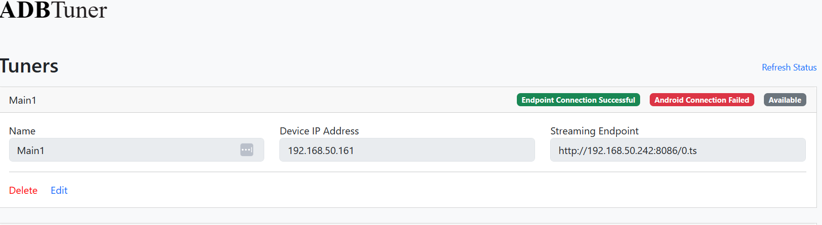

I seem to have a Problem ... this Command works and tunes the Channel but setting up adb tuner it does not work ..... Everything looks ok. Foor some reason the connection to android is failing ... but issuing the command it works great.
I am running docker on Windows alongside the Server.
adb -s 192.168.50.161 shell am start -n com.xfinity.cloudtvr.tenfoot/com.xfinity.common.view.LaunchActivity https://www.xfinity.com/stream/live/1920/5232923399725817105/HBOHW
I think you have blank space in that IP Address field. That's my bad, I should have stripped leading/trailing whitespace. I will do that next time I push an update.
There is no blank space ... I am going to revoke adb access and try to re-auth.

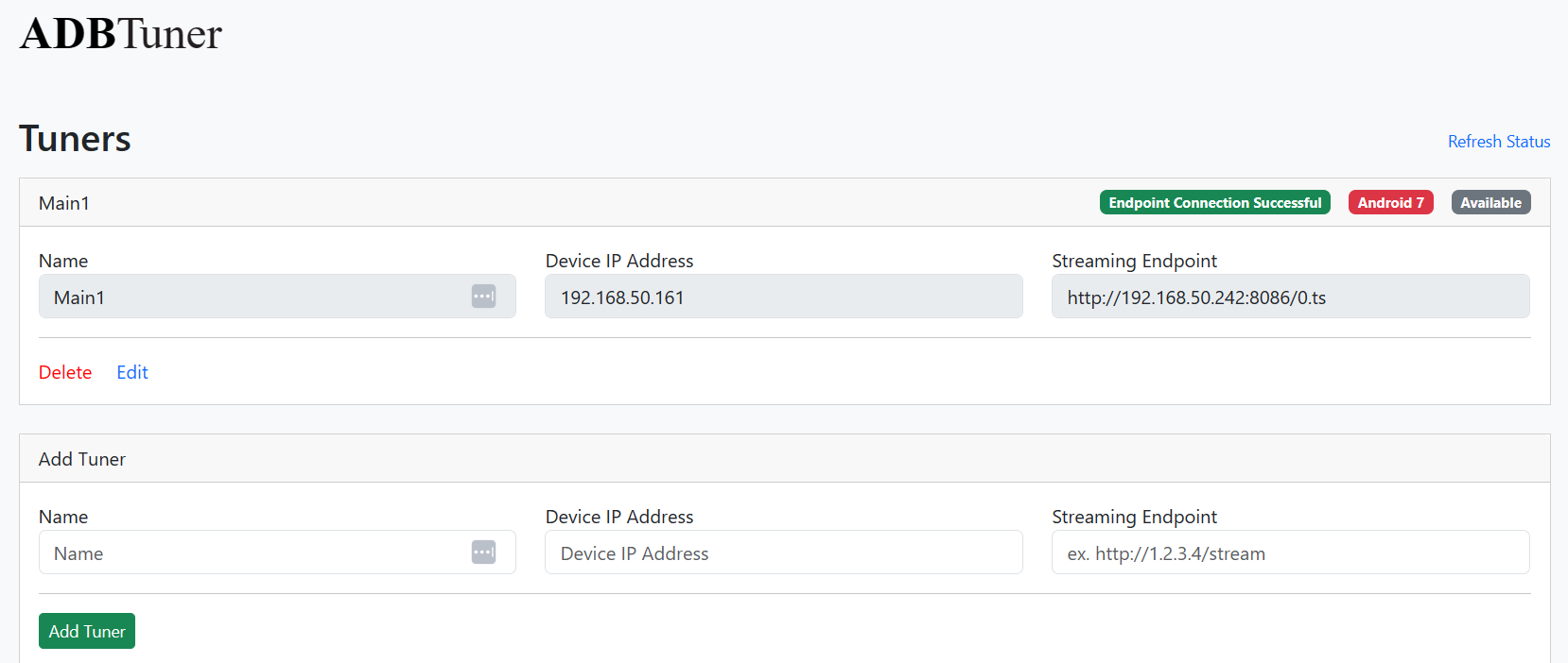

I think I know what my Problem might be I have my devices powered by a USB hub connected to my server and use USB debugging... I will get back to you as soon as I disconnect that Firestick from the hub and connect via powersupply.
Success have it connect by USB Debugging prevented it ..

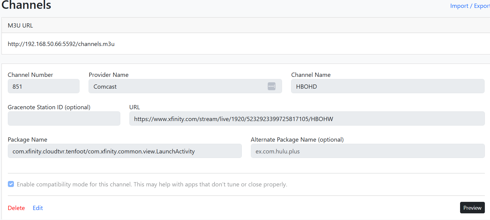

I haven't seen anyone use the Xfinity app yet. How well does it work?
Have you tried it without compatibility mode?
XFINITY Takes a While to load because of thier XFINITY logo but it works.... Without Compatibility enable it does not close.
They allow 5 Streams so I have 1 setup going to setup the other three.
Working Like A Charm .. Thanks
How were you able to find the URL for the Xfinity stream channels? Specifically this part :(/1920/5232923399725817105/HBOHW)
I bought up XFINITY on a webbrowser Click on the channel and It Gives you the link ... the 1920 is just a placeholder where the title would be...

Trying to finish getting this set up. Running it on a container in Unraid, static IP, custom bridge just link most all the rest of mine. I have an iSeevy HDMI encoder with a Tivo Stream 4K plugged in, and if i use the http://x.x.x.x/0.ts in VLC I can see the TS4K streamed image (x.x.x.x being the encoder IP).
In ADBTuner I added a tuner with name, x.x.x.x and http://x.x.x.x/0.ts entries. I have green Connection established, red Android Connection Failed, and gray Available bubbles in the tuner area after adding it. USB Debugging is enabled, but I never saw any sort of authorization prompt, either.
Any idea what else I need to do?
Make sure your device is not connected via ADB to another PC.
