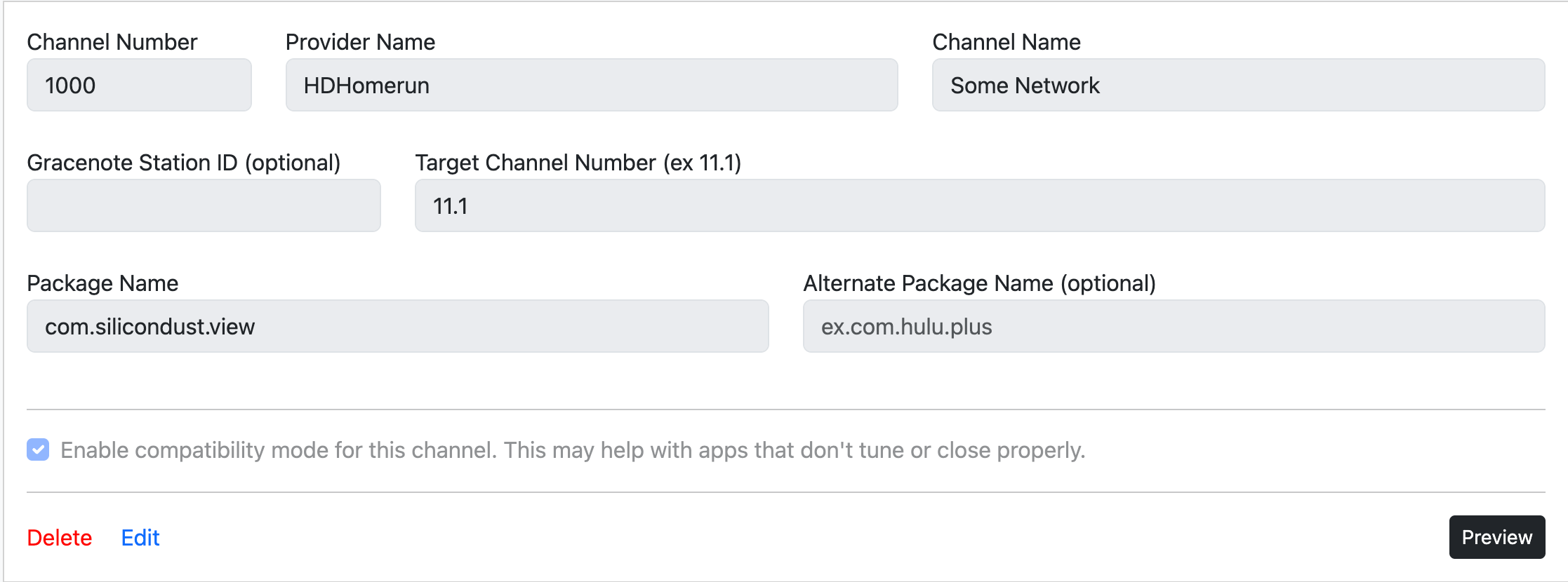

Ok, I got this working nicely with the NBC app. I thought that I could get the HDhomerun app to run the same way, so I tried it.
I used com.silicondust.view as the package name, and then for the URL I used http://172.16.5.31:5004/auto/v3 which is the channel on the HDhomerun device. I thought it would work, but it did not. It did open a view of the fireTV but on the main page, has anyone been able to open up the HDhomerun app through ADBTuner and switch the channel?

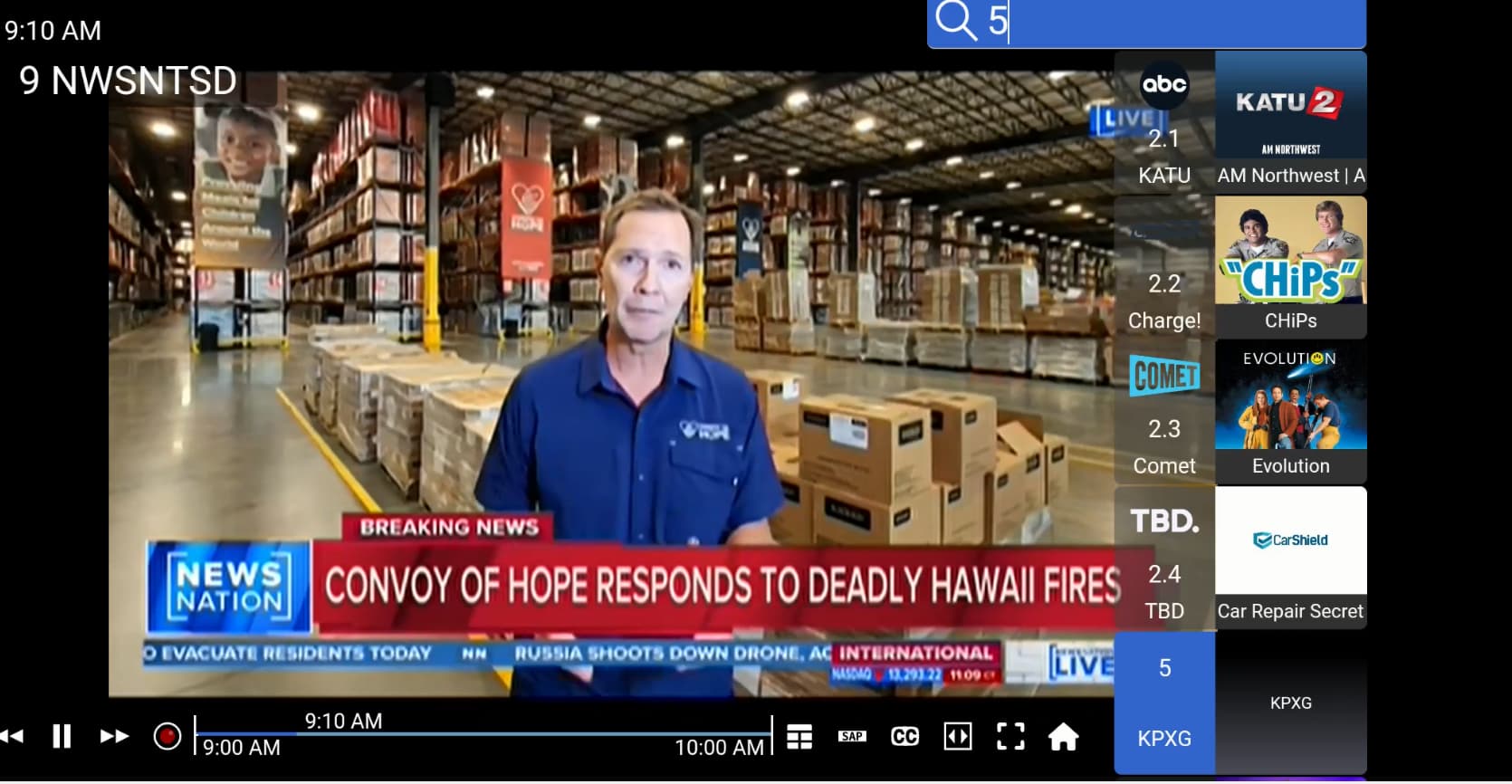

No you have to use ADB Commands to change Channels ...ADBTuner only launches URLS. I use NETPVR and the Script below .... This script works all it needs to be launched is the Channel #. This is the baseline now it is up to Channels DVR users to incorporate probably on HDMI to Channels.

@Gregg_K @Edwin_Perez
In hopes of actually being able to watch some of these OTA ATSC 3 channels in the near future, I included some experimental support for the HDHomeRun app in an update I pushed this morning (08/18).
If you want to give it a shot, install the update and enter the full channel number (ex. 11.1) in the URL field (the label will change to Channel Number if you select the HDHomeRun package).
Make sure you have the HDHomeRun app configured to open on the Live TV tab (this is the default).
Example config:

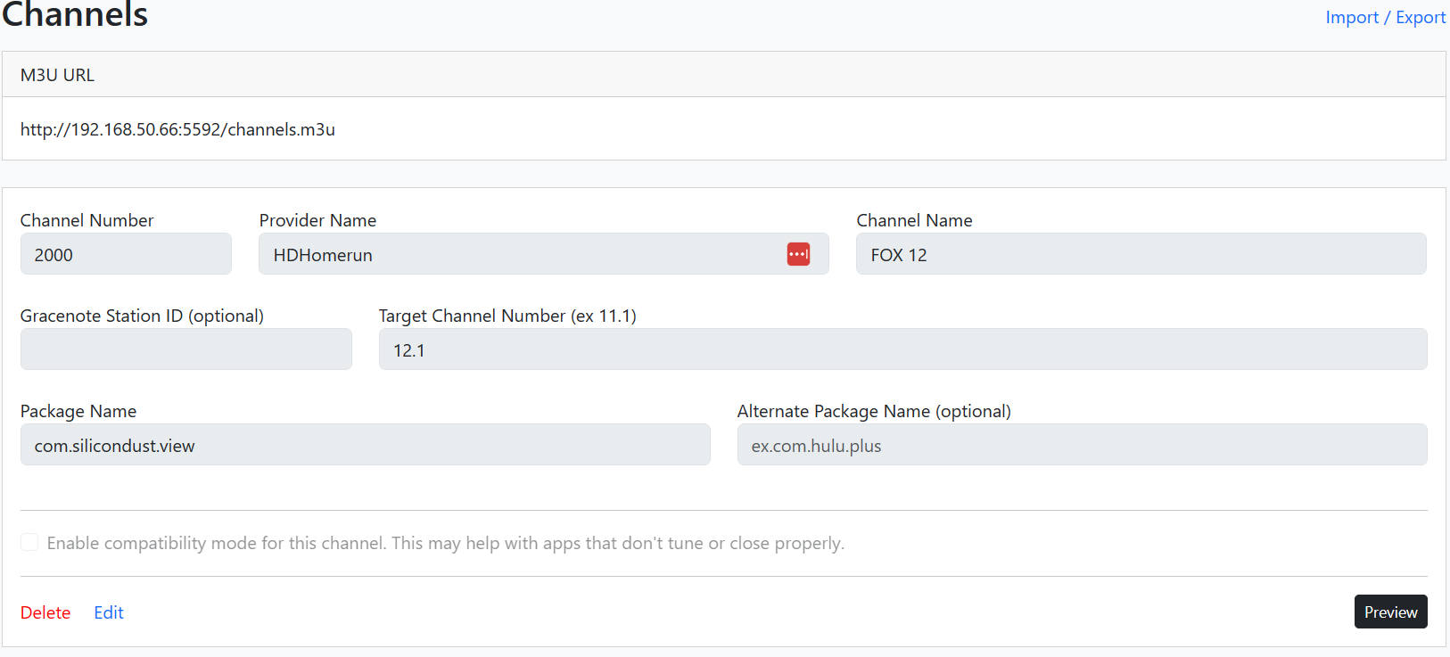

I will Gladly test it. This is wwhat I have setup so far ... added the M3U to Cannels DVR.
2023/08/18 07:54:19.986797 [ERR] Failed to start stream for ch2000: M3U: 404 Not Found
2023/08/18 07:54:20.044988 [HLS] Couldn't generate stream playlist for ch2000-dANY-ip192.168.50.186: M3U: 404 Not Found
2023/08/18 07:54:20.044988 [HLS] Stopping transcoder session ch2000-dANY-ip192.168.50.186
Where do I put The IP of the device to launch HDHR App on ?
Cool, I'll try it this afternoon.
Hmm.. It should use the Device IP Address for the "Tuner" at the top (Main4). Can you provide the docker logs?
I see HDHR is not Installed on that Device will Install it now sorry about that.

Thanks!
It looks like you need to install the HDHomeRun app.
Unless it has a different package name. I checked the Chromecast and Fire TV and they both used that name. Let me know if you have something different.
It works thanks a lot ...
I tested both my OTA Tuners and Cable Tuners and they all work.
Ok, so it seems to work somewhat. I figured that it will change the channels correctly if the channels are lets say 3.1, but it will not change it if the channel is 5. It will try, but it just hangs there. A little background, I do have two HDhomeruns running, one is a Prime cable one, which is the ones with the regular channel numbers, and the antenna one is the one with the 3.5 etc channels
@turtletank ,
I plan on having a mixture of URL and HDHomeRun I guess the best way to do this is to have 2 different Containers ...??
Does 5.0 work by any chance?
I currently don't have active cable service so I can't test on my Prime. :confused:
I tried 5.0, and just 5. and neither will change the channel.
Could it be that my firestick is running android 7? It's a 4k, but android 7
I tried just 9 and it worked will try just 5.

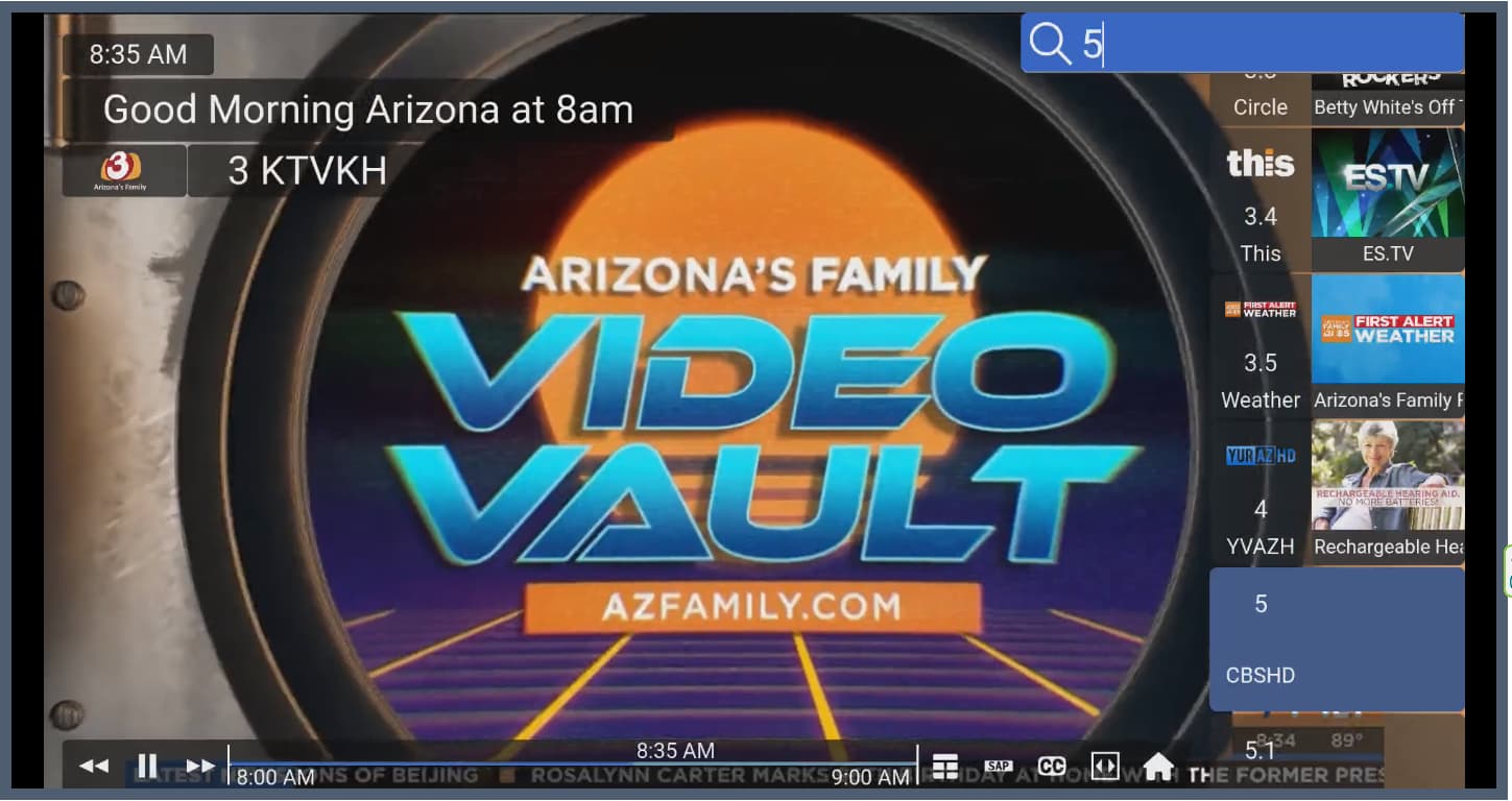

Channel 5 did not Change Android 9 it appears no select(enter) was issued.
Nah. I think it might be the way the HDHomeRun app filters the channels when you are entering them by number. The "enter" button does nothing unless there is only one result for the search.
I'm not filtering out letters in the channel number field so you can possibly try call letters (ex. KPXG) or something as the channel number to see if that helps. Edit: this no longer works.
After more testing, you are correct, I checked other channels from 6 to 20s, and they all change. It just won't change channel 5 or channel 3, but other than that it seems to be working.
