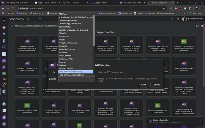

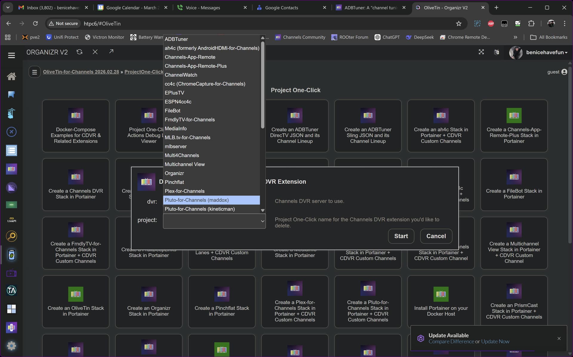

Pretty sure i was using latest and that it was set by OliveTin (I was using the automation as much as possible and it was awesome!)
I understand and sympathize with what it can be like! ADBTuner is my preferred capture method, too, because I find it so intuitive and clean. I'm going to add you to a PM offline to discuss what we're up to, but to be clear, I'm perfectly happy working within whatever confines you or ADBTuner might have.
