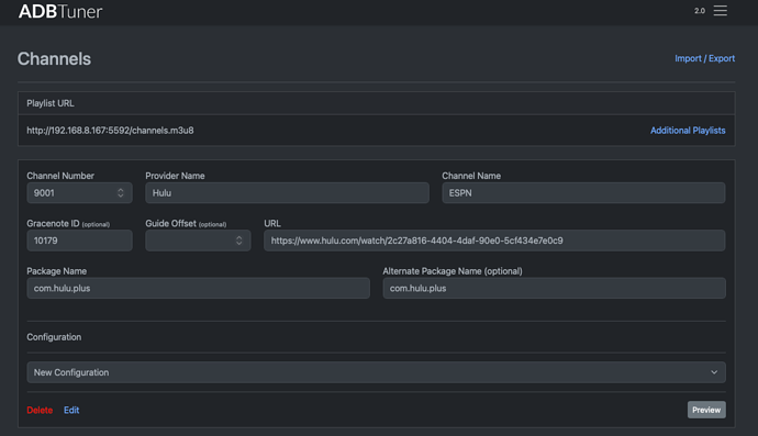

Tested the ESPN Unlimited Disney+ Hulu $35 bundle to get the ESPN linear channels working in ADB with the Hulu App:
It does work! Thanks for the advise @nateg
Hulu ESPN linear channels deeplinks for anyone that was looking:
ESPN: https://www.hulu.com/watch/2c27a816-4404-4daf-90e0-5cf434e7e0c9
ESPN2: https://www.hulu.com/watch/d6115f15-959f-4e42-8cb5-7ab54b966c02
ACC: https://www.hulu.com/watch/acc-network-4a61ce1f-1bfb-4de4-b5d4-2f542217f12f
SEC: https://www.hulu.com/watch/sec-network-315c6dbe-8c86-4ad4-a7ca-06acc006859a
ESPNEWS: https://www.hulu.com/watch/espnews-dbdc4011-d408-4697-a3d8-70e0bd179fe9
ESPNU: https://www.hulu.com/watch/espnu-8a3b8267-7a37-4097-ab44-b3e0d7abed57

ADB Channels using the Hulu Deeplinks
Below was some testing I did, but no longer needed. "Deep Links - Show Tuning Process" is working
"pre_tune_commands"
Added "input keyevent 66" to press "enter" when ADB opens Hulu to get past the select profile screen.
"post_tune_commands"
Modified with a double "input keyevent 4", so my fire tv presses "back twice" on exit, so the Hulu app doesn't close and launches quicker.

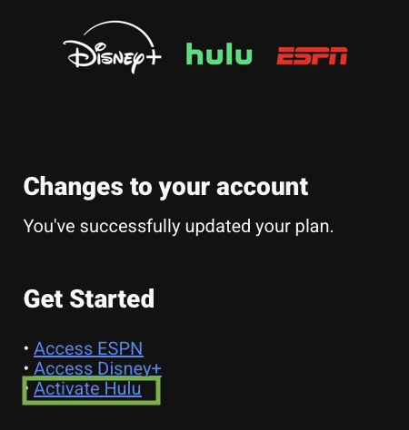

PS: When you signup for the ESPN Unlimited Disney+ Hulu bundle, you must activate Hulu in the email confirmation for the ESPN channels to work/show up in the FireTv Hulu standalone app.
