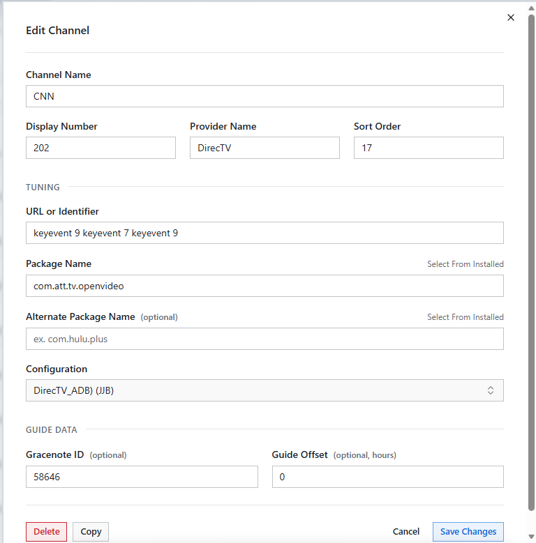

Can you share the custom tuning configuration you were using? Something like this should take the channel number from the "URL or Identifier" box and enter each digit one at a time. You can adjust any delay before entering the channel number and you can adjust the time between keypresses.
"tune_commands": [
{"ADB": {"command": "adbtuner_open_app ||TARGET_PACKAGE_NAME||"}},
	{"WAIT_FOR_FOCUS": {"package_name": "||TARGET_PACKAGE_NAME||"}},
	{"ADB": {"command": "sleep 1"}},
	{"ADB_NUMBER_INPUT_SEQUENCE": {"number": "||TARGET_URL_OR_IDENTIFIER||", "input_delay_seconds": 0.3}}
Hello. Thank you for responding. I have attached images of the channel setup screen and the tuning configuration - at least I hope there attached. The docker image tag for the adbtuner version that works is 20260907-5. I don't know if any later versions work, I do know that the latest version did something to the construction of the adb input command which cause the command to be ignored. I appreciate your recommended fix, but for the Gemini device you cannot send is multiple input commands. I tried that originally and the device would immediately tune to the first keyevent it received. As an example tuning to channel 202 using multiple input commands changes the channel to 2 than 0 than 2. The device needs to receive the entire number using one input statement with no delays between numbers. To change the channel on the Gemini the correct input command would be --- input keyevent 9 keyevent 7 keyevent 9 --- this sends the entire channel number 202 to the device using one input command. Hey since I have some of your attention - this thing would really rock if you could develop an interface to Home Assistant and log a channel number change as an event. The possibilities of integration would be immense. Take for instance setting mood lighting, configuring your display for best picture, turning on and configuring audio equipment all based on what channel youre viewing. Anyway just a thought. Thank you again for all your work.
Heres the second image.
Snapshot_9
If this configuration worked as-is then replacing the "tune_command" block with the following and putting the channel number in the "URL or Identifier" box for each channel should get things working correctly.
"tune_commands": [
    {"ADB_NUMBER_INPUT_SEQUENCE": {"number": "||TARGET_URL_OR_IDENTIFIER||", "input_delay_seconds": 0.1}}
Thank you. I’ll try it later today and let you know the outcome.
Works great. Thanks for fixing this and the bonus of not having to manually convert the channel numbers into keyevents.
