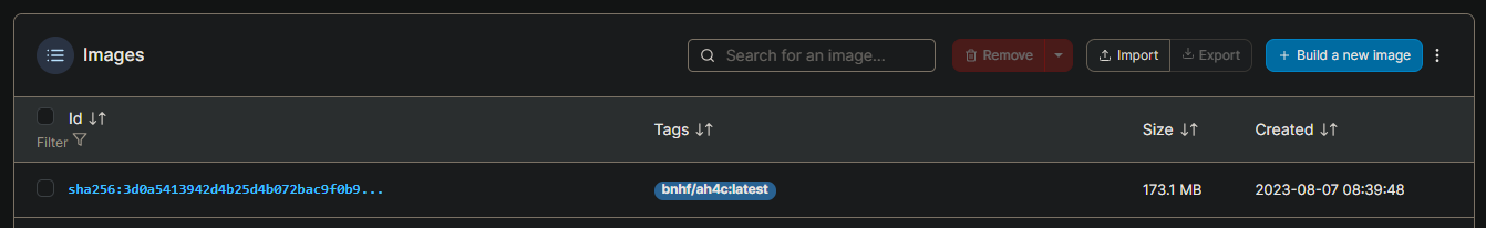

I recreated the docker in Portainer. Is there a way to tell if Iâm on the version with the Fubo workaround?
Go to Docker hub and hover over where it says "Pushed" for the container in question, and compare it to the "Created" column in Portainer-Images:
If both are "latest" and your created date is after the last push date, you have the most current image.
Docker Hub is likey using PDT, whereas I'm MDT (so if the difference is less than the margin of possible TZ differences, you might want to pull a new image
