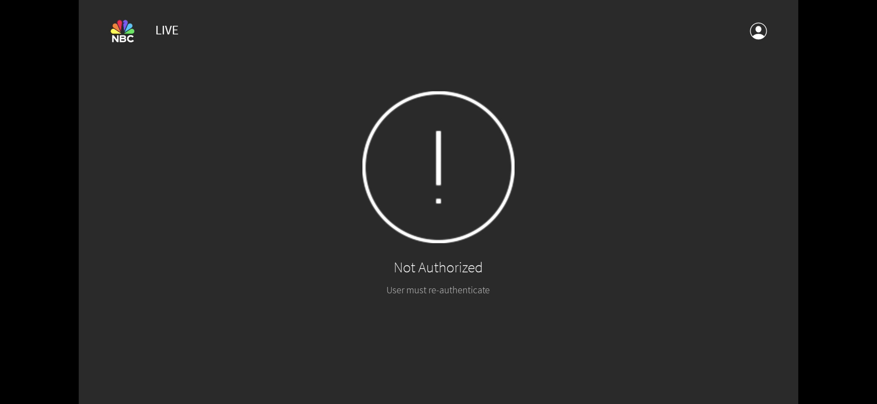

Anyone else getting a not authorized user must reauthenticate error when trying to tune in NBC channels?
It’s been happening to me all week. I then go in and delink youtubeTV and link it again and it lasts a few hours then it happens over again.
I've never been able to use this app with YTTV auth. Even just using it normally it constantly requires re-authentication for me.

It's crazy the NBC App is hosed but CC4C works fine with NBC. One would think it would be the other way around.
