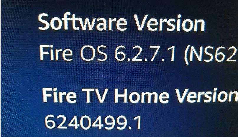

Ok spent my evening messing about with 1 of my sticks I have now have it unlocked, rooted and running 6.2.7.1
Which is great news as it means Channels will now work correctly!!
I'm not going to lie its quite involved to do but following these tutorials and a bit of intput from myself finding the 6.2.7.1 firmware and anyone can do it
I will be deleting the Amazon launcher and running a custom launcher in the next day or so.
@tmm1 I will let you know if for some bizare reason the glitch is still there on 6.2.7.1 but I really believe this will be the issue resolved
I can confirm I have just watched the first 5 minutes of the ITV HD 10 o'clock news and it was perfect. This was the same program I sent the support files in for. Very happy.
Like I say its a bit of a nightmare to do, it involved opening up the stick, removing a heatsink, shorting out a terminal. Then getting on linux and running commands but I think its worth it!

If you're not bothered about your warranty and you're willing to spend a little bit of time tinkering rolling back to 6.2.7.1 works perfectly.
I've just done my second TV in less than an hour start to finish including installing a different launcher and setting up the launcher exactly how I want it. If you just want the stock launcher but a channels setup that works its about 30 minutes start to finish once you've downloaded what you need and go Linux booting from a USB stick. The hardest part is shorting out the required pin with tin foil the rest is easy enough.
If anyone does do it let me know I'll happily send you the commands for the 6.2.7 1 and files you require. I highly recommend carrying on and installing the wolf launcher the difference is amazing compared to the stock launcher it's how the device should have been from factory in my opinion
