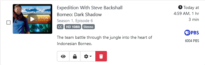

Once again, in Spanish
TVE recording

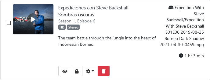

Screenshot_2021-04-30 Channels Manage Recordings (1)
That TVE recording imported
Screenshot_2021-04-30 Channels Manage Recordings (2)
The PBS Father Brown series has a similar “goof.” The guide shows Father Brown. But after the show is recorded, you can only find it searching for Padre Brown. The episode title and description are in English. Just another odd example from the Guide source.
I have often found when searching in Zap2It the default version of a program that comes up is the Spanish or Portuguese one. Since Channels is using the same source, I'm going to blame Gracenote on this one.
Channels seems pretty confused about series with remakes. For example, "All Creatures Great and Small", originally from the 70s and remade in the last year or 3. Although I store them in different folders, with the year in the folder name, Channels mixes them all together as if they were one continuous series. I have a couple other TV series like that, similarly scrambled. AFAICT, I am using the recommended structured naming convention (Series title/Season 1/...s01e01...)
The problem is that Channels DVR uses Gracenote guide data to match TV shows.
zap2it.com also uses Gracenote guide data, so you can search for the shows there.
You'll see they list 3 separate shows (different SeriesId's and tmsId's in the url).
Click the Episode Guide tab there to see the episodes.
The one from 1978
https://tvlistings.zap2it.com/overview.html?programSeriesId=SH02487590&tmsId=SH024875900000
The one from 2020
https://tvlistings.zap2it.com/overview.html?programSeriesId=SH03619593&tmsId=SH036195930000
Same one from 2020 but aired on Masterpiece
https://tvlistings.zap2it.com/overview.html?programSeriesId=SH03661147&tmsId=SH036611470000
You can match the one you want by using the tmsId in the find match window
i.e. SH024875900000 for the 1978 series
