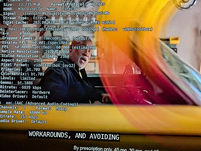

Have you tested any of this yet with your encoder set to H.265. I think we've all gotten used to using H.264 due to certain limitations of ADBTuner, but HEVC encoding combined with captioning could be pretty killer for ah4c. Don't you think?
My spidey sense tells me this could be better for avoiding transcoding issues...

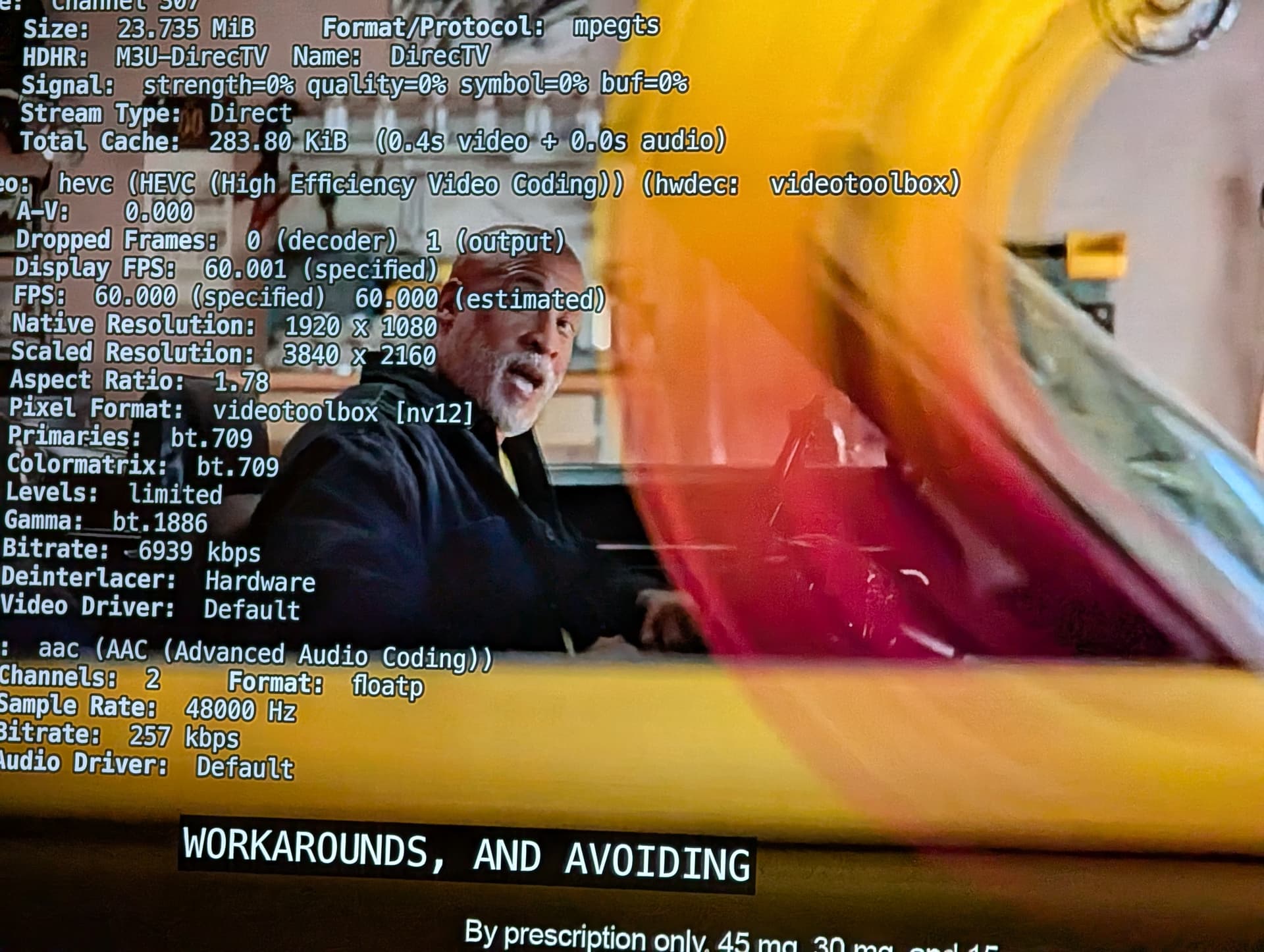

For what it’s worth, ADBTuner supports H.265.That was fixed a long time ago. I’ve been running H.265 in my own config for a while.
@anon38303228 clever idea with the captions!
Edit woo hoo:
That screen capture looks sharp as hell, nice and crisp. Good work!

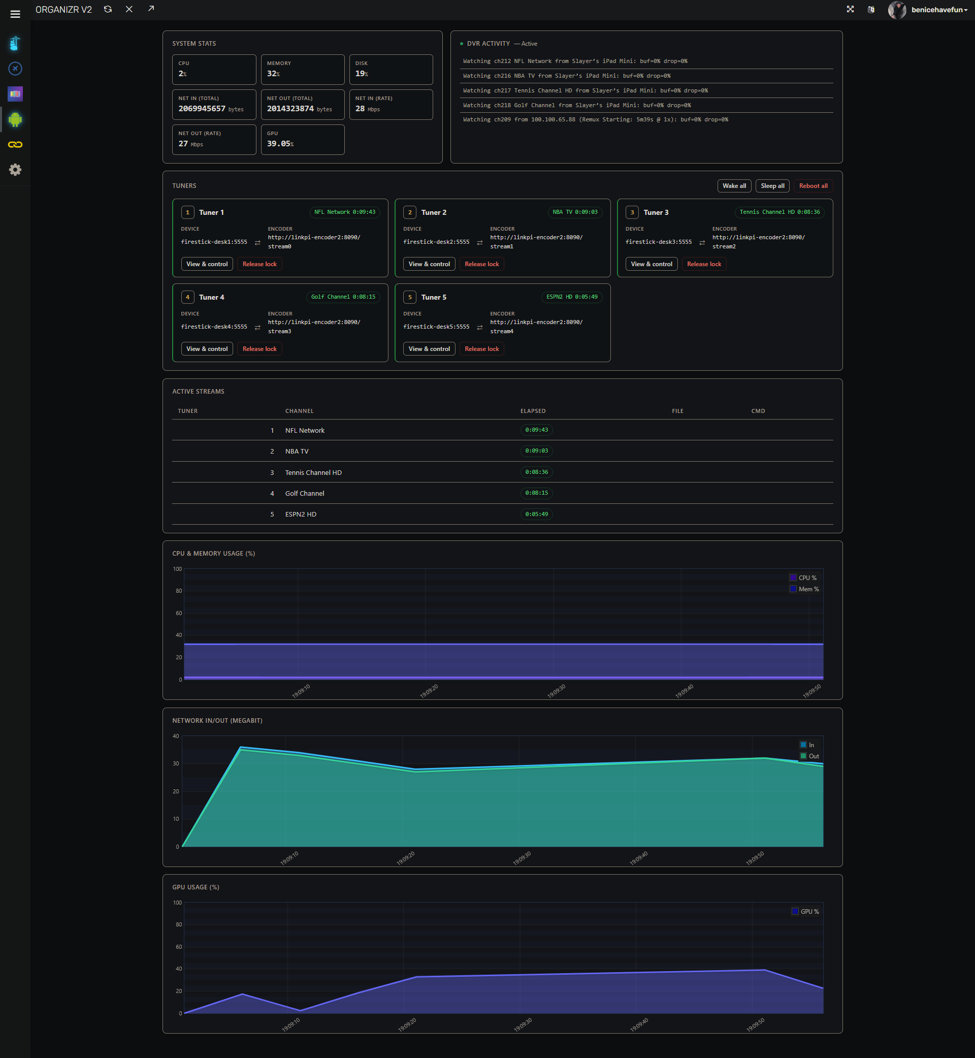

Here's what things are looking like in my ah4c Docker container with five tuners active (all with captions being added), using the compact setup I detailed here:

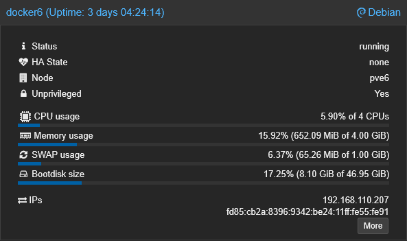

As promised in an earlier post, here's a less expensive (as compared to a PoE-powered rackmount), compact way to build a five tuner LinkPi-based setup. This uses a well-built seven port USB 3.0 hub for power, some short USB A to right angle micro-B cables (to keep voltage drops low), and some right-angle HDMI adapters. The streaming sticks are FireStick 4K Max (Gen 2) (currently 20% off with trade-in), as they support Wi-Fi 6, and have a great form factor for a compact build like this. Due t…
Here's the new Activity page from ah4c. This is with the Parakeet Unified Model, and using all recommended/default settings:
The Proxmox Debian LXC I have running this Docker container is barely breaking a sweat. The GPU is doing all the work, but it's in bursts:
intel-gpu-top: Intel Raptorlake_s (Gen12) @ /dev/dri/card0 - 88/ 88 MHz; 91% RC6; 0.38/41.61 W; 7 irqs/s
