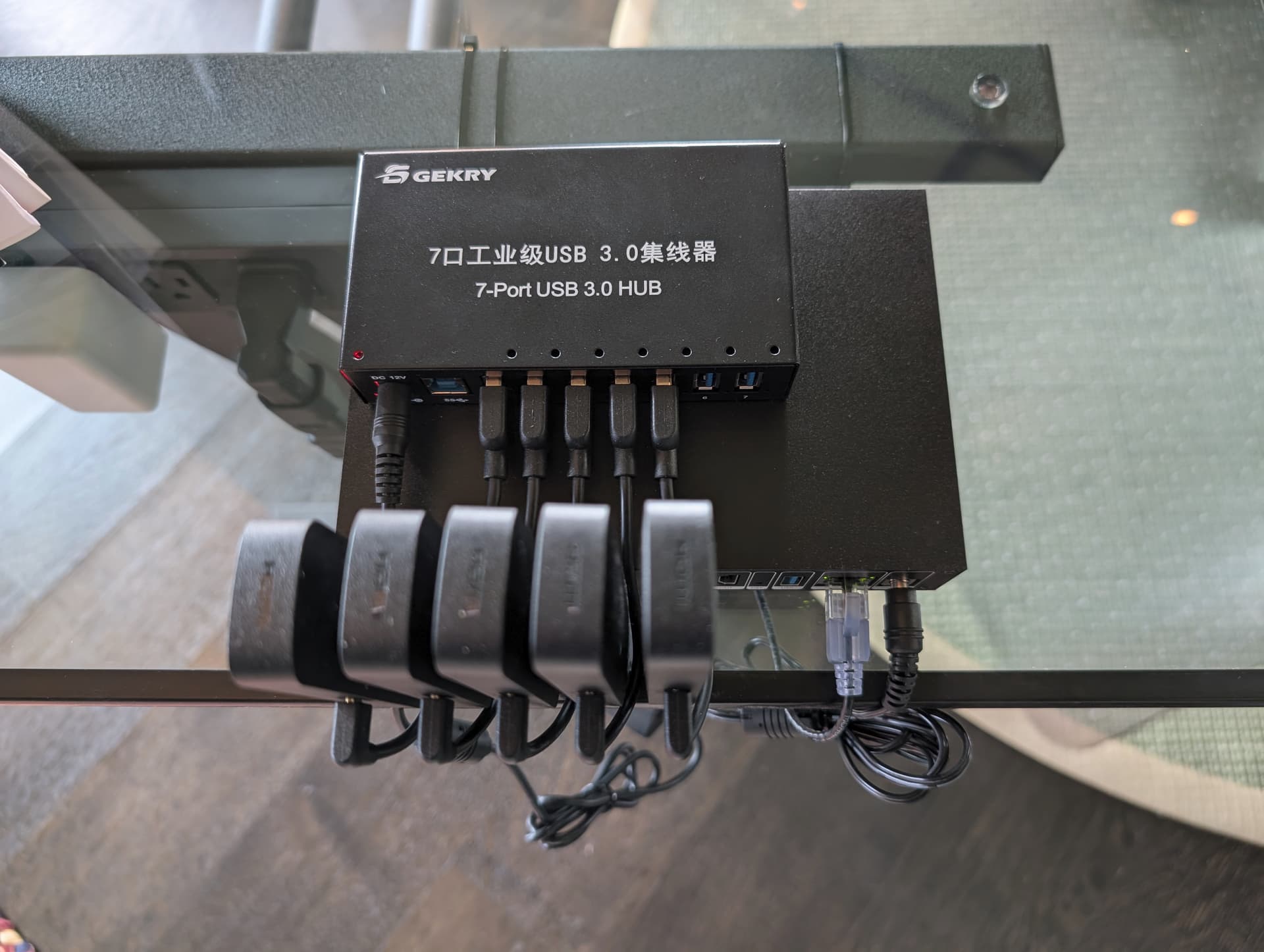

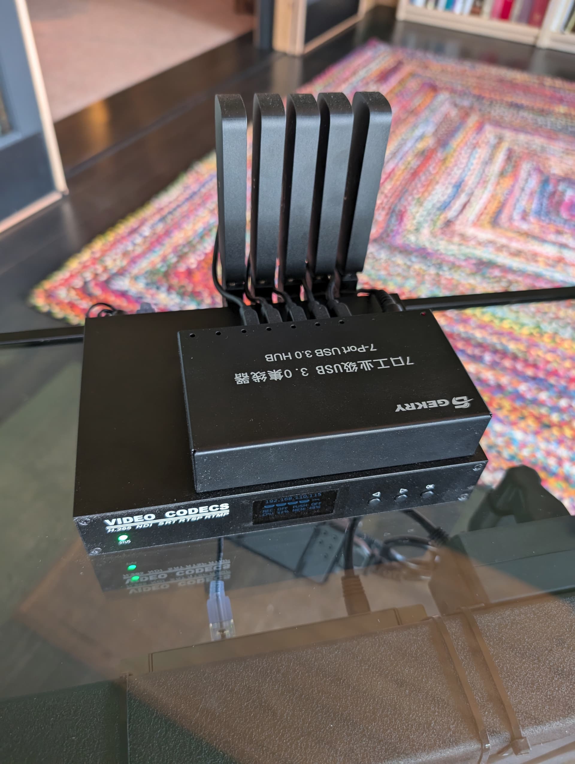

As promised in an earlier post, here's a less expensive (as compared to a PoE-powered rackmount), compact way to build a five tuner LinkPi-based setup.
This uses a well-built seven port USB 3.0 hub for power, some short USB A to right angle micro-B cables (to keep voltage drops low), and some right-angle HDMI adapters.
The streaming sticks are FireStick 4K Max (Gen 2) (currently 20% off with trade-in), as they support Wi-Fi 6, and have a great form factor for a compact build like this.
Due to the proximity of the FireSticks, I would highly recommend the router or AP they're connected to support both 5GHz and Wi-Fi 6 (which has been specifically designed for this kind of high density WiFi, among other things).
EDIT: I've amended my USB hub recommendation. Details can be found here:

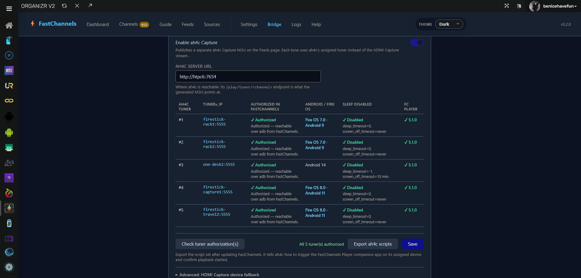

I'm going to insert a bit of a PSA here, as there's been something of a game-changer I've been using for the last week. The foundation is the same as what we've been illuminating in this thread, but at the same time, it feels different.
If you're a current (or willing future) user of DTV Stream, Sling or Philo, FastChannels now has both HDMI Capture and ah4c (multi-tuner support) that acts like tve (with similar or faster tuning speeds), but is not limited to some subset of the channels you subscribe to.
Yes, we're talking about an encoder-based solution, though in this case you have the choice of hardware or virtual encoder approaches. You can start simple, with a capture card and streaming stick, and expand that with more of the same -- or make the jump to a network-based hardware encoder.
Here's an example, where I have the US Open on the "big" TV, the kitchen, and the primary bedroom. In addition, I have four other channels running in CDVR Multiview on an iPad. Each tuned in ~4 seconds, and what you're seeing is mix of sources using a couple of different encoders, and a couple of Capture Cards that are doing their thing in a Proxmox LXC running Channels DVR:
Candidly, if you have reasonable technology skills, and they're combined with a splash of enthusiasm for having all of your content in a single app -- this is all very achievable. I'll add, that if you choose your components with some care, and spend the time to understand the concepts -- a setup like this can be put together with very little maintenance required.

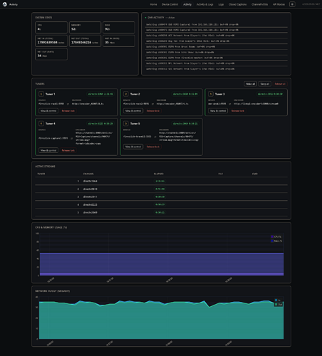

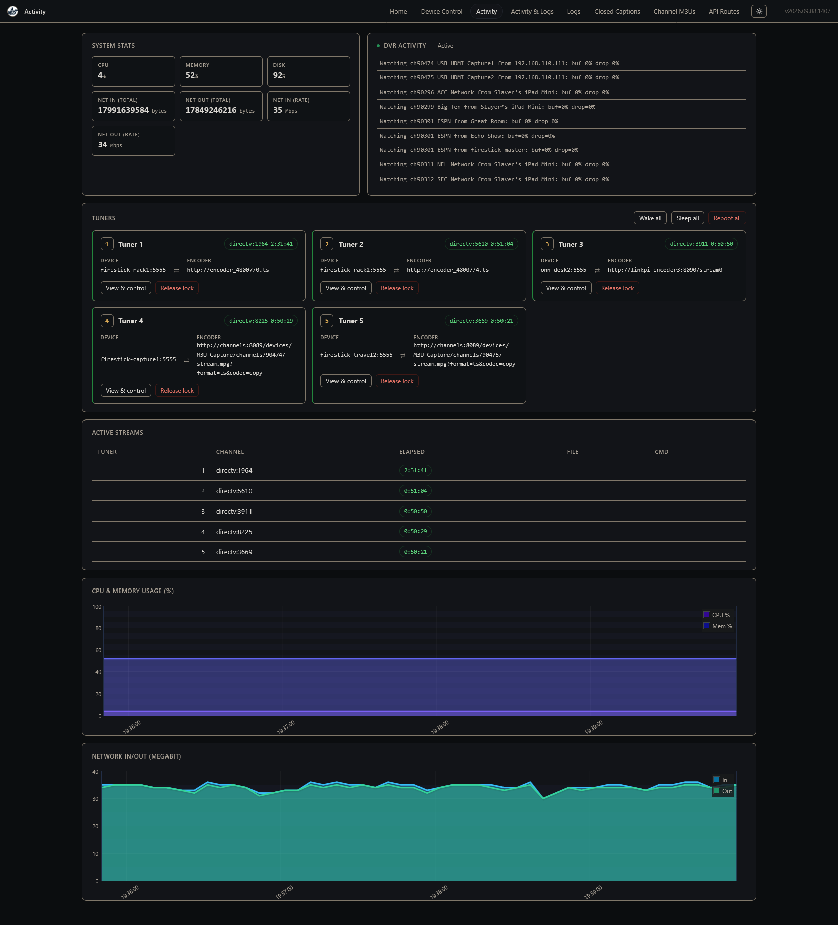

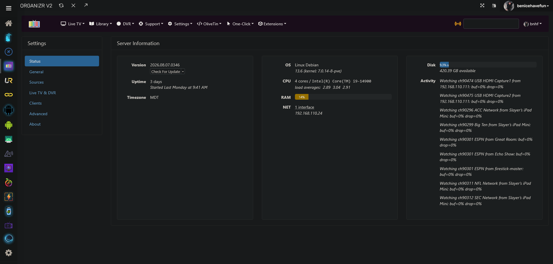

CDVR server reusing streams, so 5 tuners can feed multiple TVs and Multiview:
Tight integration between FastChannels and ah4c:

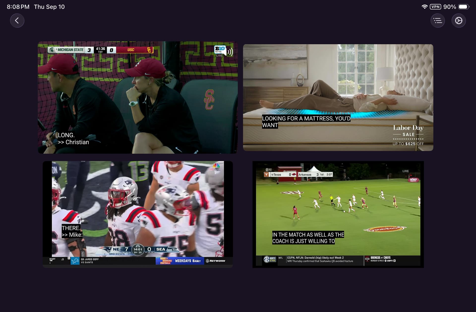

iPad Multiview with Closed Captions in each view:
