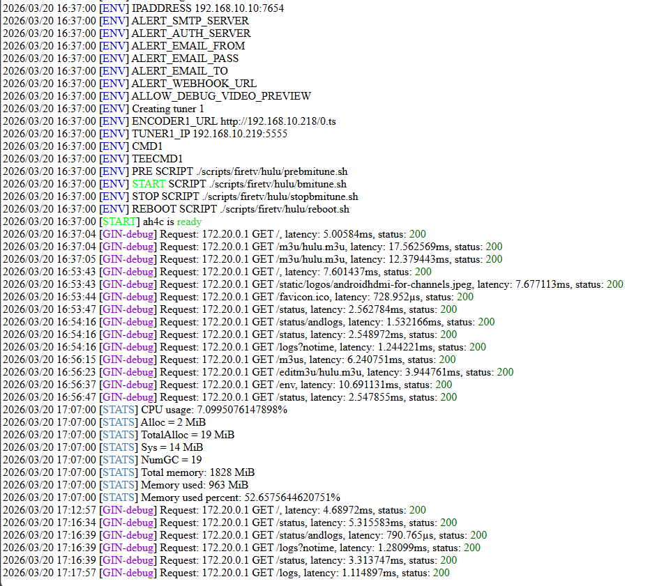

Hi, trying to run project one-click to install ah4c. I already have portainer running and channels dvr running in a container. I get this error when after hitting button to "Create an ah4c Stack in Portainer + CDVR Custom Channels" using project one-click " JSON response from 192.168.10.10:8089: {"error":"failed to load m3u: no channels found in m3u"}. Is there a pre-requisite to running one-click such as ensuring that I have certain paths defined on my Synology NAS? I already have these 2 folders defined: /volume2/data/ah4c/scripts and /volume2/data/ah4c/m3u and both of these folders are currently empty.
You should start with valid values for HOST_DIR, STREAMER_APP and CDVR_M3U_NAME, and then later if you want to create something custom, you can do that and contribute it back to the project.
So for example, if you're still working with Hulu, these would be typical on Synology:
HOST_DIR=/volume1/docker
STREAMER_APP=scripts/firetv/hulu
CDVR_M3U_NAME=hulu.m3u
In the above example on Synology, /volume1/docker/ah4c needs to be created in advance.
Thanks, I was able to get the one-click to run error-free. ah4c container is running and I can access the website via IP_Addr:7654. tuner status still shows false. Logs are below:
That just means you're not actively streaming anything.
so the logs look to be in a good state? The ah4c tuner did appear as a source in CDVR admin. Is there a way to see what is coming out on HDMI port (like the "view" ability on adbtuner). Tried to play a channel via this tuner but no luck. this is progress!

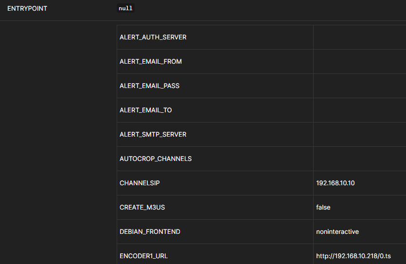

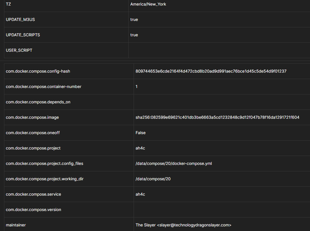

I spent hours truing to get adbtuner to work with the tivo. Once I got the google Streamer it was working in 15 mins Here are my ah4c ENV variables:
Please post the env vars as shown in the Environment variables section of the Portainer-Stacks Editor. They should look like this:
TAG=latest
