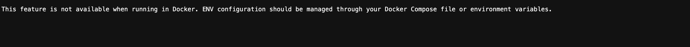

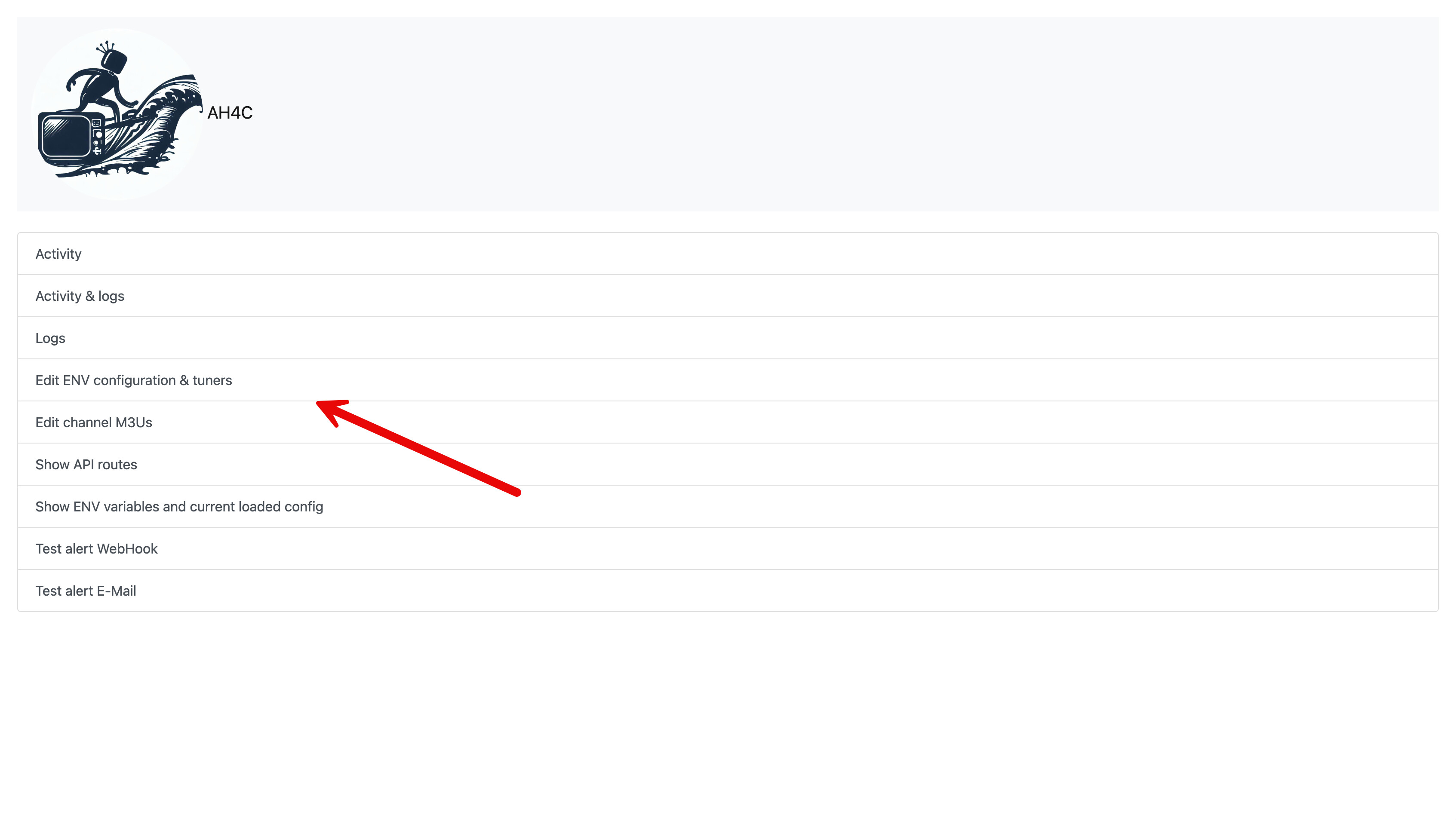

Only the activity and logs options are relevant to Docker installations, and even those are of modest value, as the logs available through Portainer are best. You can pretty much ignore the WebUI, as it's mostly for non-Docker users, of which there are very few.

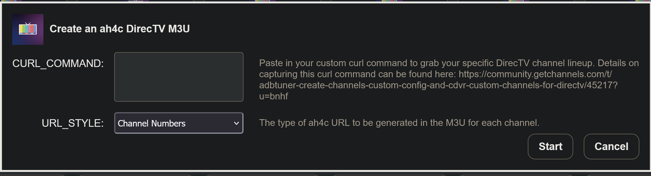

This has been pushed as bnhf/olivetin:latest (aka bnhf/olivetin:2026.03.29), and the new Create an ah4c DirecTV M3U is available in the classic Dashboard or Project WebUI+.

Added an option to the new Action to generate deep link or channel number style URLs in the M3U. The M3U appears in the results window, and can be copy and pasted as desired:
works great!

I went with a one-line change in the DockerFile, to remove those two incompatible menu items during the container build. Just pushed as bnhf/ah4c:latest (aka bnhf/ah4c:2026.04.04):
It's also tempting to just remove this menu completely, though the M3U editor can be handy, so I'll probably leave it.
The more valuable WebUI included with ah4c is ws-scrcpy, where you can interact with your streaming sticks via an ADB shell:
