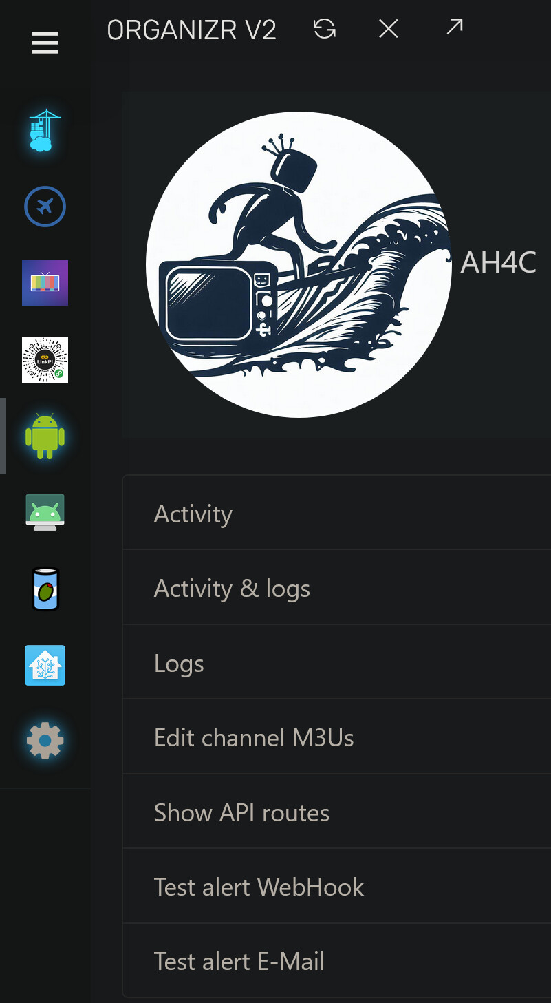

I went with a one-line change in the DockerFile, to remove those two incompatible menu items during the container build. Just pushed as bnhf/ah4c:latest (aka bnhf/ah4c:2026.04.04):
It's also tempting to just remove this menu completely, though the M3U editor can be handy, so I'll probably leave it.

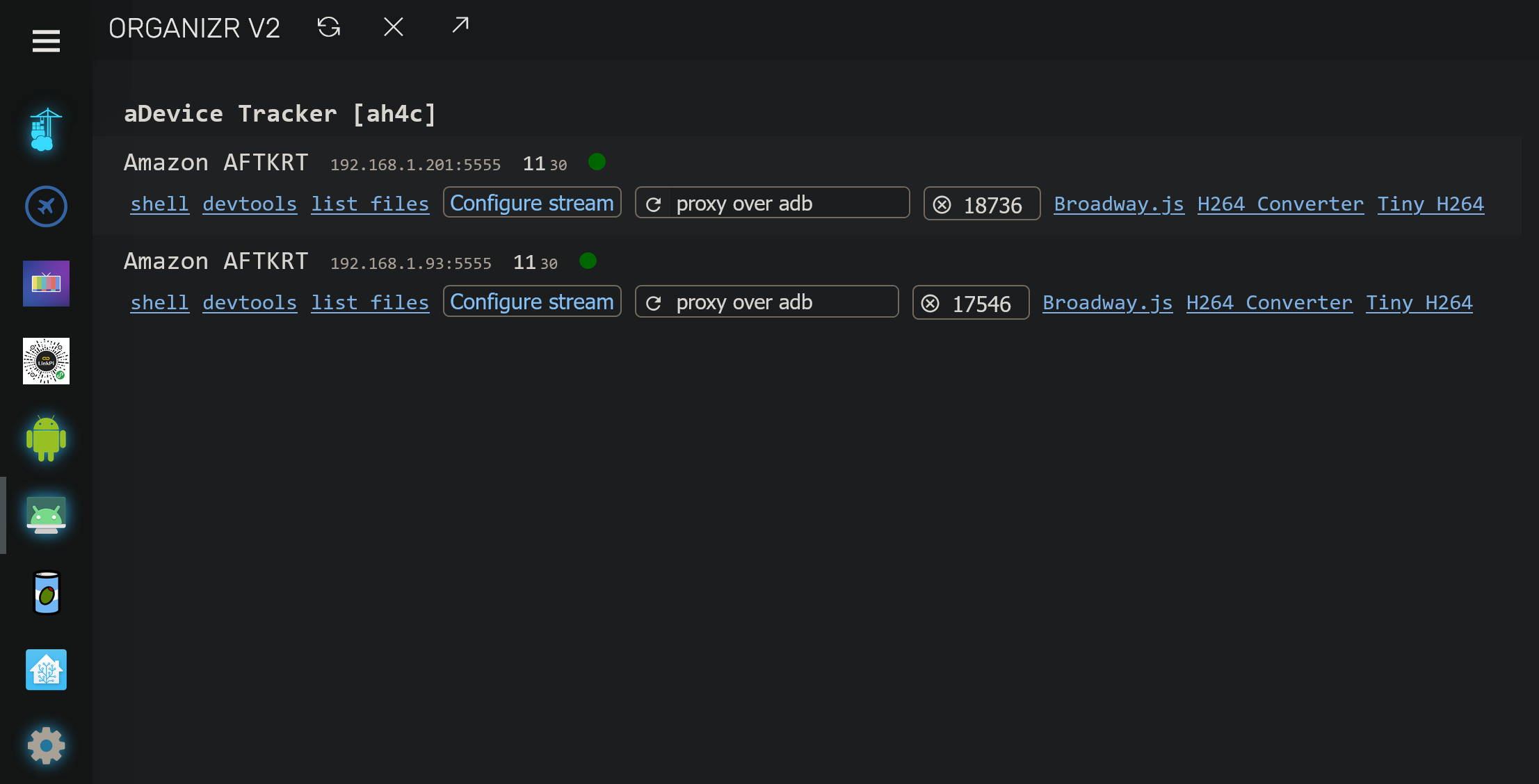

The more valuable WebUI included with ah4c is ws-scrcpy, where you can interact with your streaming sticks via an ADB shell:

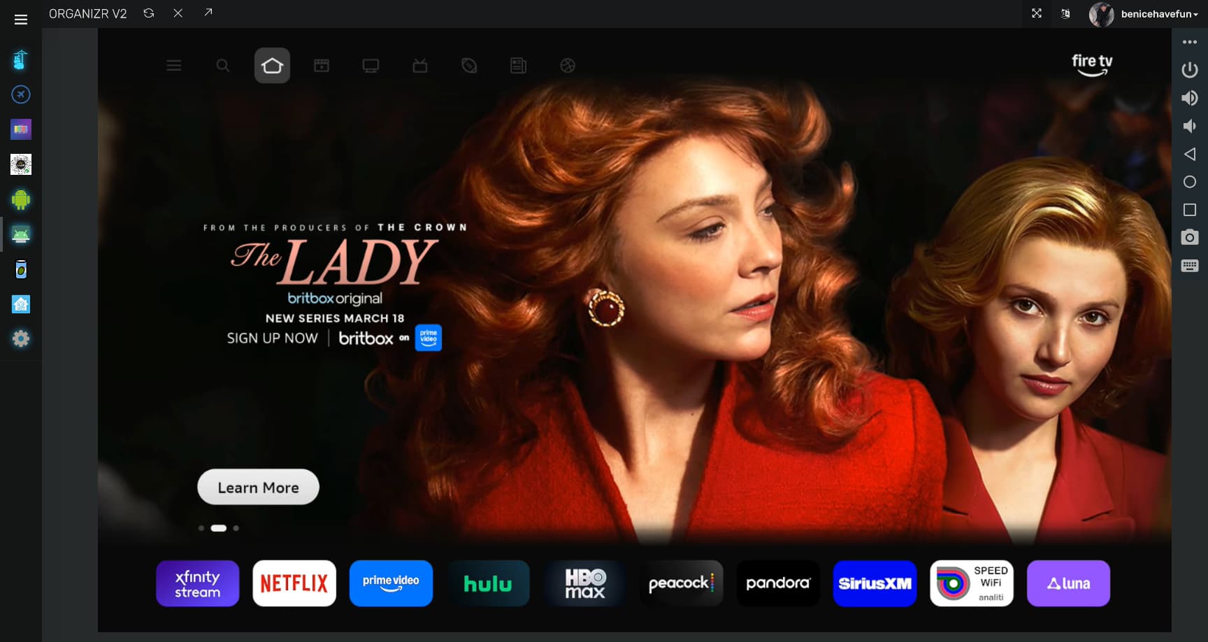

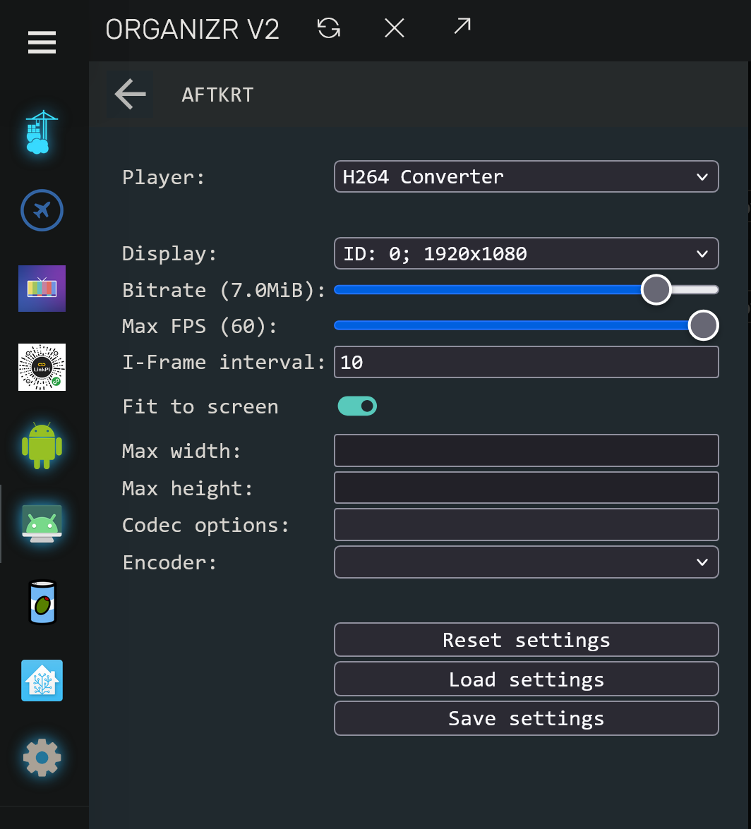

Or, via "Configure stream" to interact with the stick's UI:
