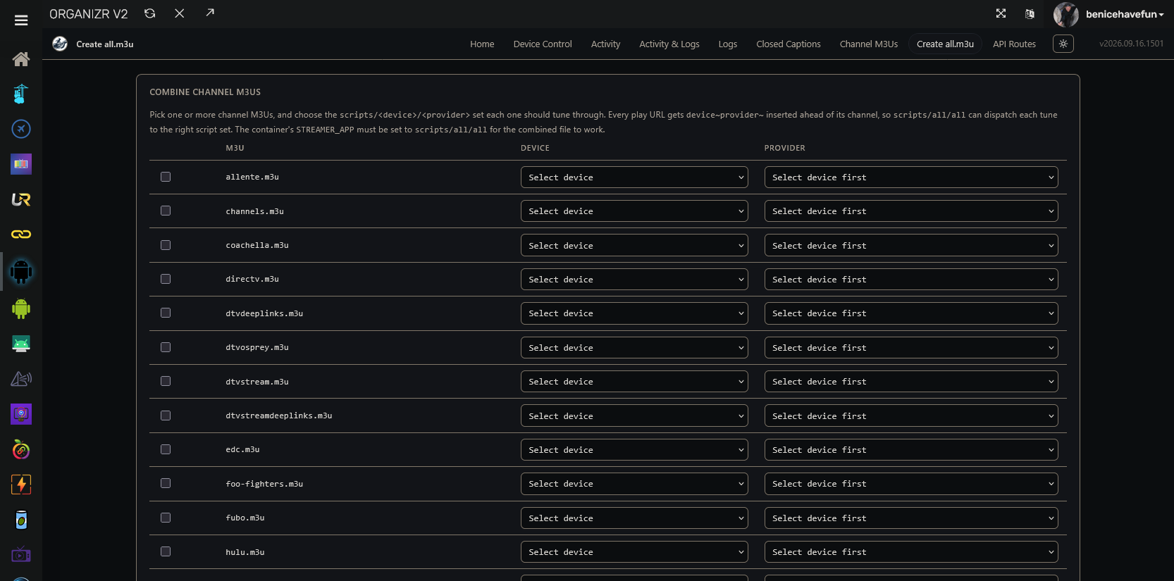

Some posts back, I laid out how to implement an approach to supporting multiple providers in a single ah4c container:
This has been formalized now through the WebUI. If you want your ah4c instance to be able to tune using multiple different apps, requiring multiple sets of scripts and a combined M3U -- it can all be done very easily by first creating an "all.m3u", and then setting STREAMER_APP=scripts/all/all.
Using the new Create all.m3u menu item, you can select the M3Us you want to combine, using which set of scripts:
Your CDVR Custom Channels Source will just need to reference this all.m3u (or whatever you chose to call it), and the correct set of scripts will be used for tuning.
