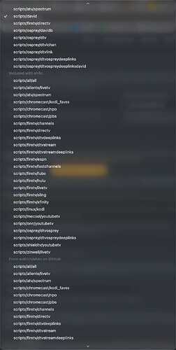

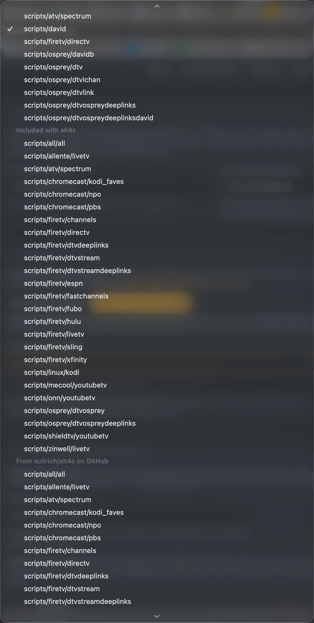

I pushed a test container but ran into a very minor bug. Fixing now. The stock scripts are back but the gh ones aren't showing up in the dropdown.
@mnwxman132
please test mackid1993/ah4c:latest or beta. If you could please also take a backup of your scripts and repeat the steps that caused data loss I'd appreciate the confirmation that is fixed!!
I agree with your approach, and the path of least resistance to have the scripts work is to avoid sleeping the apple TV and avoid prebmitune. For a newbie, it eliminates a lot of unknowns, then as they gain experience they can add back the scripts to support apple tv sleep.
The great thing about this new script scheme though is the houskeeping and ease of use to sideload the scripts. Once i figured that process out this morning it is very slick @mackid1993 to have the set of local scripts in the dropdown with the advanced path! And to switch back and forth for testing this is superb! I used to have to rename files and monkey around in finder, etc. So this is very nice!

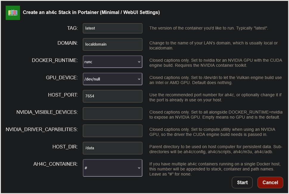

Also, bnhf/olivetin:latest (aka bnhf/olivetin:2026.09.22) was pushed yesterday, and includes the ability to spin-up an ah4c-minimal stack that allows you to specify the minimum number of values required in env var form -- making the maximum use of WebUI Settings:
Multiple ah4c stacks are also supported, by selecting a container number.

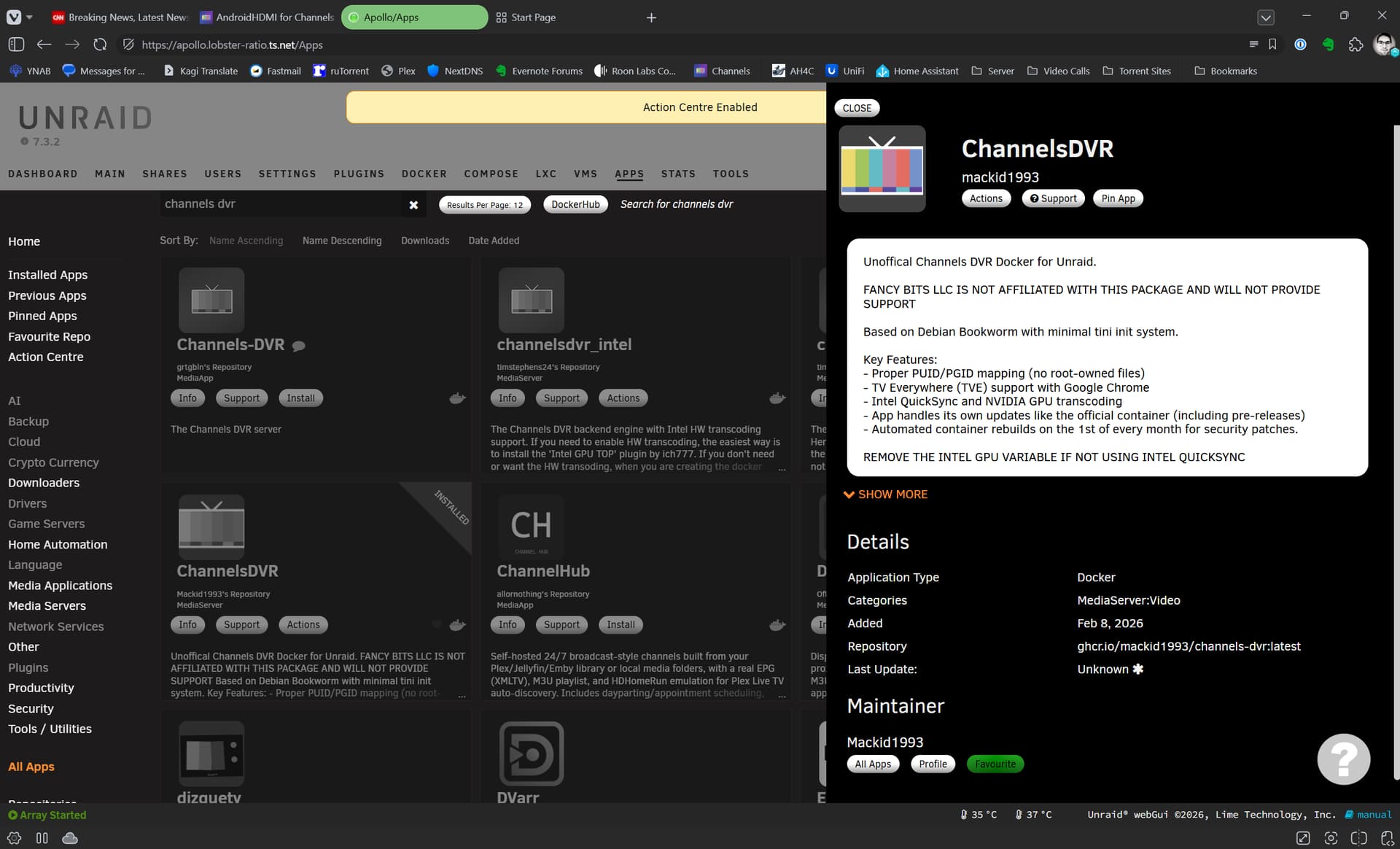

Quick question for the docker logs startup if compose is not used. Can we suppress the log note on the compose file being out of date or can the message be changed to ignore if compose is not in use? I plan on getting ah4c on Unraid Community Apps once this is final using bnhf/ah4c:latest. All I have to do is author an Unraid XML file and drop it in my repo-- super easy but I was hoping to avoid misleading log messages since it's bare docker with some Unraid one click easiness.
Sure, but a related question would be what if the XML needs to be changed (due to a new env var that can't be handled in settings, for example) -- is there a way to add a date to the XML that could function in a similar way -- so someone would know the XML template they used is out of date?
Oh! It's just handled in git. You have to reach out to the CA maintainer to get your repo approved for Unraid CA. It updates all repos every 3 hours I think. If I had to make a change I update my XML change it on Github and it gets pulled in automatically.
This is my custom Channels container for Unraid (handles root issues).
These are my templates that get pulled in.

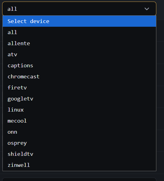

@bnhf this is from the create all m3u page.
Is this a bug? Or is all supposed to be a recursive option lol....
Edit: captions is listed too. pushing a container and a PR for last min fixes.
