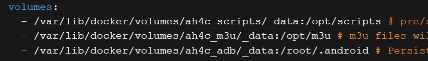

Thanks, I will some more investigating when I am able.
The lines are in Docker Compose the way you show.
The directories may not actually exist though.
This is the log after restarting Docker Desktop.
Everything works as long as I do not restart Docker Desktop.

I think I have this figured out now.
Like I said earlier, this is all new to me.
I will create the Volumes and edit the compose to point to them.
Thanks!

One odd thing.
The volumes say they are unused, but it survives a restart now.
What specific volume mappings are you using, and what OS is your Docker host running?
Docker Desktop with Portainer Extension on Windows 11 for workstations.
You're mixing up two things there. The location you're using is where a special thing called "Docker Volumes" are stored. We're not doing that, we're using directory bindings. Directory bindings "bind" or "map" a particular directory on the Docker host to a directory inside the container.
Are you using the WSL2 backend with Docker Desktop? If not you want to be, and you'll want to have a distro installed as well. Either Debian or Ubuntu.
yes, wsl2 and ubuntu
Not sure if it will help as I am a novice at portainer but in testing this I changed the following:
      - hdmi4channels:/data/ah4c/scripts:/opt/scripts # pre/stop/bmitune.sh scripts will be stored in this bound host directory under streamer/app
      - hdmi4channels:/data/ah4c/m3u:/opt/m3u # m3u files will be stored here and hosted at http://<hostname or ip>:7654/m3u for use in Channels DVR - Custom Channels settings
      - hdmi4channels:/data/ah4c/adb:/root/.android # Persistent data directory for adb keys
    restart: unless-stopped
volumes:
  hdmi4channels:

volumes:
- /data/ah4c/scripts:/opt/scripts # pre/stop/bmitune.sh scripts will be stored in this bound host directory under streamer/app
- /data/ah4c/m3u:/opt/m3u # m3u files will be stored here and hosted at http://:7654/m3u for use in Channels DVR - Custom Channels settings
- /data/ah4c/adb:/root/.android # Persistent data directory for adb keys
Is this the integration you're talking about?
And if so, are you good now using the above docker-compose and environment variables?
