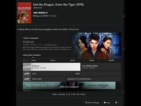

@bnhf I ran into a bug this morning.
When tuning a channel immediately following a banner, it tunes the channel above the banner instead.
I rescanned all the channels and then manually verified that the ID was correct.
There is a banner between these 2 channels and it always tunes the channel above.
The channel above works correctly.
Edit: tunning up from below the banner.
Seems like this should be easy to reproduce. I'll have a look at it tomorrow. Thanks.
The only difference might be that it is tunning up from the bottom of the list instead of from the top as shown here.
Edit:
I just tried it again, the banner has moved and it still does not tune this channel.
Seems to be this specific channel that does not tune.
I'm rescanning to see if the ID changes now that the banner moved.
Rescanning came up with same ID.
I tried this channel on both tuners, neither one will tune this channel.
The ID on the second tuner is different as expected. 27 on first tuner, 50 on the second tuner.
In both cases it tunes the channel above it in the list.
