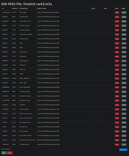

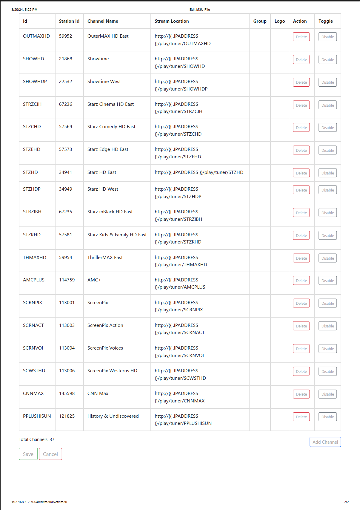

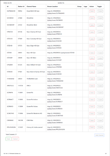

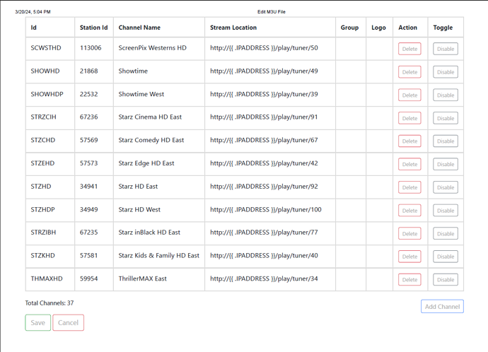

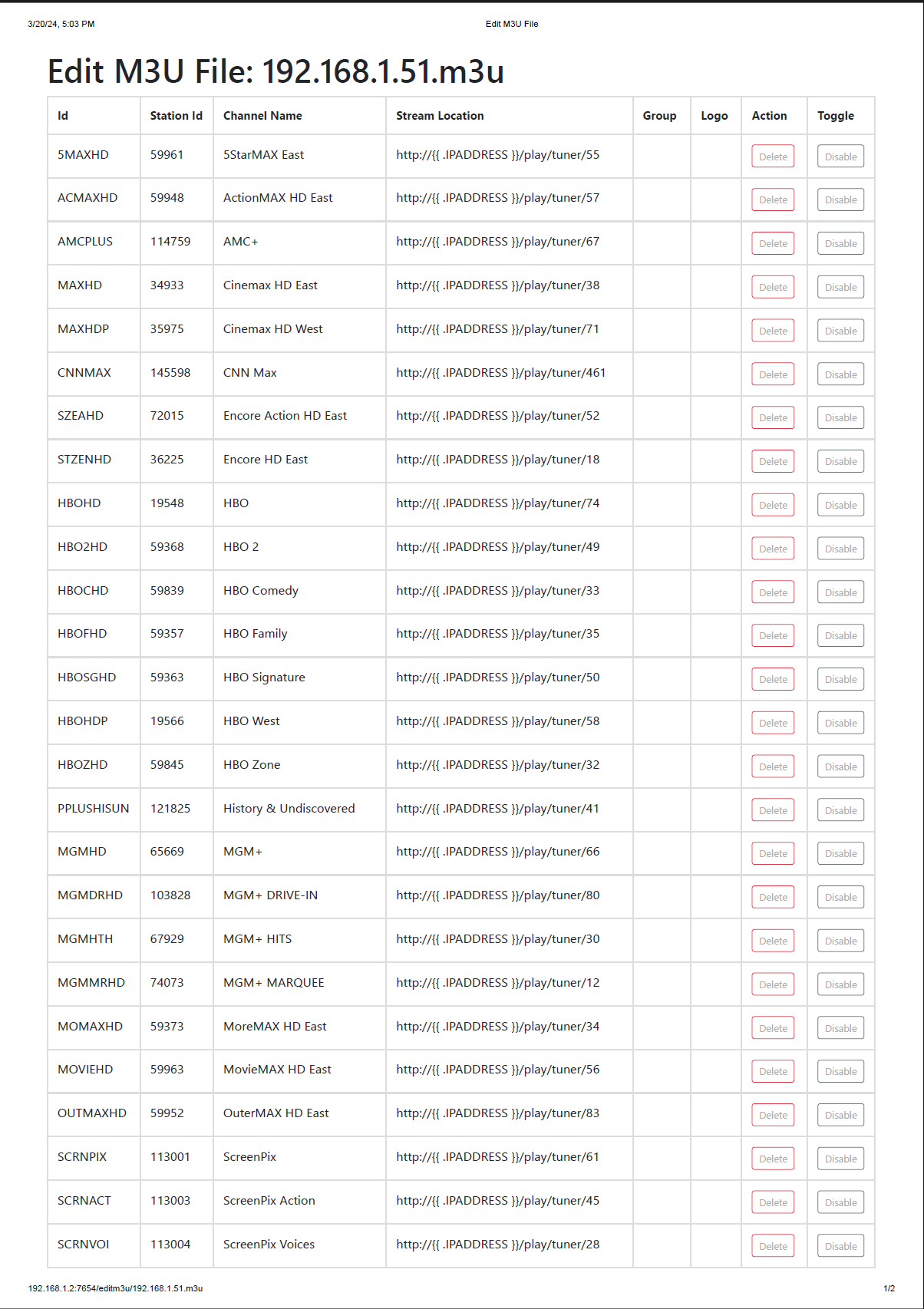

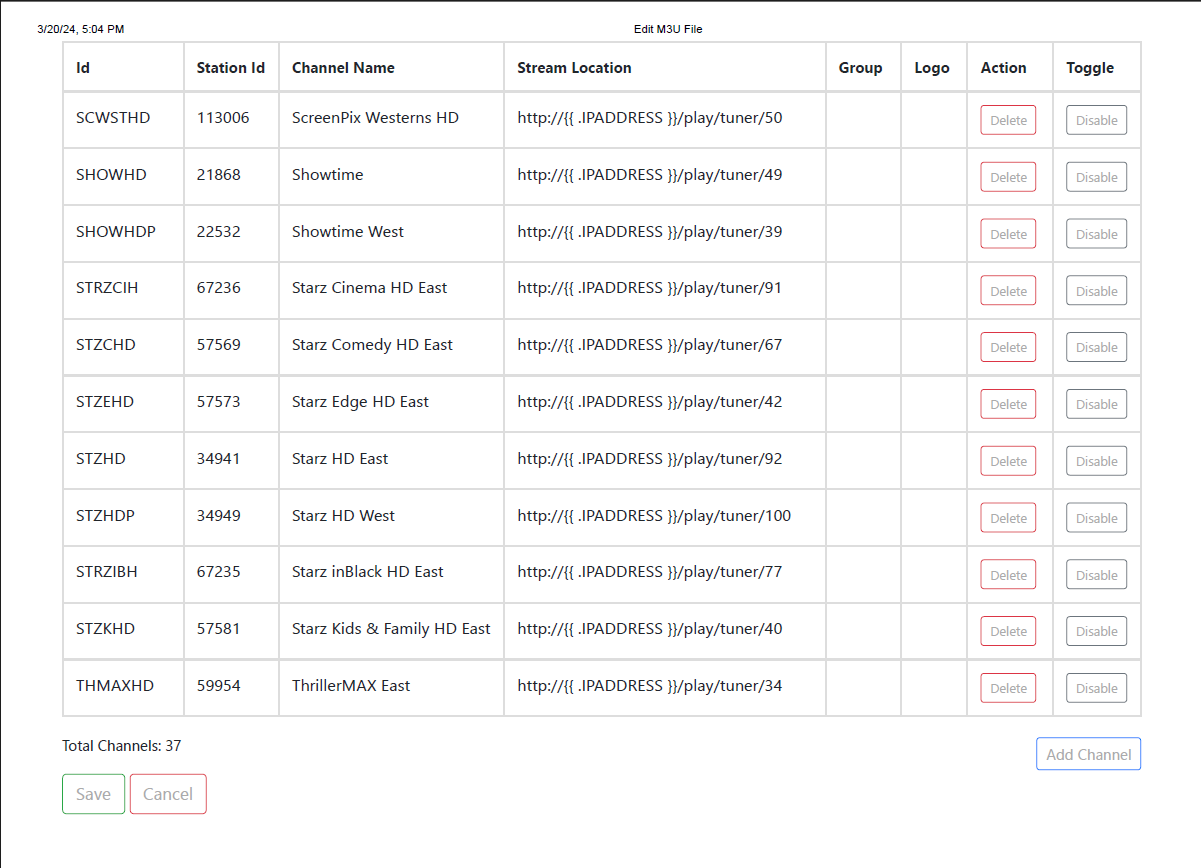

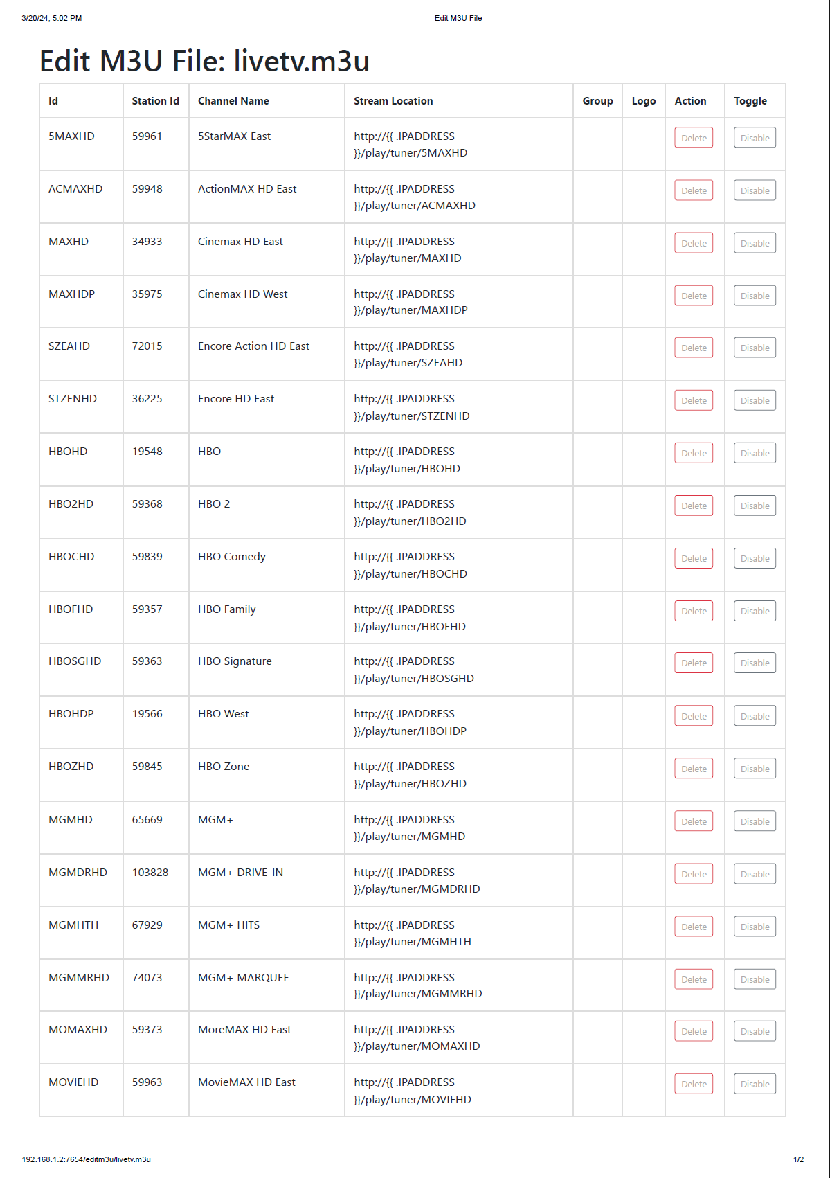

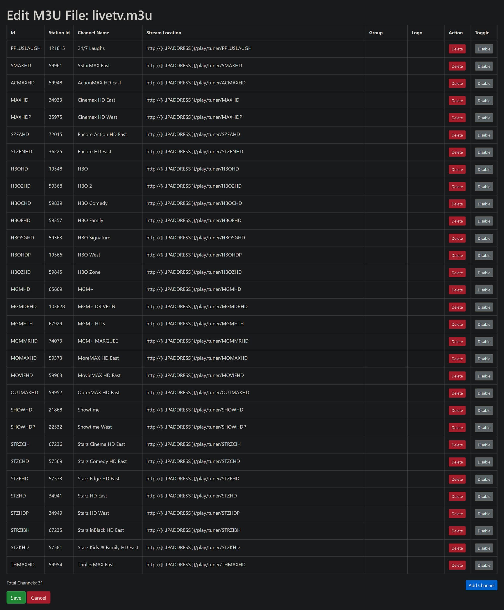

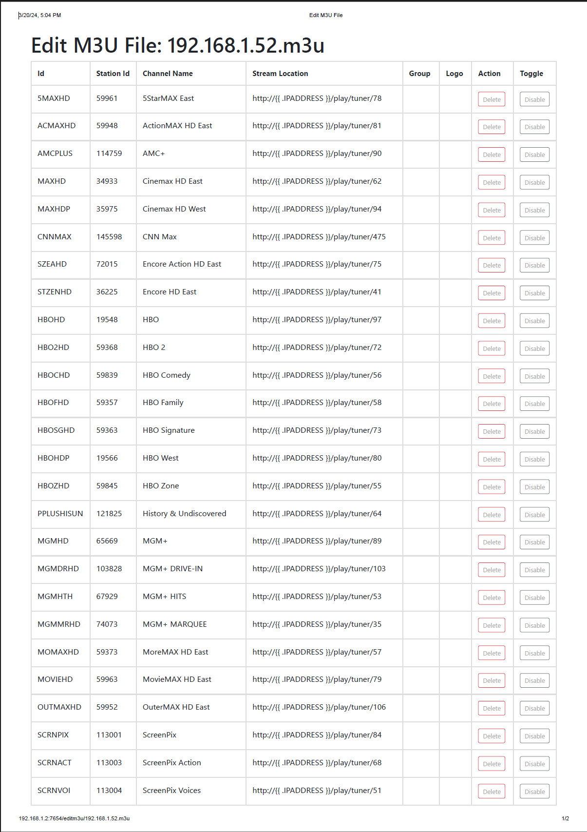

Could you post the livetv.m3u you're using from the ah4c M3U Editor, and the same for each of the FireStick-specific M3Us created? Should look something like this:
FireStick 1
FireStick 2

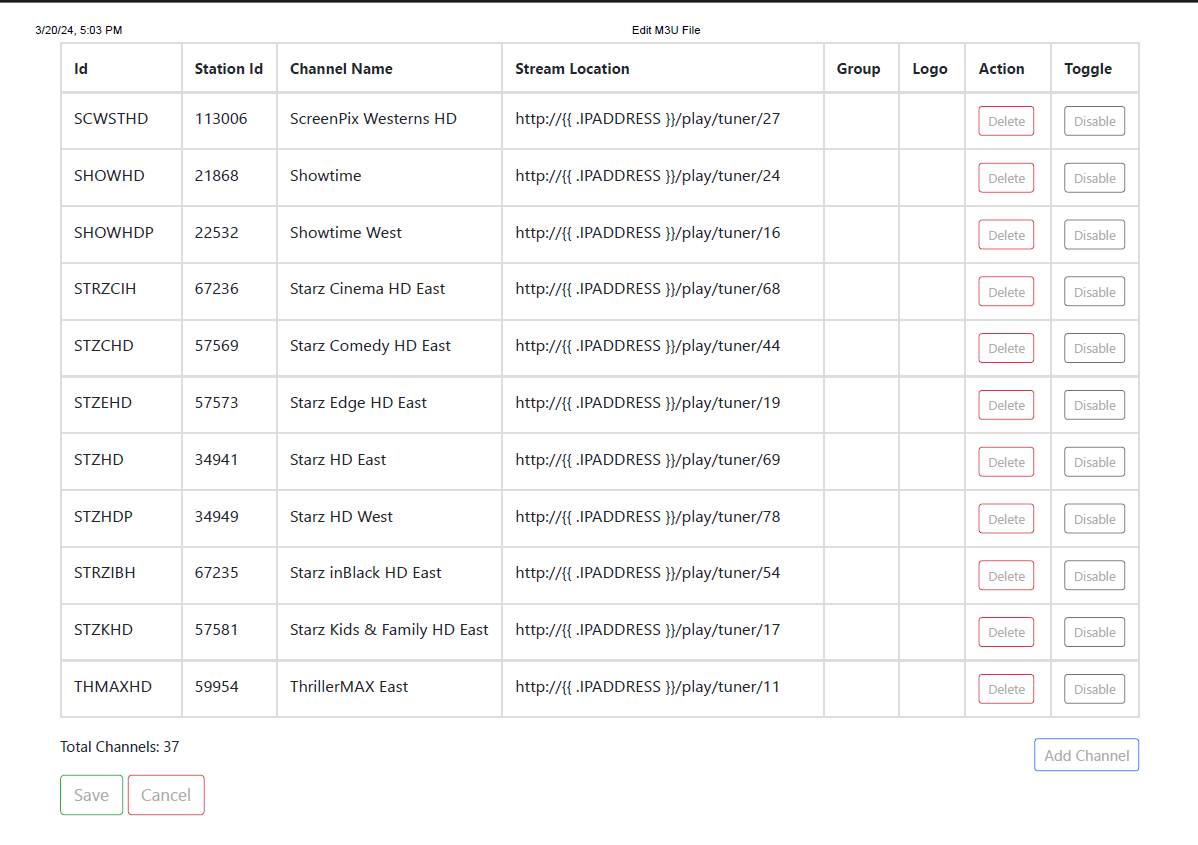

I did notice this while creating new M3U's
Initial pass through the guide completed
Beginning second pass to confirm play/tuner values...
Confirming a guideID #EXTINF:-1 channel-id="" tvc-guide-stationid="" tvg-group="" tvg-logo="", is present
assigned to M3U channel name:
scripts/firetv/livetv/createm3u.sh: line 82: [: too many arguments
Confirming a guideID 55 is present
I appreciate you testing the M3U creation process -- but I wouldn't recommend doing that every time, especially is you have working M3Us. Set the CREATE_M3US env var to false to prevent recreation on every startup.
