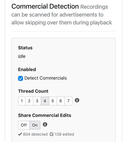

We’ve made a big improvement to how we collect commercial edits to streamline the process for the future.
Please update to the latest pre-release:
and then go to the Live TV & DVR settings and enable Share Commercial Edits:
This will automatically share all edits that have been made and any new ones as they are done.
Done!
As of this latest build it is no longer required to run Generate Media Fingerprints. It will be handled as part of the process of sharing commercial edits.
All that is required now is to enable the Share setting. Looking forward to seeing this data. Thanks everyone for assisting us in this endeavor!
