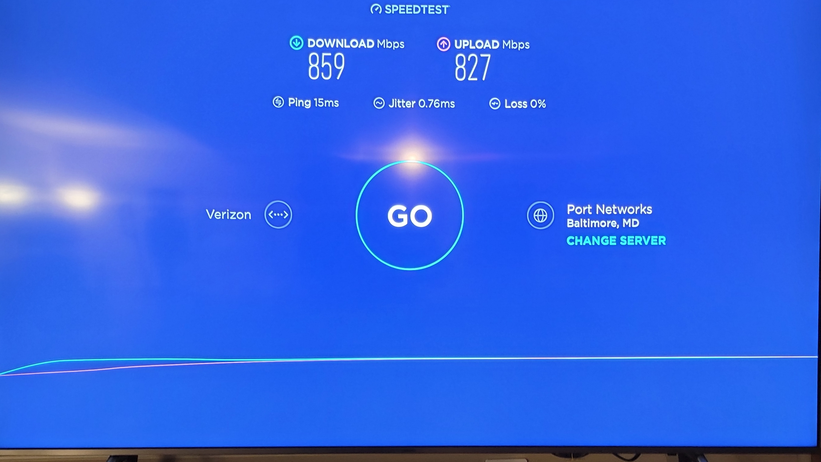

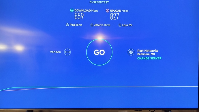

Well that is hadwired at gigabit speeds and if I depended on my wifi in my basement to carry to the upper level I would be out of luck. I have top of the line hardware and no issues with anything else. I run moca in several areas and the rest is Wifi and have 4 Apple TV. I run MoCa 2.5 and WiFi 6.
While wired Ethernet is the best, MOCA is 1000% better than WiFi, hands down.
Honestly I would bypass it as a test with a long ethernet cable stretched through the house to your router. If the problem goes away then you have found ur issue. If it's the same then you can move on to other troubleshooting.
I have MoCA 2.5 from the basement to upstairs and get 1000 speed never had a problem.

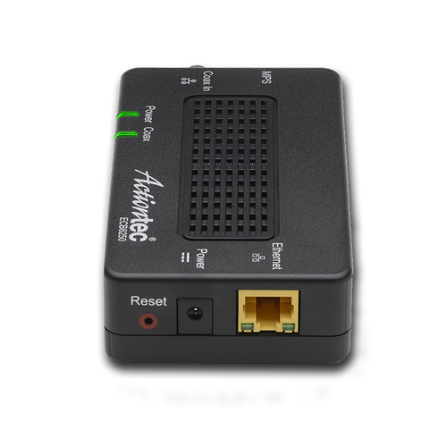

If it happens every morning after waking the ATV, try pinging the ATV from the server before you wake it to see if it's connected and responds. Could also be the ActionTec MoCa adapter goes to sleep when your ATV does. The adapter should have a green coax led and the activity led on the ethernet jack should show activity.
It's most likely the adapter but leaving the Apple TV always on is OK and they are made to stay on anyway to display photos or screen savers. But I will run a test with direct Ethernet to isolate the issue and see if it's the ATV that takes longer to reconnect at wake. I already tested the ATV with WIFI and it seams OK. If its the ATV or the adapter they are still under warrantee anyway. I have no issues with the other 3 ATV's.

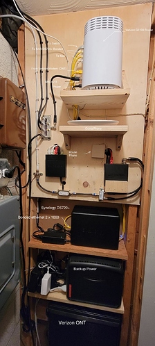

I have two locations with MoCa 2.5 one though my Verizon E3200 extender also a ATV on it and the Actiontec MoCa 2.5 adapter like the one show in above post. The ethernet connection from extender also gigabit to the ATV had no issues at all. The picture is my basement setup as you can see the MoCa coming from the router. I don't have cable anymore so the other coax is the antenna going to the two SiliconDust tuners. I also have a small ethernet switch to connect all that's on the picture (tuners, Ooma, Nas DS720+ and below not seen a windows 10 server. Below the Nas is a power backup and the Verizon fiber below that. Last thing I need to do is cap the open coax on the big splitter but it's only Moca so I don't think it affects it but good practice or replace with a 2 way since the 3rd coax is not in use.
Nice setup mine is a total mess lol but it works.
It started messy but thanks
cap those open ends in the splitter
Nice advice I have them on order on Amazon I will get them on Sunday. Right now I have a 2 way on that I installed till I get the caps.
