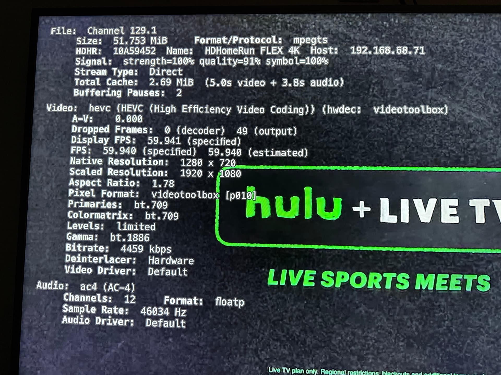

Just came to add that my local channels just added the 12 channel 7.1.4 audio as well, and Channels is working fine with this format. However, on ATV bitrate info isn't displaying.
