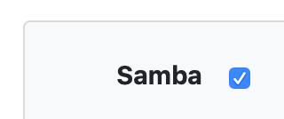

Just check the box
then go and download it onto the rpi and configure from there? I guess I need to do more research
does the dvr server img on the raspi let me download samba on to it as well?
There's nothing you need to download. What are you trying to achieve?

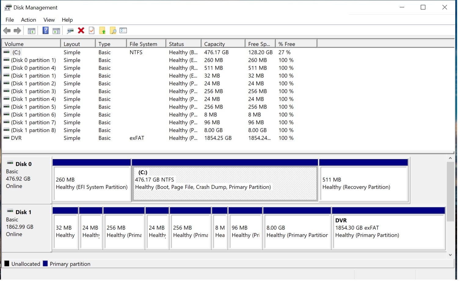

I am migrating from a Windows 10 DVR to the dedicated RPi4 image and after setting up a basic DVR on the PI and shutting down I am moving the external WD Passport HDD from the PI to my Windows machine in order to copy my current DVR to external drive and it is not showing up in file explorer on Windows so I can't copy my old DVR over, unless I use SAMBA and I don't want to go with that.
Before imaging with the USB Boot Image the drive was visible in Windows as Drive D: and formatted exFat, now it has several partitions, the last one being exFat but nothing shows in File Explorer.
Any ideas how to get this drive to be visible to Windows again as Drive D: ?
(And, just curious what do the first 8 partitions do?)
