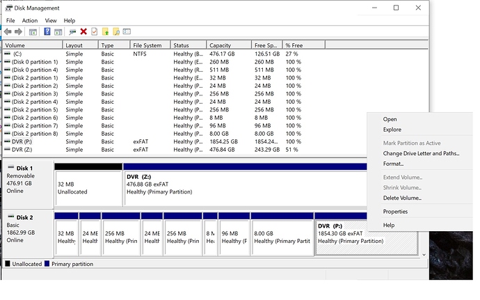

Huh that's a strange one. Can you double click or right click on the dvr partition to make it mount?
Is my "invisible" exFat partition on Windows the same issue that was reported back on Oct. 16 and 17? Is this something the install itself can fix rather than using Gparted post install?
No. If it shows up in the Partition Manager (like in your screenshot) then it is not invisible. It's not being mounted for some reason which is not apparent. Can you try on a different machine maybe?
Where is the data you are trying to migrate? Is it a directory on the C: drive or is there another drive in play?
I didn't try a different machine, but I did follow your suggestion to right mouse and then was presented an option to "Change Drive Letter" and I choose "P:" and that seemed to work and make the new Linux formatted exFat partition visible to Windows File Explorer, so now I can copy / migrate files from my Windows PC to this USB drive (mapped as P:) and then back to the RPi4 to Restore.

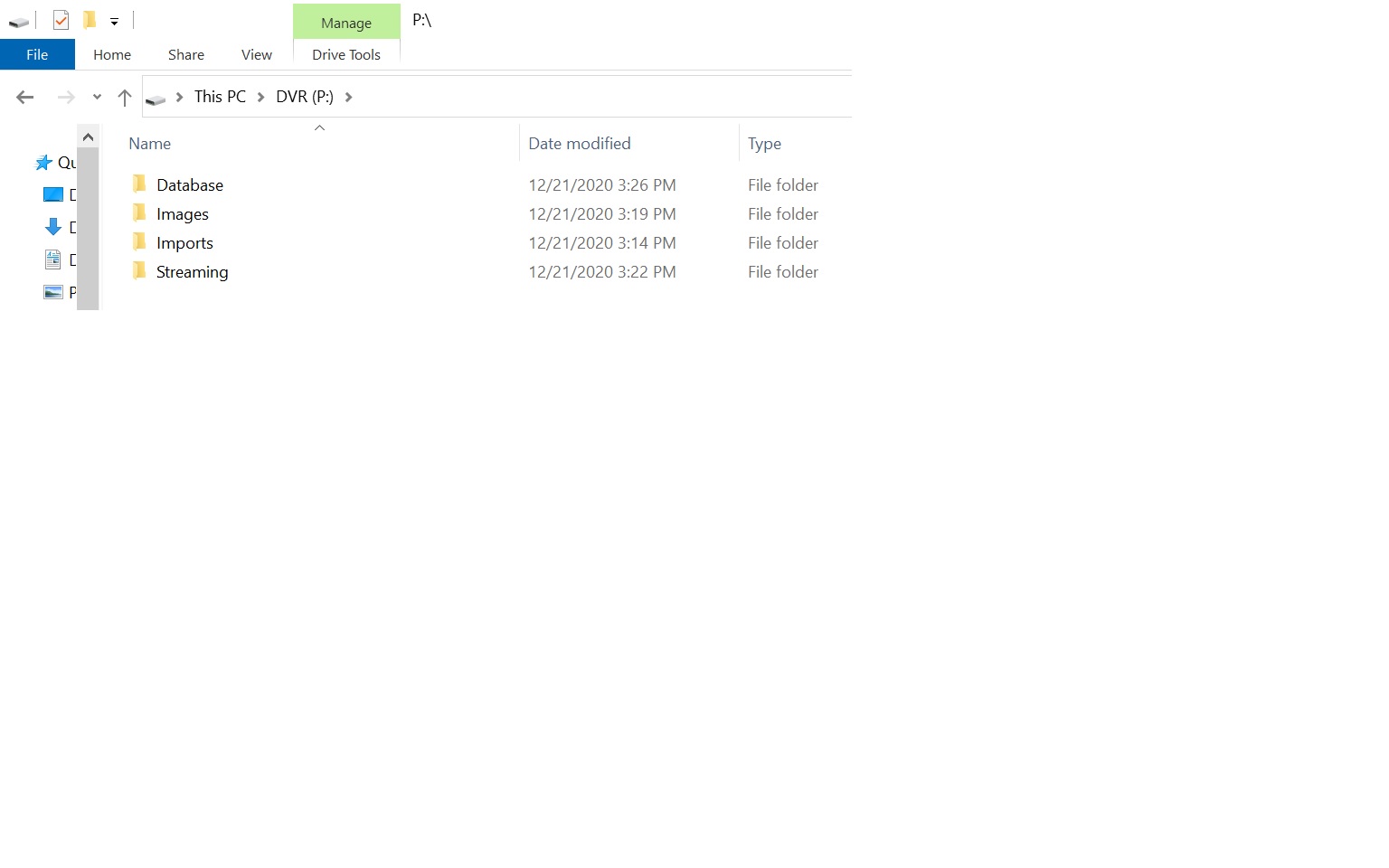

Here are the current contents of P: before copying any old DVR data over.
