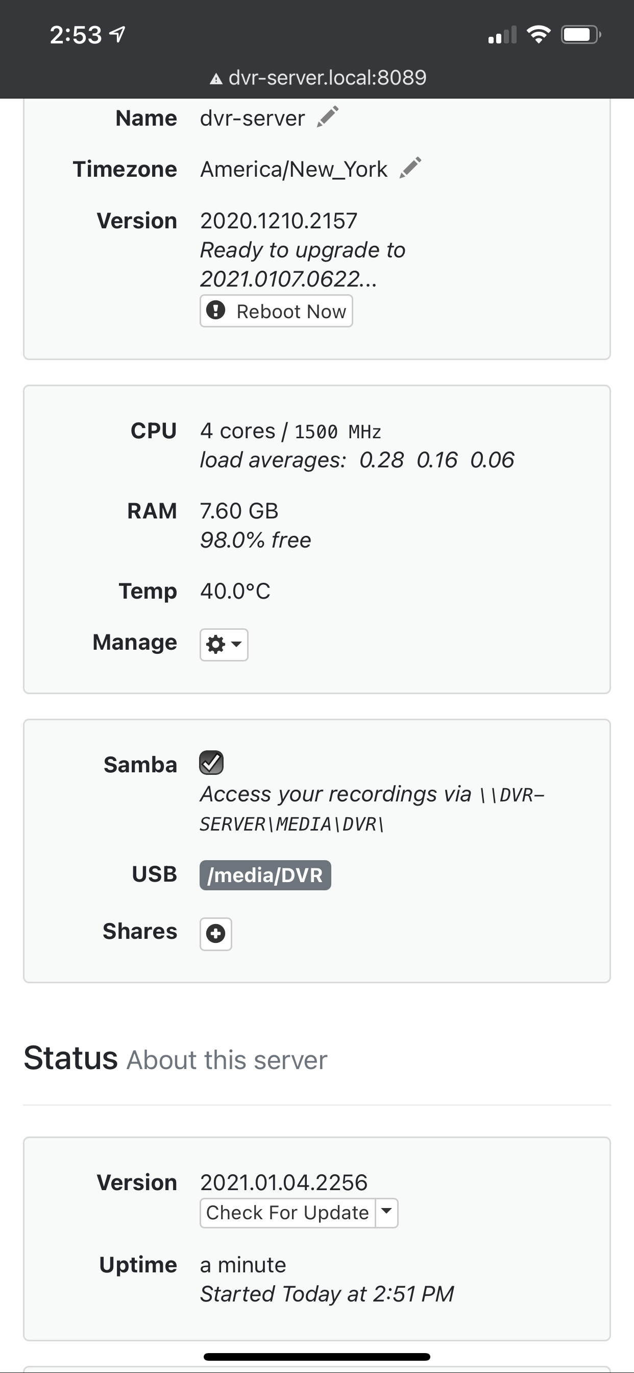

I updated to the newest OS prerelease, but the admin page will not load and it doesn't seem to be coming back online. I powered it down completely and then tried turning back on and the same thing - it isn't coming back online.

Coming online as in you can't ping it, ssh to it, or open the dvr web UI?
All three. And the app can’t find it either.

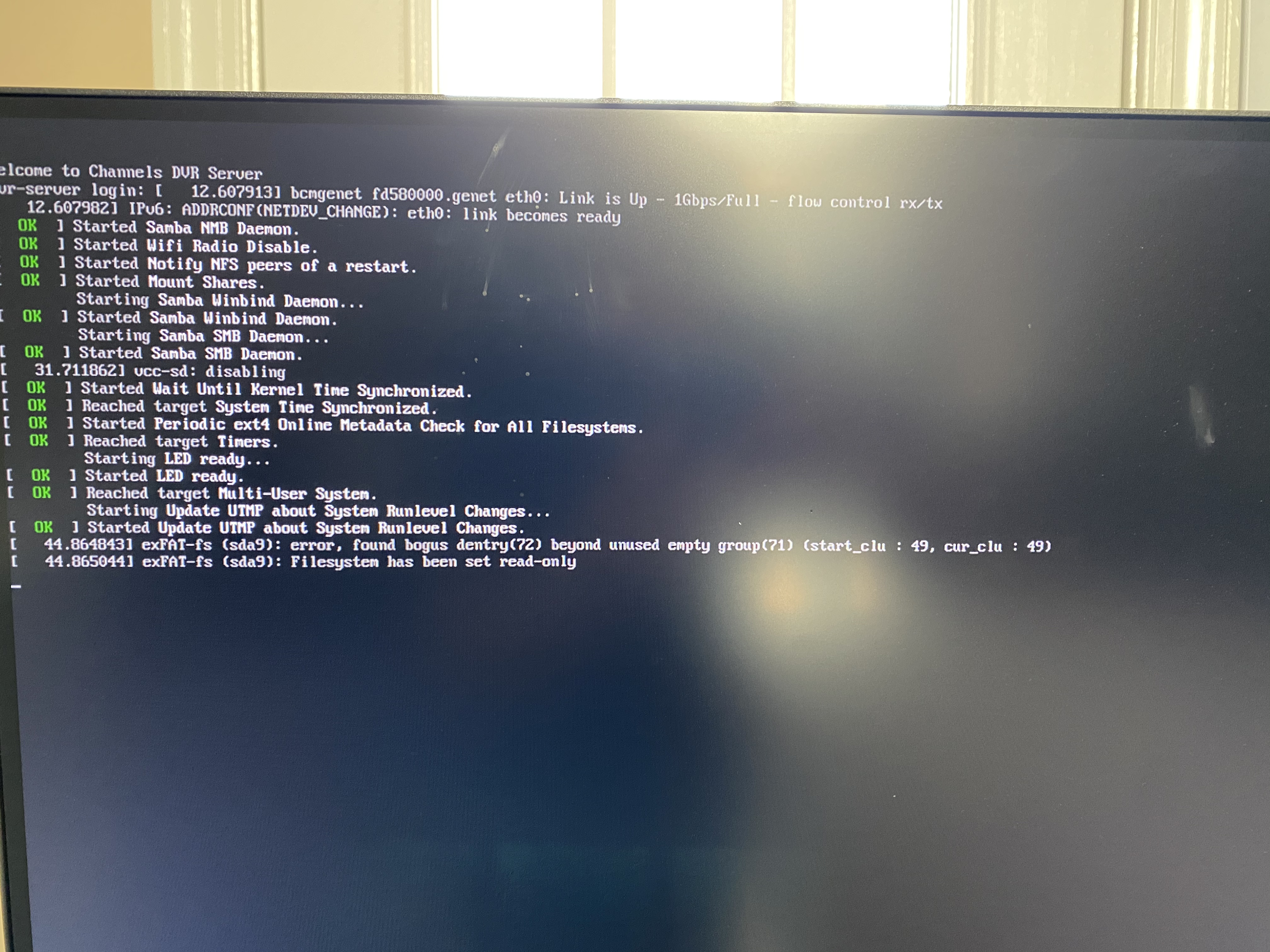

Do you have a micro-HDMI cable you can use to see what's shown on the screen when it's stuck? What is the green LED on the front doing?
