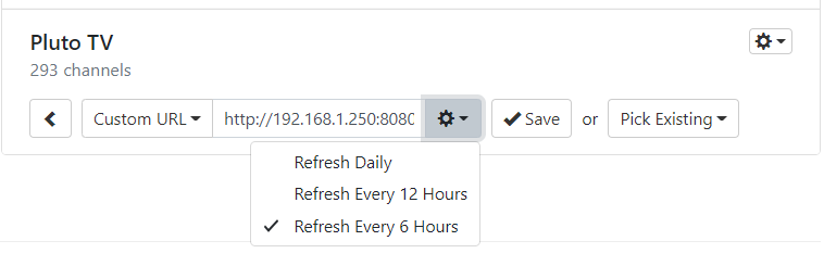

I had the same issue. Try this:
Go to the Basic Setup then to your Pluto TV source. Click the gear menu and choose 'Guide Data - Change Provider'
Then when that is open choose the gear that appears. There you can choose a setting to update the guide data more often.
Here is what mine looks like:
D'oh!! Every single time I looked at that, I just saw the trash can and my brain said "use that to delete Pluto", instead of "read the text next to the trash can". Thanks. That will probably fix it. Now, if I can just figure out how to integrate my Ring camera into Channels. :sunglasses: Love this community!!! Love Channels!!!
