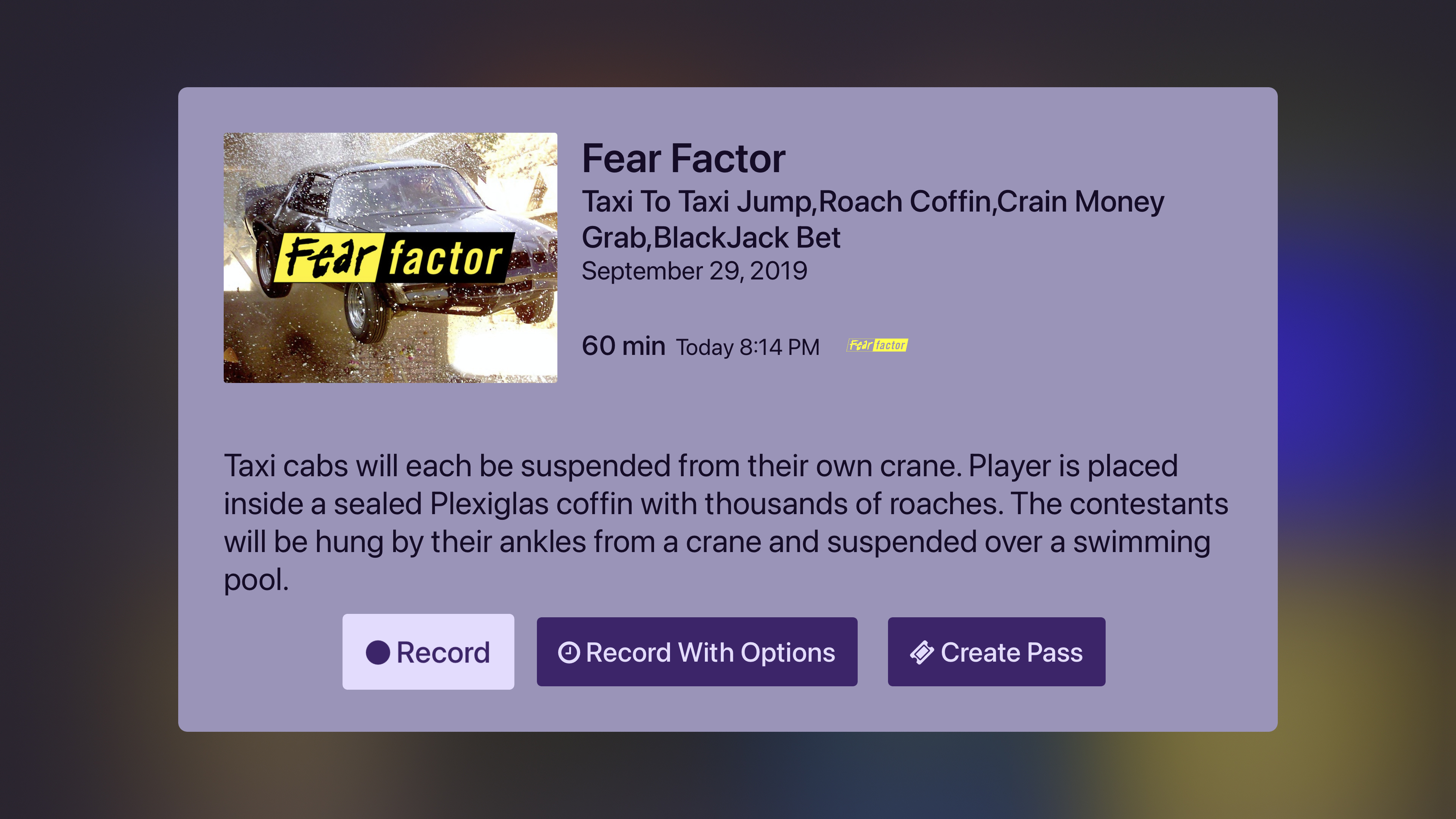

Hey guys, I'm working on the tvOS/iOS app to make it play a little nicer with custom channels. This means handling art more gracefully as well as handling things a little nicer when there's no art, or no guide items.
The first results are up on TestFlight now. It's mostly changes that help when a channel has custom guide art attached to it. This way you get art, since most EPG data has no art for shows.
You can see some of the results here using Pluto art.
If you really want to craft an experience with custom channels, you should pay attention to our M3U tag extensions.
With these, you can make Channels look its best using your custom channels. If your channels don't have guide data, using our extension tags, you can set default meta data like Title and Summary info, and most importantly, give your channel default art so it looks great like the screenshots above.
