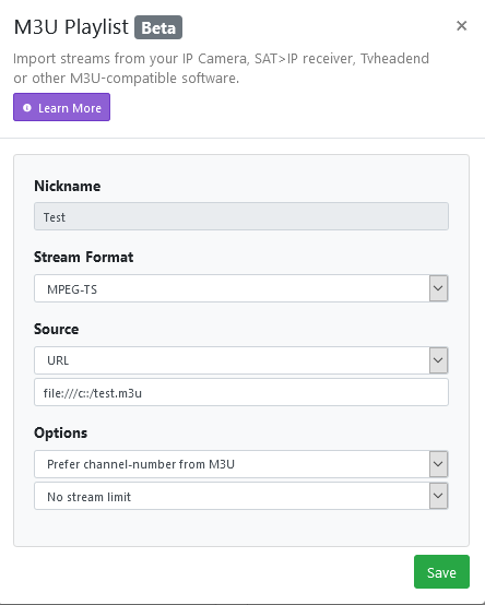

Instead of using the gui text option for entering an m3u, I'd like to use a URL and point it to a m3u file on my hard drive. I've tried a few combinations of syntax that should meet the file URI scheme for Windows, but the channels are not being read from the m3u file. 1. Can channels read a local m3u using the URL option? and 2) if so, can someone point me to the correct syntax for Windows?
In my test, I have a test.m3u file residing on the root level of my Channels DVR (Windows) server.
Thanks,
Tim
Edit: Found this in the log file, sounds like this method is not supported (yet): 2020/11/18 14:31:19.319664 [ERR] Failed to request m3u: Get "file:///c::/test.m3u": unsupported protocol scheme "file"
sad face.

No. But I have added a new File option in the next build.
