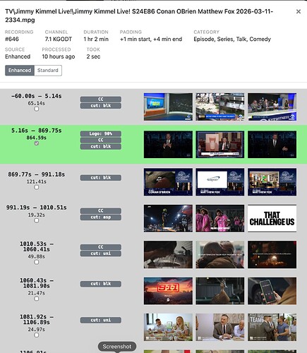

I looked at a recording of Jimmy Kimmel Live! from last night and the cuts were perfect. Toward the end there was a large commercial block with a 23 second preview of guests coming next week in the middle of the commercials, and Enhanced nailed it while standard commercial detection marked the whole thing as being part of the program.
I do have a feature request for the Edit Commercials UI. Would it be possible to freeze the top frame to make it easier to compare Enhanced and Standard edits? It would be nice to scroll down and compare edits without having to continually scroll back up to toggle between Enhanced and Standard. Alternatively, perhaps everything in first frame could scroll off the screen except the Enhanced and Standard buttons.
Another option would be to have a "compare" option that would show what each method identified.
@DavidP Go and edit the commercials to be what you see as accurate, then hit Save. Once you've done that, when you select Enhanced and Standard it'll show you an additional icon next to each segment that tells you what you picked so you can see what is accurate vs what they selected (in green).
