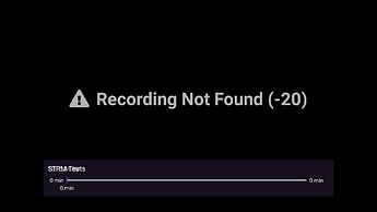

Okay, after the last fixes in the latest version, some of them play, but not all of them. I have confirmed all of the links are real and working, but I get various errors:
It does not appear to be a "file type" issue because I can get the Apple MOV file to play with no issue, but a different MOV file throws one of these errors.
Also, there appears to be some weird overlapping going on with the text on the playback bar in the left corner:
