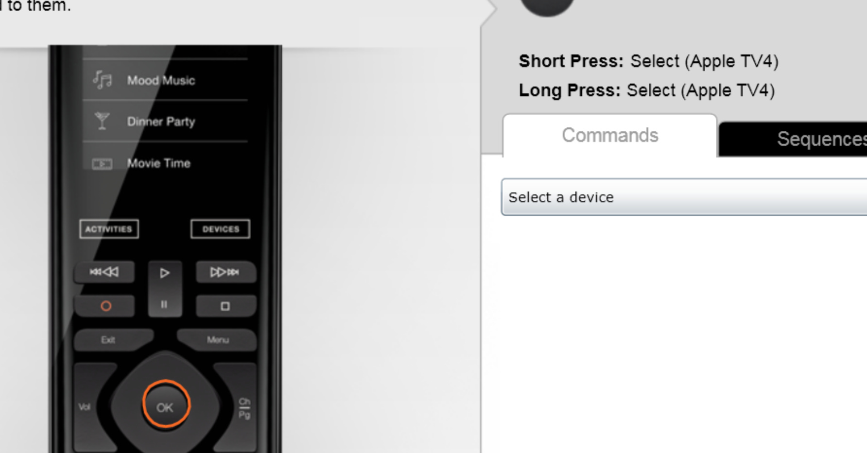

here is a screenshot
the OK button is mapped as the select command for the appletv remote

Ah ok sorry, sounds like @maddox was able to reproduce it. I don't have a harmony remote so I'm not sure. I'll try with a regular IR remote and see .
We're using a standard tvOS button, the same way we do all over the app. All the other buttons work but this one doesn't, which is not making much sense.
