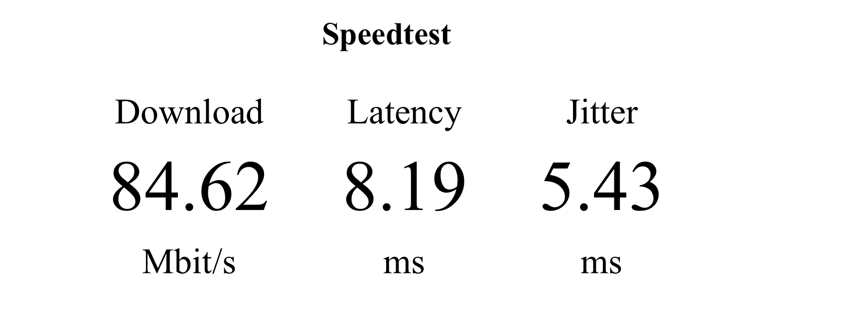

I just submitted them while operating iPad on cellular. Closest to the remote internet in result even though the remote internet was actually faster.

The download speeds that I'm seeing do not in any way match the speedtest you posted. That speedtest was run from outside the house?

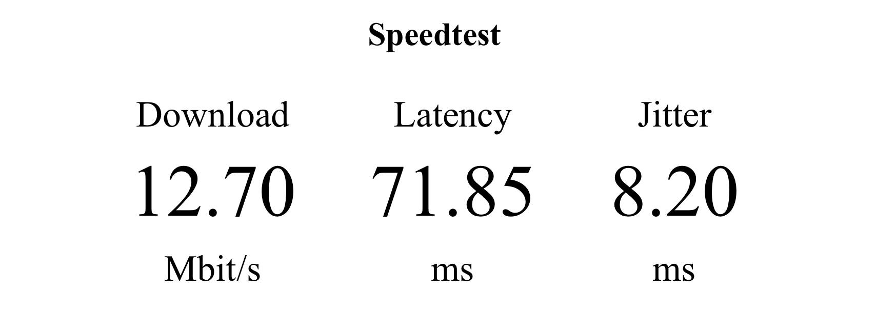

Yes, what’s strange is that the speeds seems to vary wildly but only with channels running. In the house it works pretty much flawlessly. I will see some issues with recordings missing a second or two but this is the first time I have tried outside the home network. Both AppleTV and IPad had issues playing TVE and HDHR. This is another Speedtest I did just after the other one.
