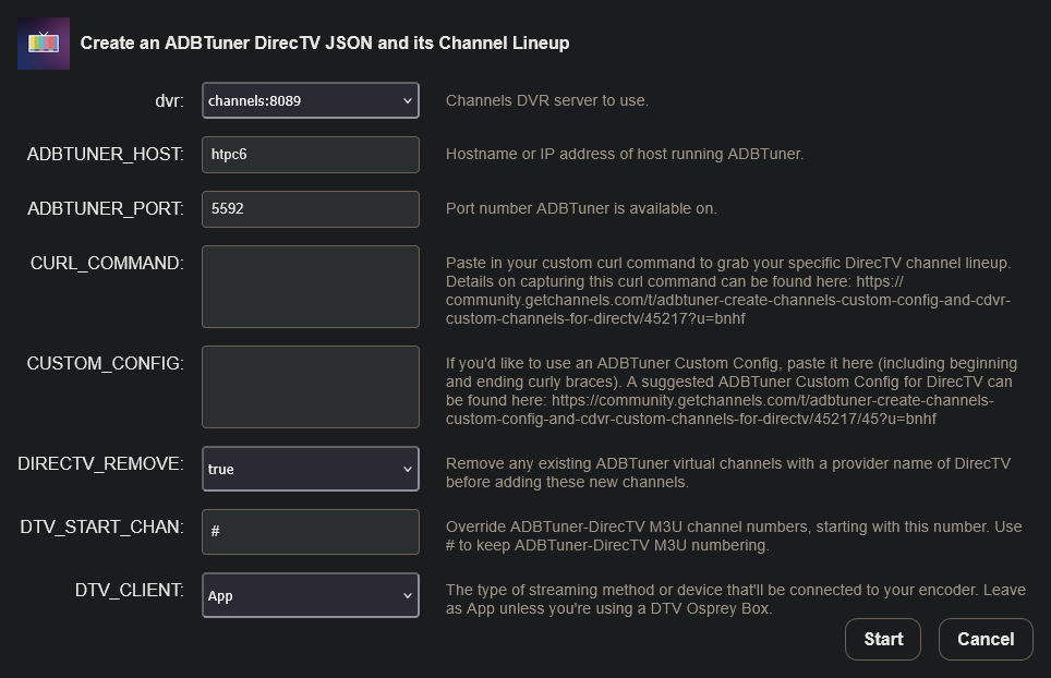

Both ADBTuner and ah4c work very well with the Osprey boxes. Another unique thing about Osprey boxes is they can tune using channel numbers rather than deep links, which is extremely unique and not common on any other device. So, if deep linking were to break, sending commands using bash and ah4c to input a channel number is possible and quite durable.
ws-scrcpy is also useful for remote management and great work was done by @bnhf to get this working for ADBTuner and it's built in to ah4c.
I would say for those who are looking for the easiest management, go with ADBTuner. For those who have an soft spot for open source or are looking for something a little bit more interesting to tinker with, go with ah4c. I think both have their place and have their advantages and disadvantages. ah4c can only tune one app per container but is heavily extensible through bash scripting. ADBTuner can handle multiple sources but is not as easily automated as it is limited to it's json based configuration process which while extremely well designed cannot replace bash entirely. I think both have their place.

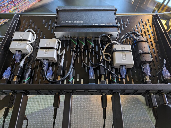

I have 10 Osprey boxes (for giggles, not that I need 10) and 2 LinkPi ENC5-V2 encoders. I would suggest going with the LinkPi line, most seem to prefer those and after trying a Uraycoder and a no name it's very clear why. They do work well right out of the box and are super easy to maintain. I suggest buying from Amazon or the US Distributor YouYeeToo.

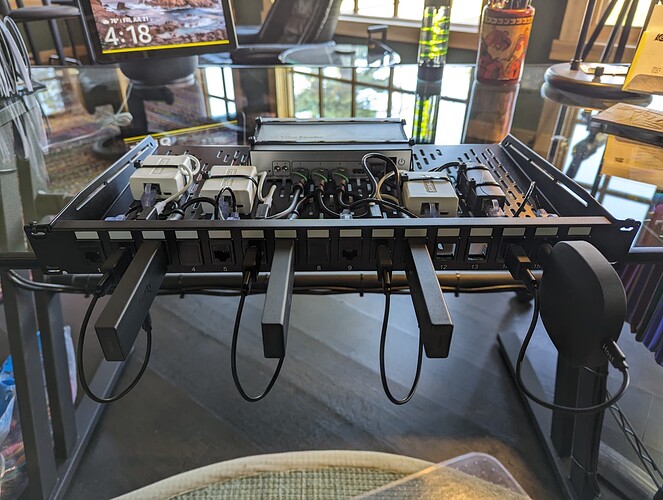

    Heh I've got a real mishmash, my IPTV 'cable' provider uses Android STBs so I can control both of them with ADB and do direct channel tuning via numbers. They are hooked to two different HDMI encoders that I got at different times. But they only give us two of them included with the package and I wanted more tuners, so...

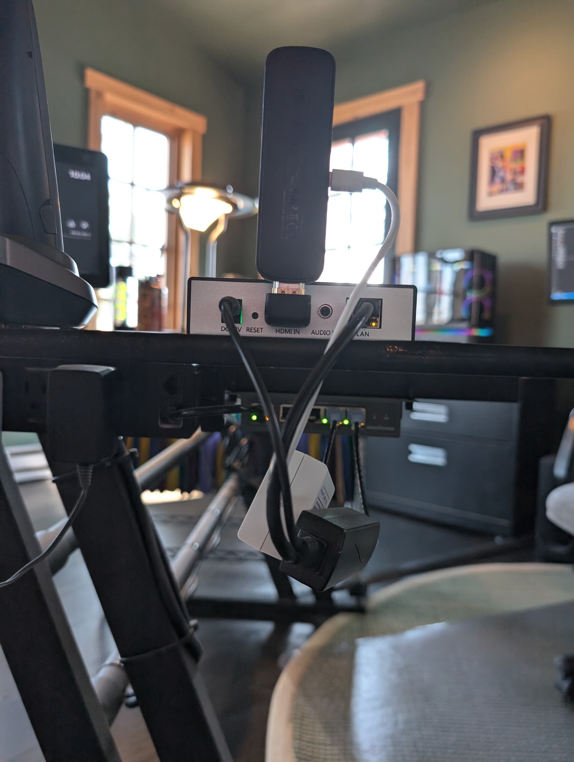

I also have an ONN 4K and a fire stick 4K Max that I use to run and control native apps. Onn is hooked up to a URay HDMI encoder and the fire stick is hooked up to a super cheap USB capture device ($12). Channels does the hardware encoding for that one via DirectShow capture on my Win11 server.

Regarding hardware, the 4 port HDMI encoder has been the most critical device to have, providing a quantity of inputs and being able to migrate from various input devices and DVR software. That one device has been essential to the success of keeping a home DVR running. The downfalls are no CC and no 5.1 channel audio.
