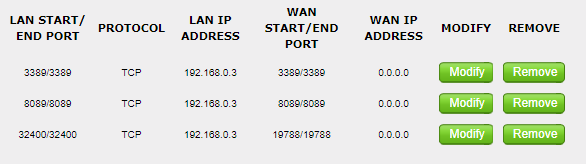

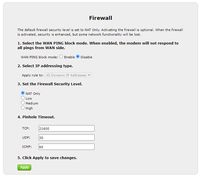

This is almost always a firewall issue on the inbound. But without more information about your network we can't really help you out. I was receiving the same error until I turned some nat features on my pfsense router. I already had the port forwarding turned on. You will need to enable port forwarding on your router and point to your server with that port. Depending on your OS.... Will depend on if you need to do this with a software firewall too.

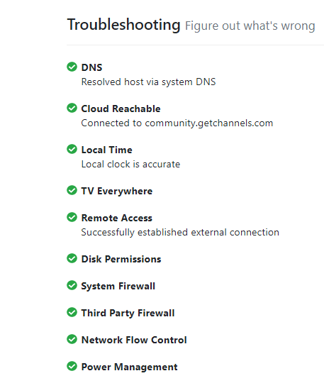

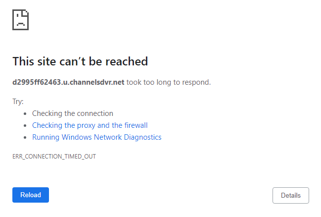

So I assume the first screenshot is made when connected to the DVR locally on your network, but when you try away from home you get the second error. Is that correct?

Router
This is correct....
What URL are you trying when accessing away from home? My.channelsdvr.net?
Yes, my.channelsdvr.net.
What device are you trying from and what kind of internet connection?
I've tried from a windows pc, android TVs and a iPhone and none will connect remotely. 15 Mbps DSL.
Interesting. First guess would be the ISP is blocking the traffic for some reason. Does the iPhone have cellular data? If so, does it work when going through the cellular network?
Ive been so confused because I believe I have set up everything correctly, iPhone will not on cellular. Everything works on the network correctly. Surely the ISP wouldn't be blocking it...

Did you turn windows firewall off just to try?
Yes and still unable to access.
