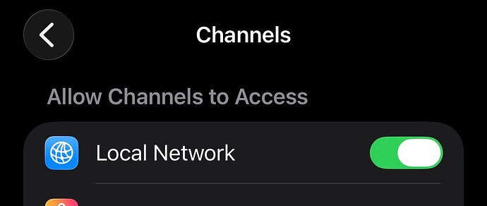

Check iOS settings maybe
@tmm1 Already had checked that. Network access is allowed.

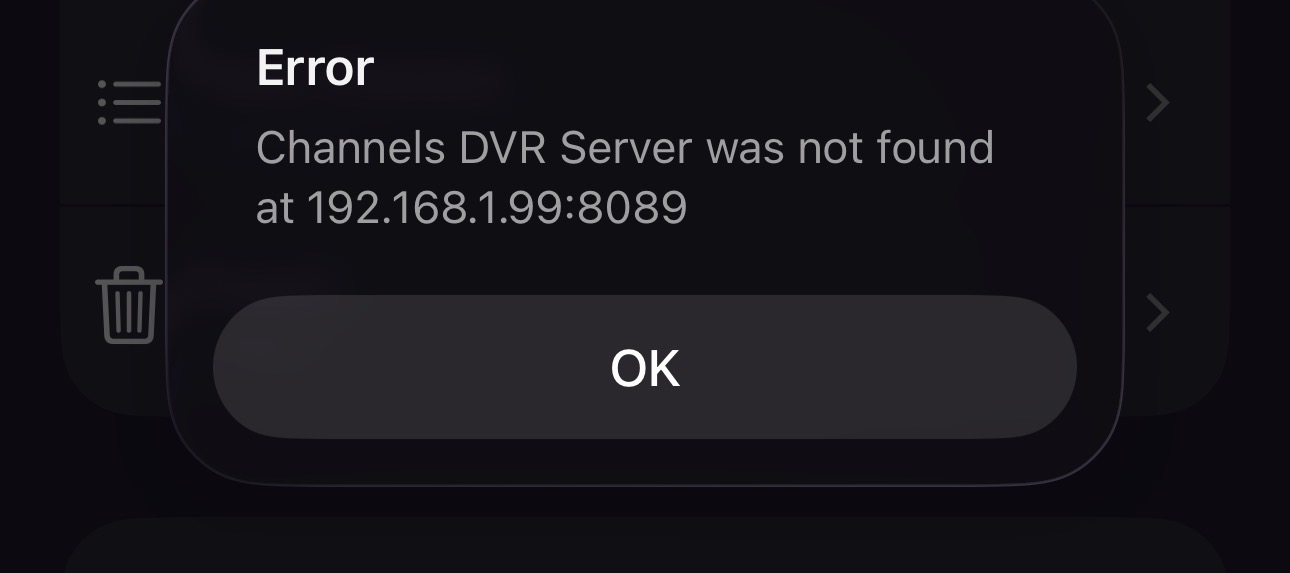

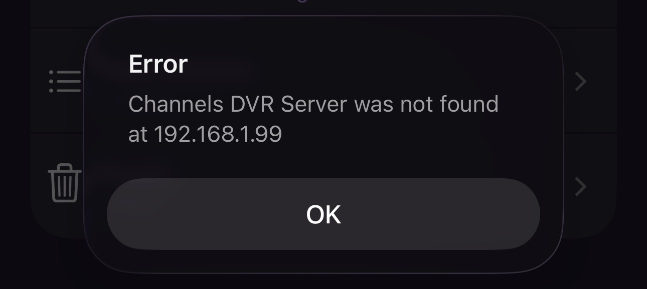

Can you screenshot the error when you put the IP into the app?
Isolation IS off. Confirmed.
Re-downloaded the app on all devices. No change.
I just get the “Server not found” screen. With or without port number.
