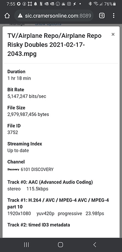

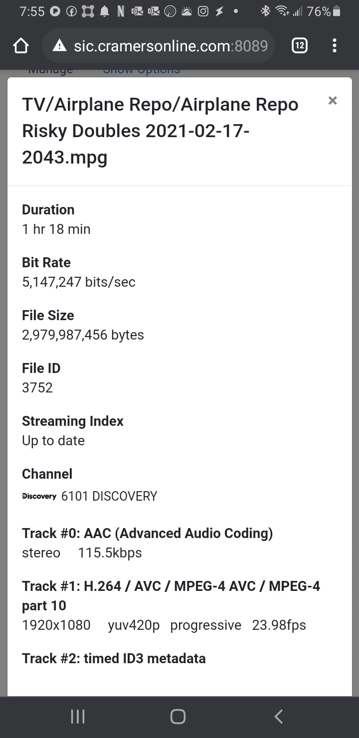

@scottuf Good call, I recorded the end of a TVE show I got sucked into last night and sure enough it's got the same issue in the beginning. I deleted the OTA example so I'm trying to remember which one and restore it to get better data. @tmm1 your stuff is epic! I didn't even know about all those awesome webui features. The comskip details are awesome! The view details is attached if it helps, please don't judge it was an impulse watch. The skipping happened in the first 30s of the recording.
