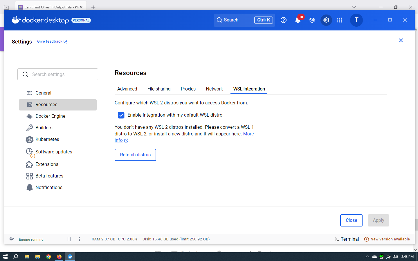

Also, can you confirm that you have a default distro like Debian or Ubuntu installed, and that you have "integration" with your default distro enabled in Docker Desktop?
I don't know what these are or where to get them.

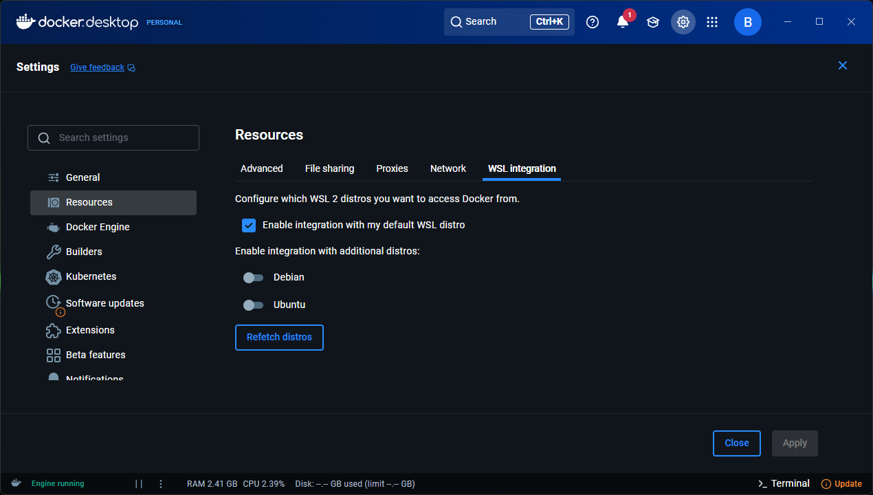

In Docker Desktop Settings-Resources-WSL Integration, things should look similar to this, though you'll probably only show one distro installed:
This is what I have for distro.
How did you get OliveTin EZ-Start installed, if you don't have a Linux distro installed?

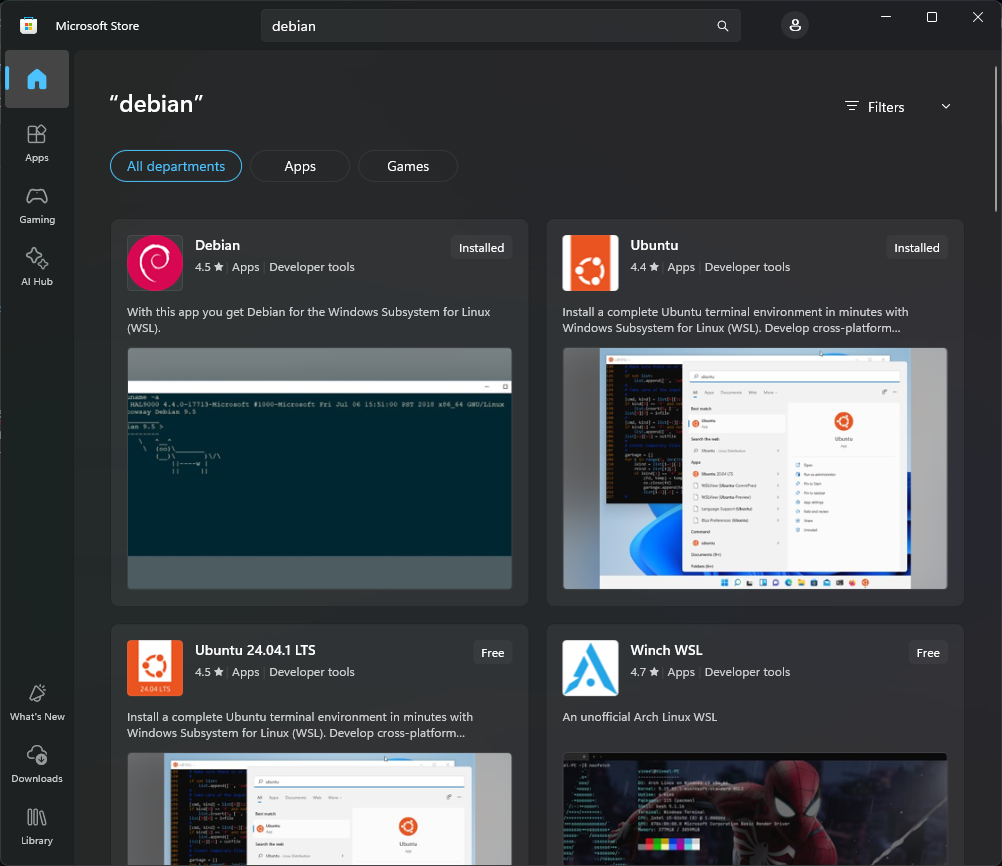

Debian or Ubuntu are available from the Microsoft Store:
He is probably on WSL 1. I think that is default on Windows 10. Updating to WSL 2 shouldn't be too hard.
