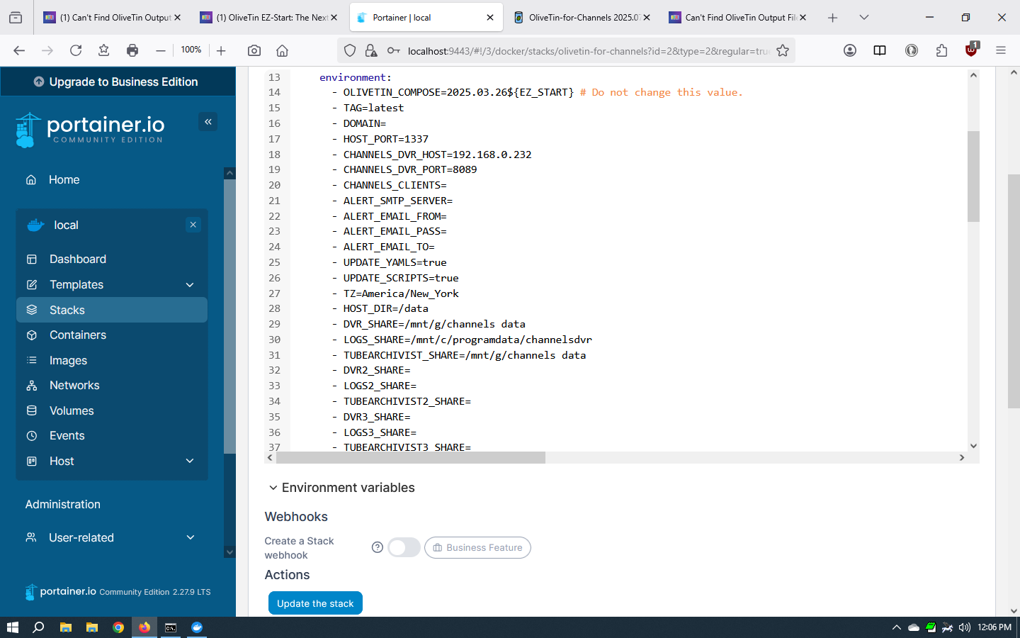

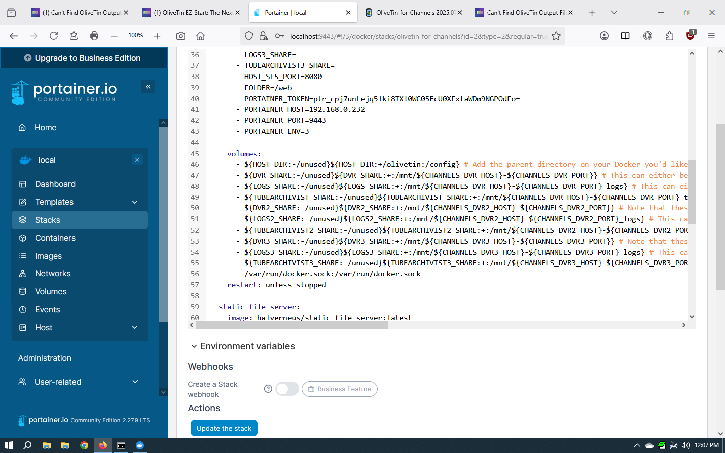

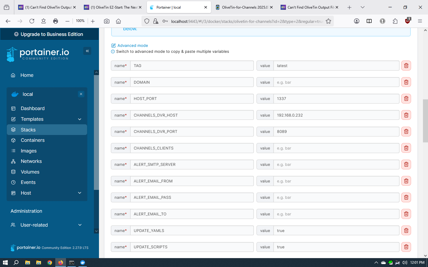

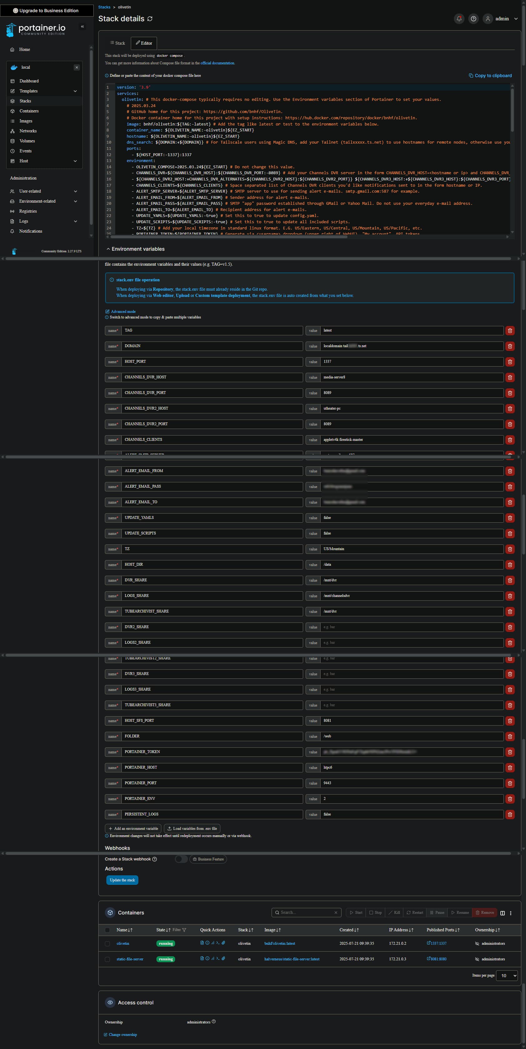

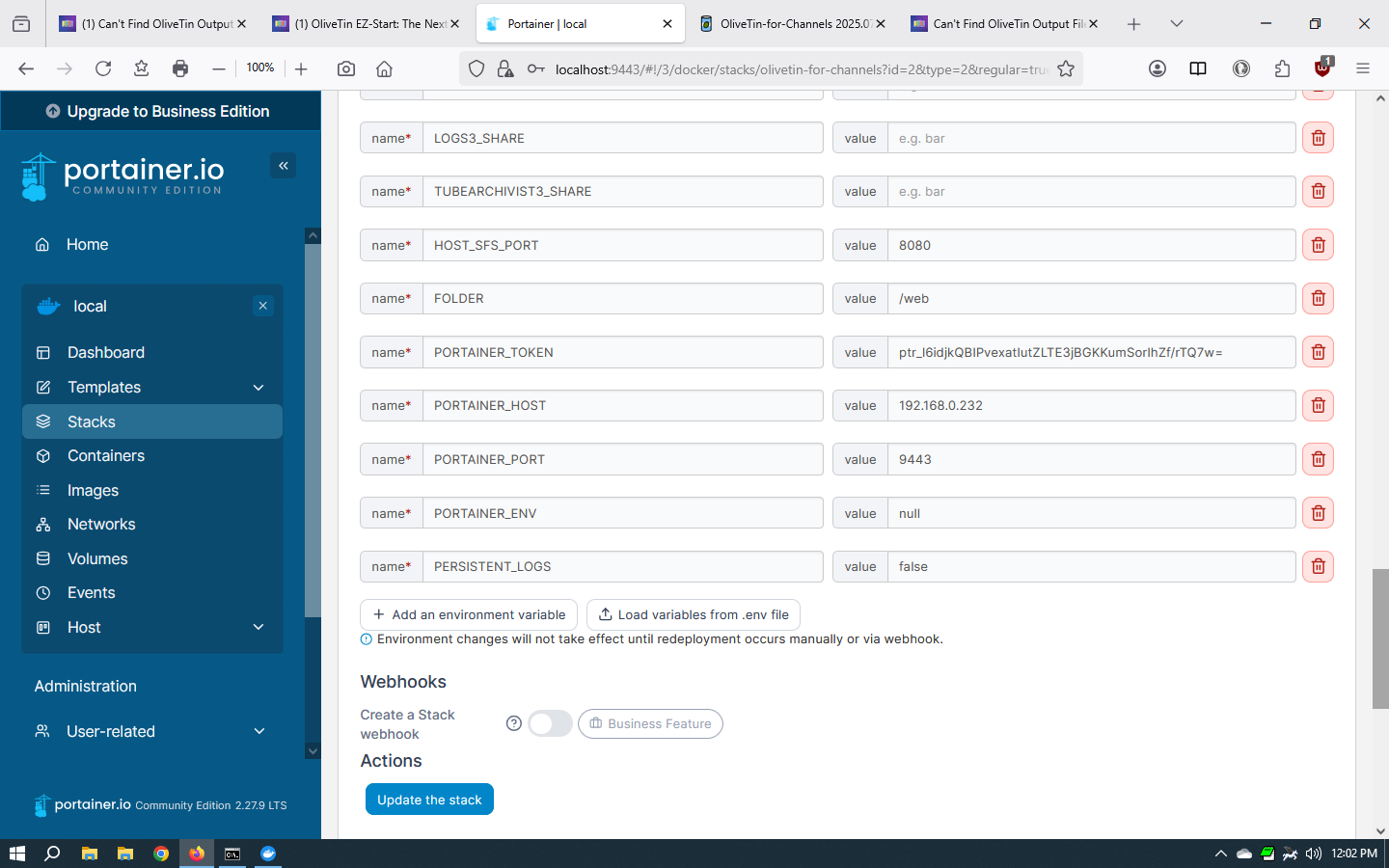

Can you post a screenshot from the OliveTin stack in the Portainer-Stack-Editor, showing the environment variables? It should look something like this:

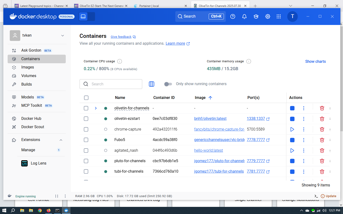

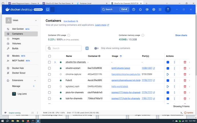

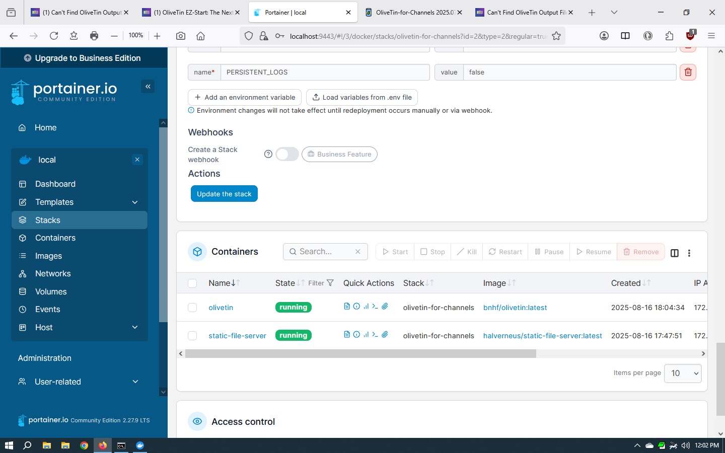

Am I supposed to have two Olive Tins running in docker?
@TV_Ken

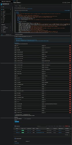

OK, so you've mistakenly edited the compose itself, however as it says in the comments at the top of the compose:
version: '3.9'
services:
  olivetin: # This docker-compose typically requires no editing. Use the Environment variables section of Portainer to set your values.
To fix this you need to stop the OliveTin stack, and paste in the current compose. This is designed not to be edited, as any values specific to your installation are reflected in the Environment variables section:
Here's the current compose from this post:

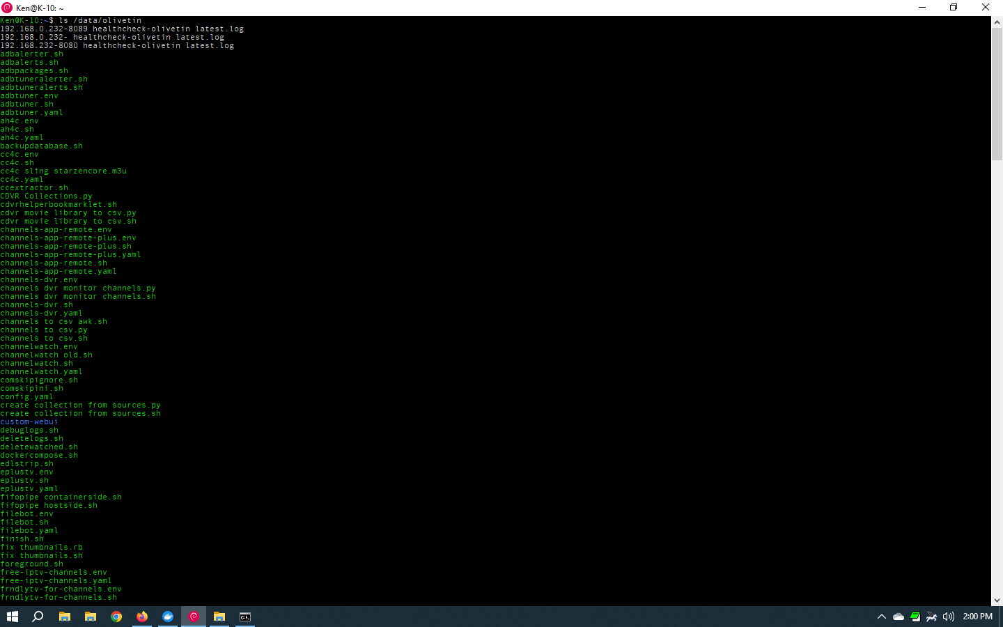

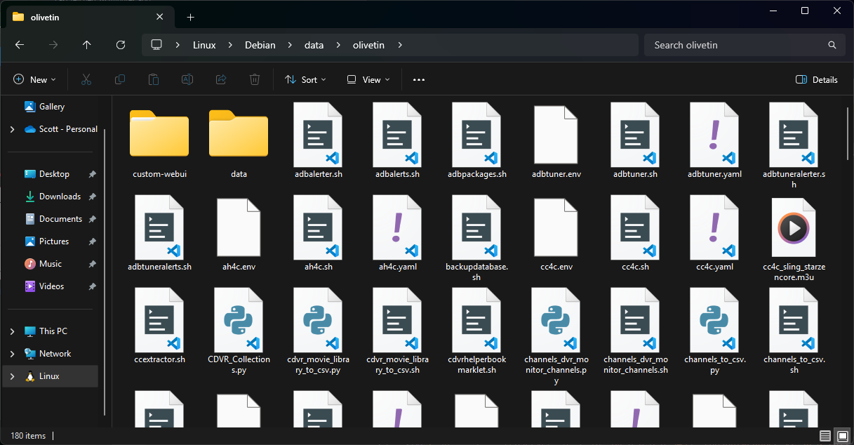

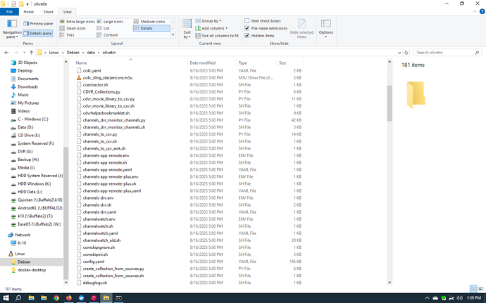

There are several ways to find /data/olivetin, the first is to use Windows File Explorer:

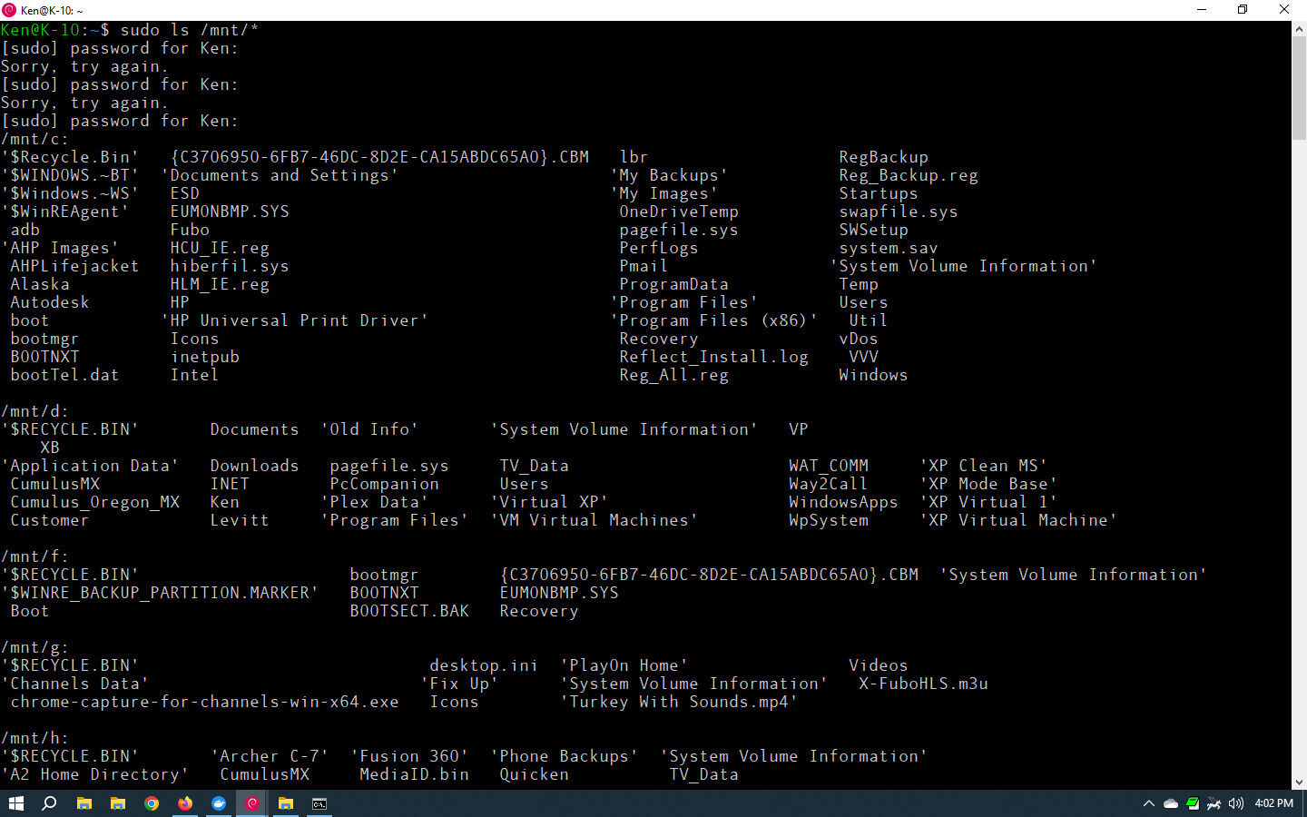

The second is to use Windows Terminal connected to your Debian distro and do it from the Linux command line:
And, I would imagine there are other options, but those are the two I use...

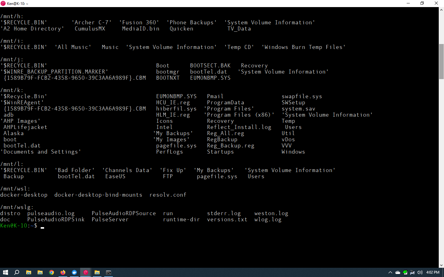

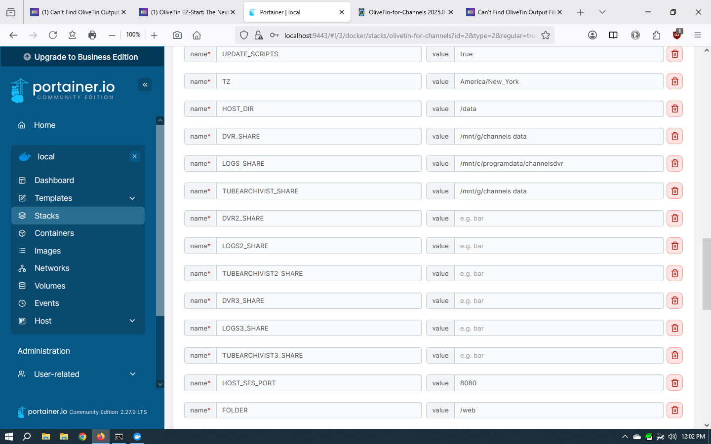

My environment variables are set to:
HOST_DIR=/data
DVR_SHARE=/mnt/g/channels data
LOGS_SHARE=/mnt/c/programdata/channelsdvr
I followed both of your examples, but the CSV file just isn't there.
See attached screen shots.

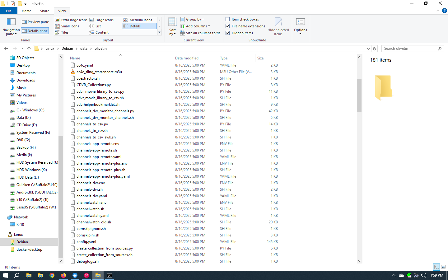

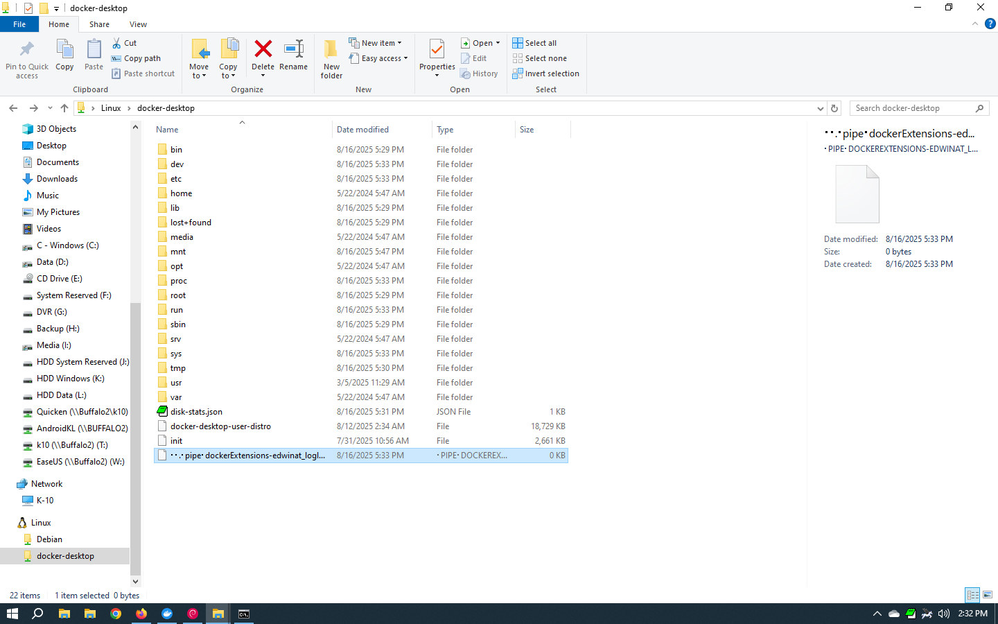

In Windows File Explorer, check under Linux/docker-desktop and see if there's data/olivetin directory there...
No "data" folder under Linux/docker-desktop.
Can you try " Create Channels List in CSV Format" on your system and see where it ends up?
I did that earlier, and it's in the /data/olivetin directory as expected:

You can see from this section that your Windows filesystem is not accessible from Debian, as none of the folders called out in the comments are visible. This is probably causing us problems the other way around too.
Let's try this -- from the Debian command prompt in Windows Terminal, run the command shown and post the output here. It should look something like this:
slayer@NUC12-PC:~$ sudo ls /mnt/*
[sudo] password for slayer:
/mnt/c:
'$GetCurrent'   'Documents and Settings'   OneDriveTemp           Recovery                     VMS_DOWNLOAD
'$Recycle.Bin'   DumpStack.log             pagefile.sys           swapfile.sys                 VMS_RECORD
 AMTAG.BIN       DumpStack.log.tmp         PerfLogs              'System Volume Information'   Windows
 apcupsd         hiberfil.sys              ProgramData            tmp
 BlueIris        inetpub                  'Program Files'         Users
 Config.Msi      install.txt              'Program Files (x86)'   VMS_CAPTURE
/mnt/d:
/mnt/dvr:
/mnt/wsl:
docker-desktop  docker-desktop-bind-mounts  resolv.conf
/mnt/wslg:
distro  pulseaudio.log     PulseAudioRDPSource  run          stderr.log    weston.log
doc     PulseAudioRDPSink  PulseServer          runtime-dir  versions.txt  wlog.log
Here it is.

Believe it or not, I've seen this kind of subtle corruption in the Docker Desktop for Windows integration with WSL before (particularly in Windows 10). I know how to fix it but it requires resetting Docker Desktop to "factory", which I don't think either of us really wants to do.
So, let's try using Windows paths for OliveTin instead of Linux paths. You'll need to stop the OliveTin stack, and then in the Environment variables section of the Stack Editor change the following values to those shown here:
HOST_DIR=G:/data
DVR_SHARE=G:/Channels Data
LOGS_SHARE=C:/ProgramData/ChannelsDVR
Yes, the forward slashes are correct. :slight_smile:
Click Update the stack, then try running the Action again, and see if the output can be found under G:\data\olivetin along with all the other OliveTin scripts and files.
