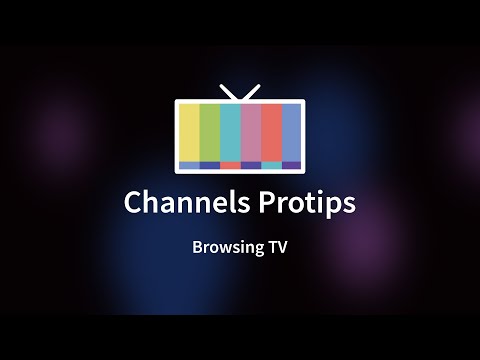

This video is a little old, but gives you the idea:
I washoping I wouldn't need to discole I am blind.
I appreciate the link.....but when I click on it, it plays about 5-8 seconds then stops. Obvs I am unable to see the video.
