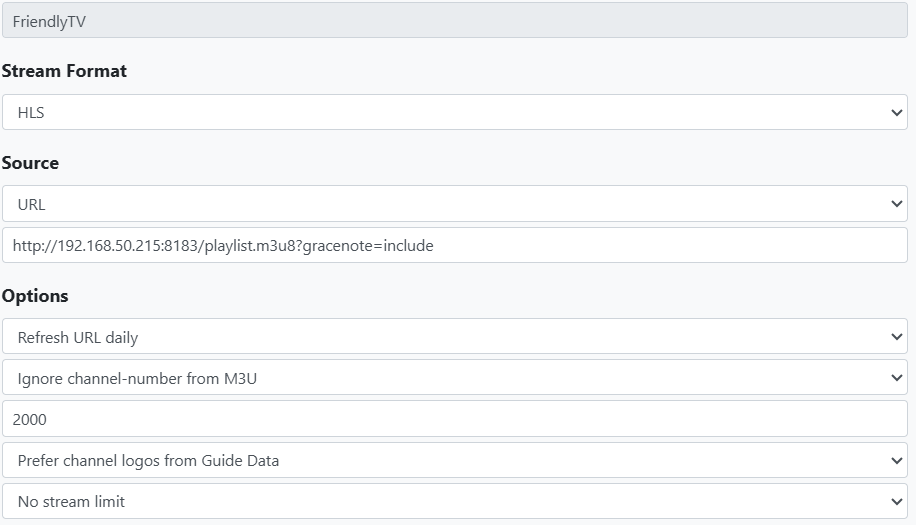

When you defined the M3U did you tell it to ignore channels numbers and start with 9000 ?
Example ... mine start at 2000

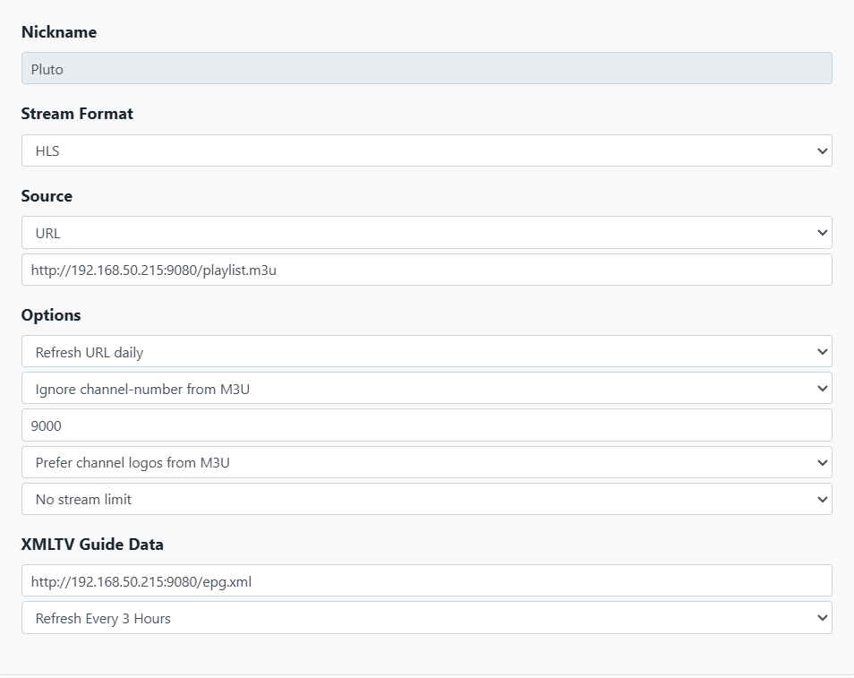

You might have Pluto or something else using 9000.
nothing else is at 9000. I used to have other m3u sources enabled but have long since removed them. I now have a gap in my channels from 8045 to 13302. My guess is they still exist in some unknown database somewhere but not in my guide.
