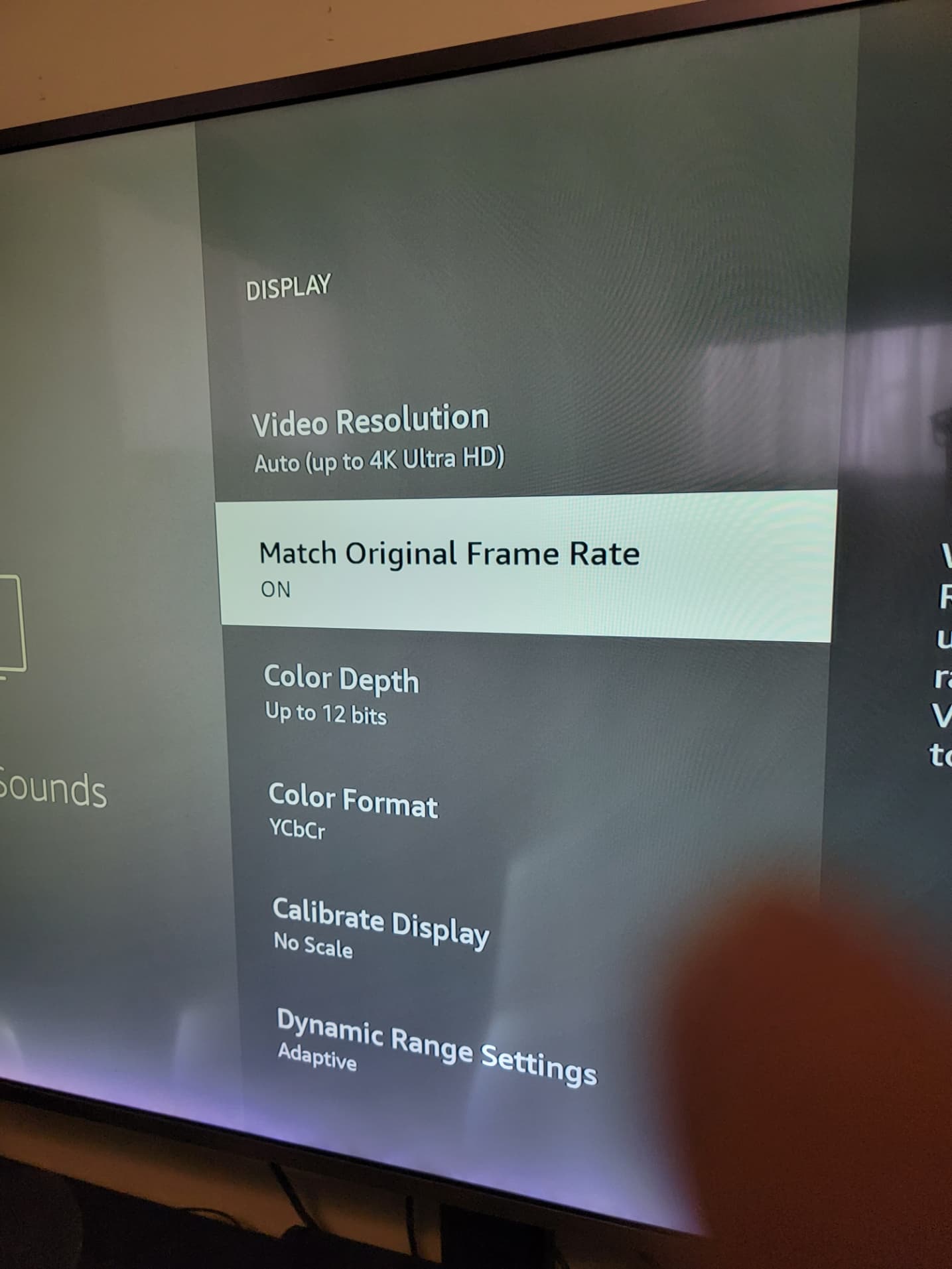

This really stinks for those of us that have the cube, although I can understand your frustration. My issue is with live sports on the firetv cube, here's my observation.
Using my hdhomerun, live sports on the Channels app "sometimes" is fine and "sometimes" is jerky as if the frame rate is forced low. Watching the same event and same hdhomerun using the Plex App works fine.
Live sports on Youtube TV on the cube is unwatchable with the same issue, jerky like it's at 30fps, but YoutubeTV on the chromecast w/google tv is fine.
Oddly enough Thursday Night Football on my FireTV Cube is unwatchable, but just fine on my chromecast, I mean seriously, it's their own hardware and software??
All apps work fine on a FireTV 4k stick, which was < 1/2 the price of the cube. I guess I'll just look to get rid of the cube as a solution.
