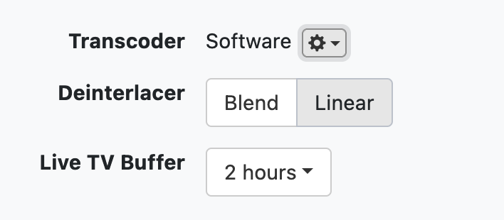

Channels DVR Raspberry Pi 4 - Lost Hardware Transcoding?
nvmpi
/mnt/data/channels-dvr/2023.08.09.2030/ffmpeg-dl: error while loading shared libraries: libnvmpi.so: cannot open shared object file: No such file or directory
exit status 127
v4l2m2m
[Parsed_color_0 @ 0xf5b3330] size:640x480 rate:25/1 duration:-1.000000 sar:1/1 Input #0, lavfi, from 'color=black:640x480': Duration: N/A, start: 0.000000, bitrate: N/A Stream #0:0: Video: rawvideo, 1 reference frame (I420 / 0x30323449), yuv420p, 640x480 [SAR 1:1 DAR 4:3], 25 tbr, 25 tbn, 25 tbc Stream mapping: Stream #0:0 -> #0:0 (rawvideo (native) -> h264 (h264_v4l2m2m)) Press [q] to stop, [?] for help [graph 0 input from stream 0:0 @ 0xf5def40] w:640 h:480 pixfmt:yuv420p tb:1/25 fr:25/1 sar:1/1 [h264_v4l2m2m @ 0xf5dc7a0] Could not find a valid device [h264_v4l2m2m @ 0xf5dc7a0] can't configure encoder Error initializing output stream 0:0 -- Error while opening encoder for output stream #0:0 - maybe incorrect parameters such as bit_rate, rate, width or height Conversion failed!
exit status 1
Yep, just checked mine, and I've also lost Hardware transcoding with the latest stable release, 2023.08.07.2138
Same here

This thread is specifically about hardware transcoding no longer being present on the Pi. Previous DVR releases had no problem, but the current stable release no longer works.
(Was a change to the bundled Ffmpeg made between releases? I, too, am affected by this, and no changes were made to the system other than an update to Channels.)
@Maddox
Can you submit diagnostics from your DVR?
Just submitted mine
and same here.

Can confirm that the latest Channels DVR pre-release fixes the transcoding issue on my rpi 4. I fully tested a remote transcode and it worked.
I, too, have regained hardware transcoding with 2023.08.15.0451.
