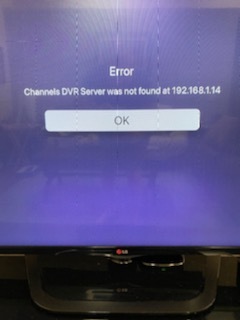

CHANNELS DVR Server address?
Link does NOT load from phone.
and I tried that IP a dozen times...but it looks like its almost loading then give this ERROR
IMG_3144
Okay then you need to find and disable the firewall on your Mac until the url loads
Please also click Help > Submit Diagnostics on the TV after seeing that error

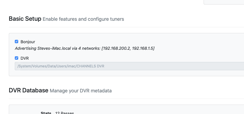

AGAIN, my Mac or ATV updated and I cannot for the life of me find the IP address of my Mac... PLEASE HELP... where exactly do I look?
Try http://192.168.200.2:8089

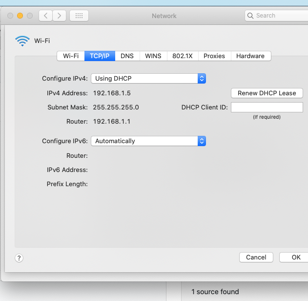

You can open Network Preferences on your mac and it shows your IP there.
or this?
Looks like it’s 192.168.1.5, based on that screenshot. If that’s your server setting a static IP will prevent it from changing. I would recommend doing that from your router, you can usually create a dhcp reservation so that it gets the same ip every time. Somewhat advanced.
Yes, those are the IPs.
So http://192.168.1.5:8089 will open the DVR web UI
Looks like previously it was 192.168.1.4. You can login to your router and setup a static dhcp reservation to ensure the IP doesn't keep changing.
