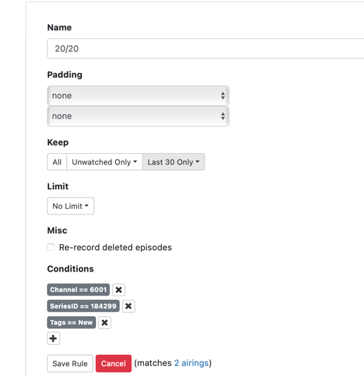

Yes, you can accomplish this on the Channels DVR webUI.
DVR > Passes > click the arrow at the right side of the pass, choose "Advanced."
Add a condition that says "Channel == x"
(where x is the specific CBS channel you want new recordings from)
Here's an example I'm using for 20/20:
