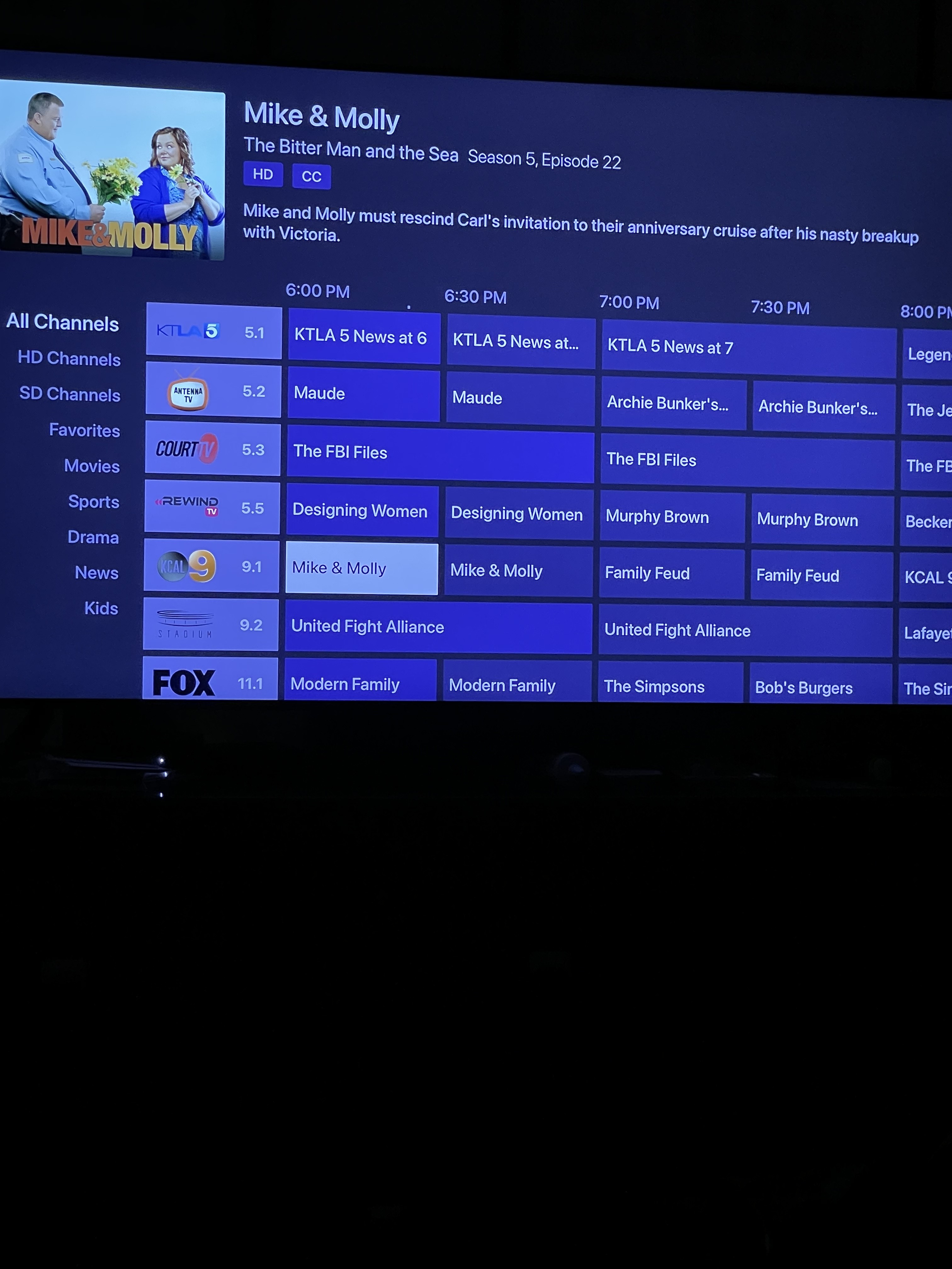

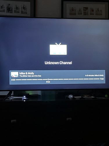

Am in Los Angeles area - I was getting Channel 9 and 11 - I had to rescan as I moved - I now see both of them in the guide with the correct listing of upcoming shows but when I go to the channel it says unknown channel - these are fairly typical channels normally and had them before

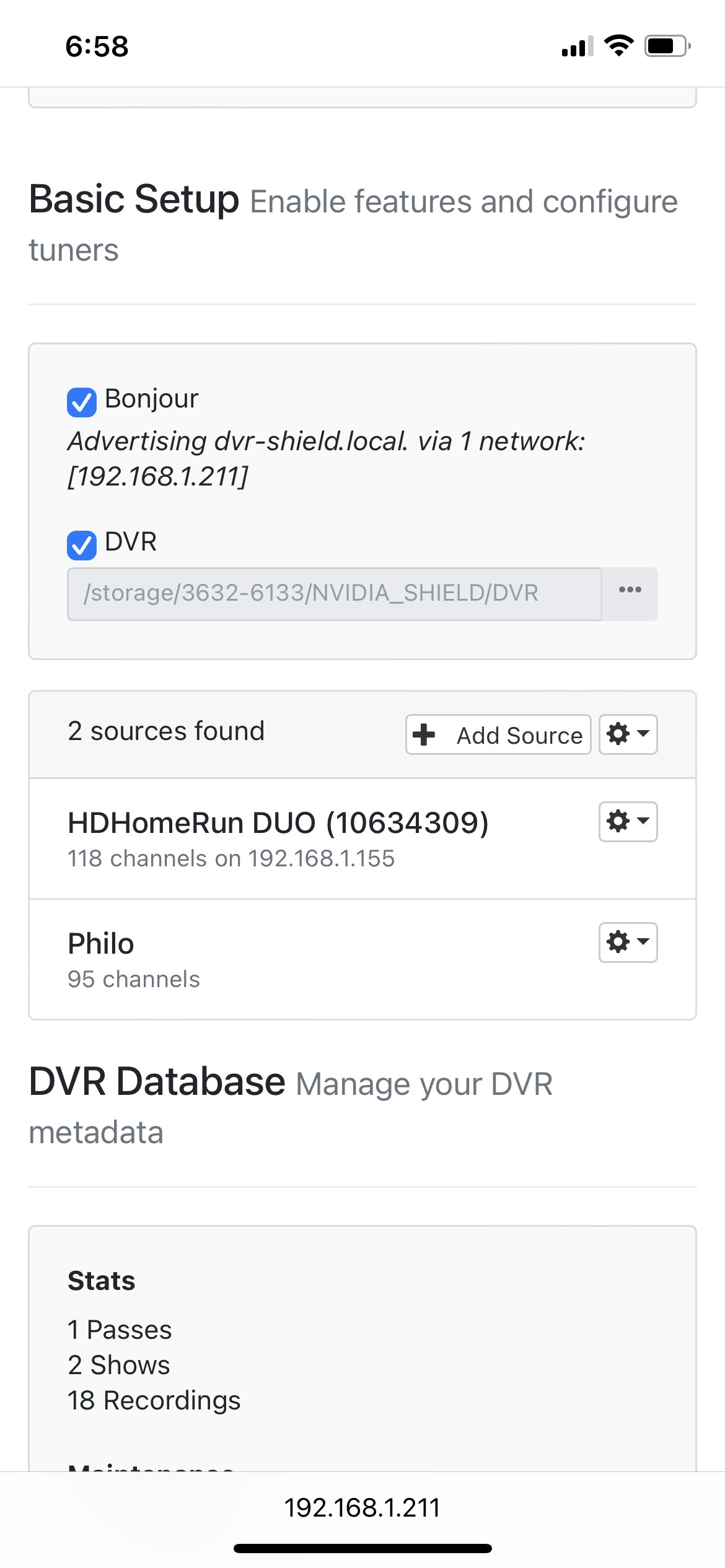

In the web ui under the HDHomeRun source do the channels show up in the channel list? Have you tried the “reload lineup”, “sync station mappings” and “redownload guide” options there?
In addition to what @Macnbaish said, if you moved from one zip code to another, you need to Remove Provider and pick it again using your new zip code.
I have done that a couple times
Same zip code but reloaded that as well - thank you both for thoughts

It seems weird - if I connect directly to tv without HD homerun - I get them. When I connect to HD homerun and Channels DVR ( have re sync’s, reloaded, all of those) it shows up on the guide and as noted the guide is correct but when I select the channel(s) it notes unknown channel with time bar across the bottom but will not play anything

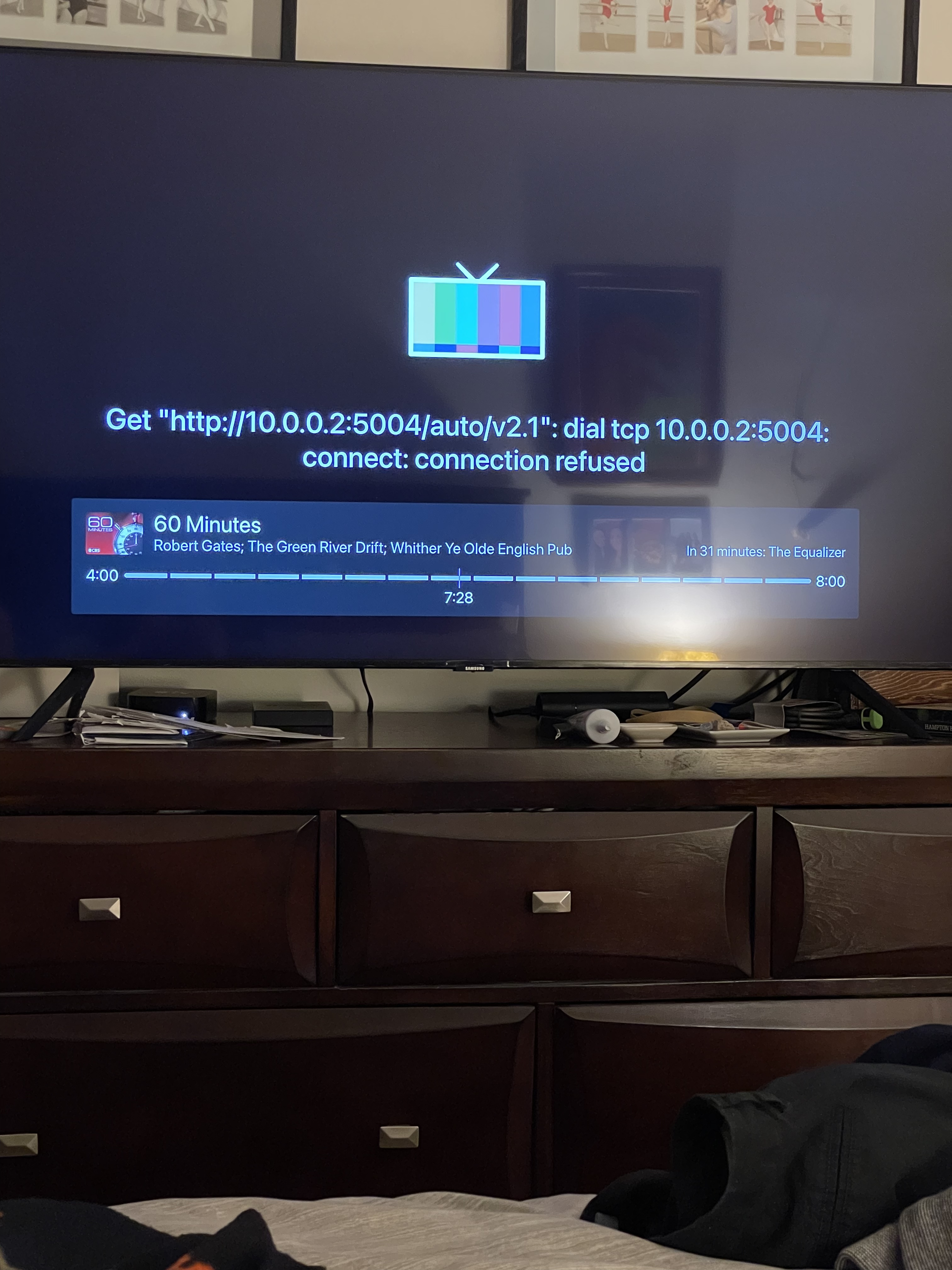

Thank you… got several cannot start logs… how do I post those
2021/10/17 18:29:51.252443 [ERR] Failed to start stream for ch11.1: HDHomeRun: Could not tune to http://192.168.1.155:5004/auto/v11.1 after 30s
2021/10/17 18:29:52.366416 [HLS] Couldn't generate stream playlist for ch11.1-dANY-ip192.168.1.53: HDHomeRun: Could not tune to http://192.168.1.155:5004/auto/v11.1 after 30s

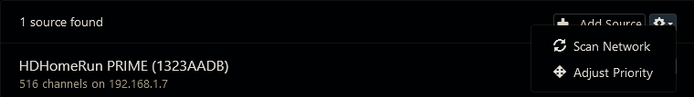

If that's not the IP address of your HDHR tuner, you need to click the gear dropdown and select Scan Network for Channels DVR to find it.

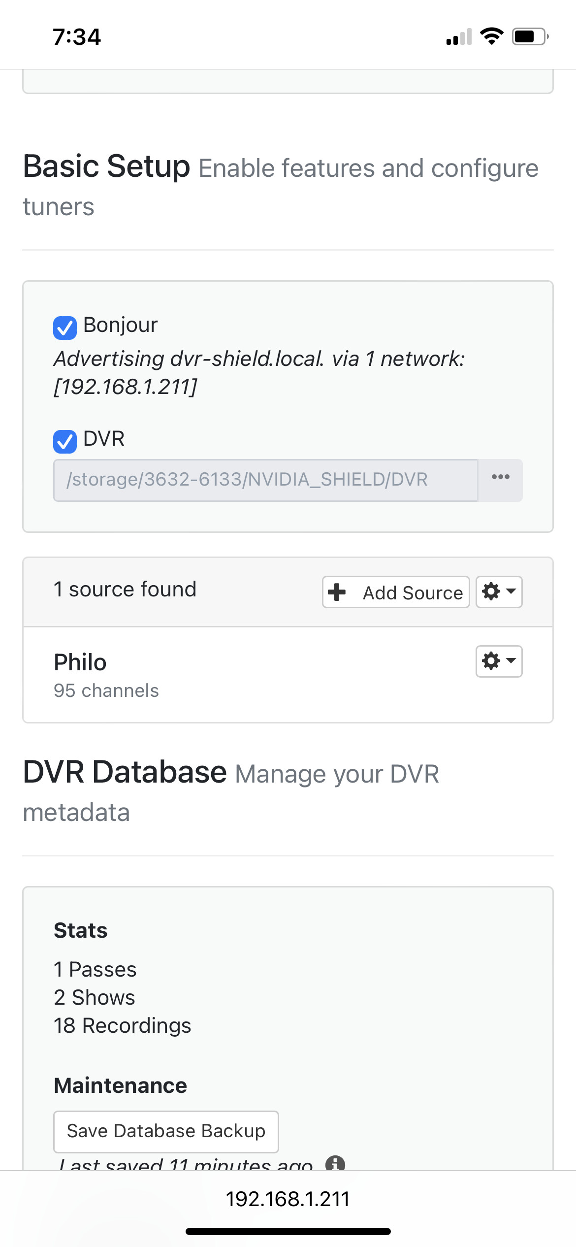

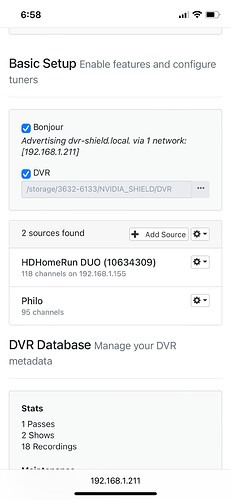

Well now it’s worse - the app sees the hdhr but when I go to the web UI it does not show the hdhr at all and now it has this error
Not sure what I did to mess this all up…. If I use the silicon dust app the channels come in fine ( well the ones that I have) with no errors like above….. there is something between the hdhr and dvr that is not talking anymore

Sorry to be ignorant and I know how frustrating this is for all - This set up worked before and now it does not - and as you can see it does not even see the hdhr - I tried clicking on hdhomerun.local and nothing came up - I am not trying to irritate- it was so easy to set up once and now it is difficult (and not sure why) is there another way to get the IP address -
