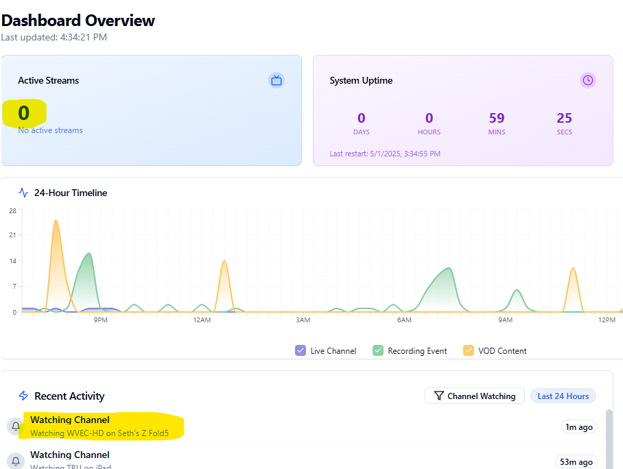

My Android phone has tuner sharing enabled and Channelwatch shows that I am watching a channel. Shouldn't the active streams increment as well?
Sometimes the counter of active streams can take between 10 seconds to 45 seconds after notifications, i suggest to refresh the page, if its a persistent issue - let me know.

Ive let it sit for about 45 min while i am watching an mlb game and active streams are still at 0
I never paid attention to that, but I think if you refresh the page it will be accurate.
I see the same issue with some of the CDVR web UI, have to refresh the page.

@slampman - To troubleshoot why your active streams counter stays at 0 even while you're watching MLB content, I'll need to see what's happening behind the scenes. Could you please share:
  1. Container logs: Run this command and share the output:
    docker logs channelwatch
  2. Event stream data: While you're watching your MLB game, run this in another terminal window and capture about 30 seconds of output:
    curl -H "Accept: text/event-stream" http://your-server-ip:8089/dvr/events/subscribe

Still happening with v0.7 watching VOD
Maybe can test this weekend with LiveTV.

New bnhf/olivetin:latest (aka bnhf/olivetin:2025.05.02) pushed today that transitions ChannelWatch from an OliveTin Action, to a stack you can deploy via Project One-Click. This makes more sense now that it has its own WebUI:
screenshot-htpc6-2025_05_02-08_36_10
If you've been using ChannelWatch via the Action, the best approach is to kill it by using a log_level of 0 in the Action. Then in the Project One-Click Delete a Project One-Click Channels DVR Extension Action choose ChannelWatch and click Start. This will delete the current ChannelWatch image, and clear the decks for a fresh start:
Then, you can proceed with deploying ChannelWatch via Project One-Click. If you're an Apple or Synology user, keep in mind your HOST_DIR value cannot be /data, but needs to be a parent directory you can write to.
In the case of Apple, this is usually /Users/<your username>, the channelwatch subdirectory will be added automatically to the parent you specify. For Synology, /volume1/docker is the usual choice, and again a channelwatch subdirectory will be added automatically to that parent. As always, on Synology, that directory /volume1/docker/channelwatch needs to exist before you attempt to deploy the stack.
So it looks the same no matter which channel I watch live, whether from On Now or the grid guide.
One server

Just to clarify no live stream is detected for me (with tuner sharing on or watching TVE etc)
Not really sure what to make of this, but it looks like ChannelWatch sent something like 2000 notifications yesterday via Pushover. I received 100+ of them in very rapid succession on my phone, before I shut the container down.
I'm somewhat reluctant to fire it back up again, as one could burn through the 10K messages per month allowed in a big hurry. You can see my typical daily rate here, followed by a huge spike yesterday:
Nothing in the Channels DVR logs looks particularly unusual.
Regardless of the cause, I'd suggest ChannelWatch needs some safeguards to prevent a runaway train scenario like this from ever happening.
